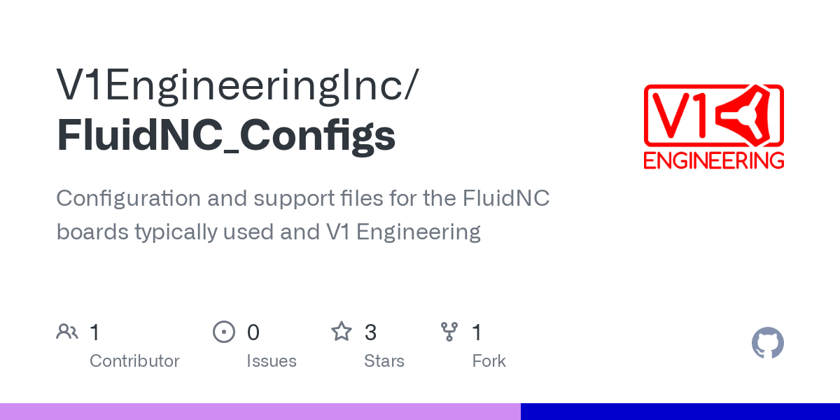

Go to the web UI by it’s IP address, then put known good configuration back into it (Use the V1 engineering default config files)
Here’s where the config and macros are at the V1 github:
If that still doesn’t resurrect it, then you’re going to have to follow instructions to load firmware with either the FluidNC web installer as mentioned above, or using FluidTerm to load firmware from the FluidNC github repository.
