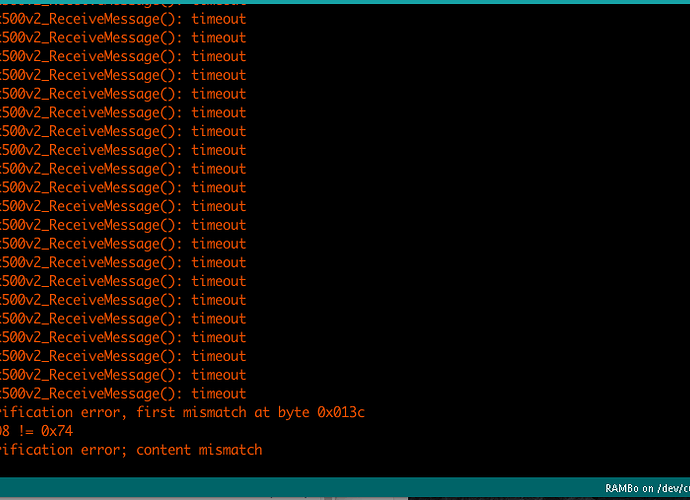

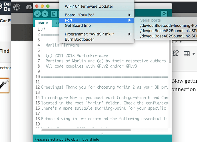

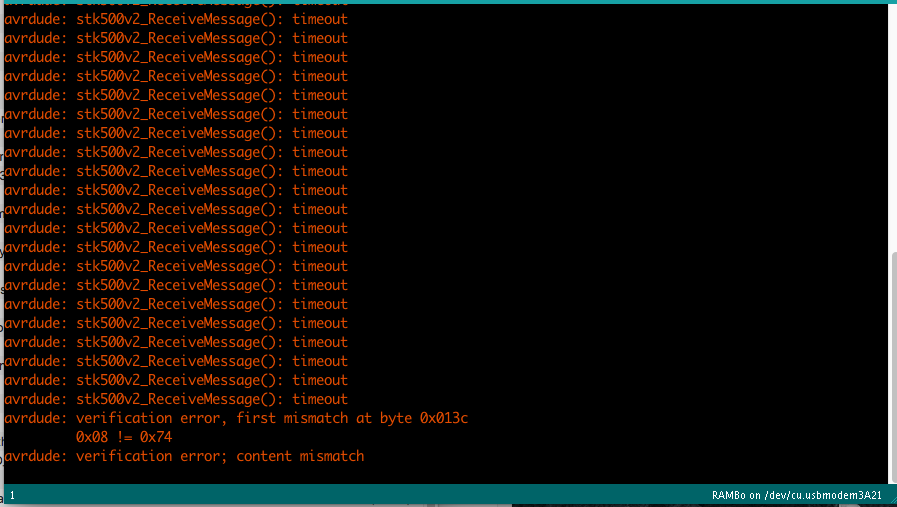

Tried to upload Ryan’s Dual Endstop firmware last night, no go. Repeated attempts failed. “avrdude: stk500v2_ReceiveMessage(): timeout” occurs a bunch of times then:
“avrdude: stk500v2_getsync(): timeout communicating with programmer”

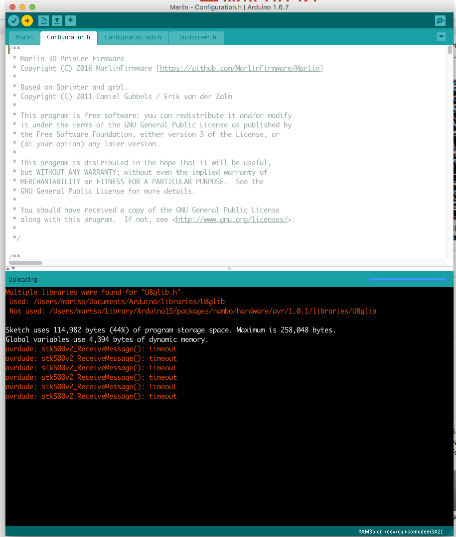

Included are 2 screenshots. I even attempted to use Arduino 1.6.7 with the same results. I really purchased this for dual ES use so it’s kind of critical that I get this upload working. Any tips appreciated!
Mac OS 10.11.6; 24 Gb Ram
Arduino 1.8.5 AND 1.6.7 tested. Included U8glib and board is visible in the Serial monitor and responds.

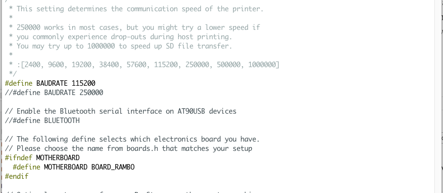

Also changed the Baud rate in configuration.h to 115,200.

That is a generic message for “not connected” yes is will appear very common.
You should look at all the instructions including for the beta builds. Three issues, number one, your arduino is entirely too old. You do not say what firmware you are trying to use but there are very specific instructions for marlin 2.0 (arduino hourly). Two, you are on a MAC, some can not handle the baud rate we use and you will need to turn it down, if it is very old you should note that here. I will find the old MAC instructions. Three, did you do the two library adds to arduino?
https://www.v1engineering.com/marlin-firmware/
I can see in the screen shots you are on Marlin 2, so then you need the current hourly build and change the temp folder.
Arduino 1.6 does not work for any version of marlin anymore.
I started out using Arduino 1.8.5, only tried the 1.6.7 as a test this AM.
Mac is 2009 version but all up to date. I’m using the front USB port; the front ports are USB 2.0. I changed the baud rate in the sketch to 115200 and commented out the previous 250000 command.
I added the two libraries, yes.
1.8.5 nightly still shows the exact same error?

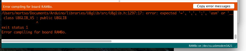

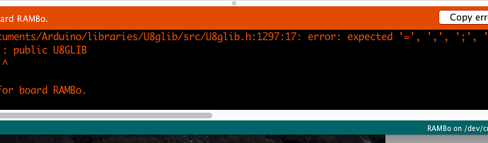

OK… complete meltdown. Downloaded the Hourly Build for OSX. Re-did all the steps, making sure to have the correct drivers. now it just completely fails on all counts, can’t even compile the file. This message appears about a zillion times before the failed message “/Users/mortso/Documents/Arduino/libraries/U8glib/src/U8glib.h:1278:1: error: unknown type name ‘class’
class U8GLIB_SSD1351_128X128GH_4X_HICOLOR : public U8GLIB
I do not know how to change the temp folder on a Mac. It not listed in the prefs file.
It might not be an issue on a MAC what is the error message?

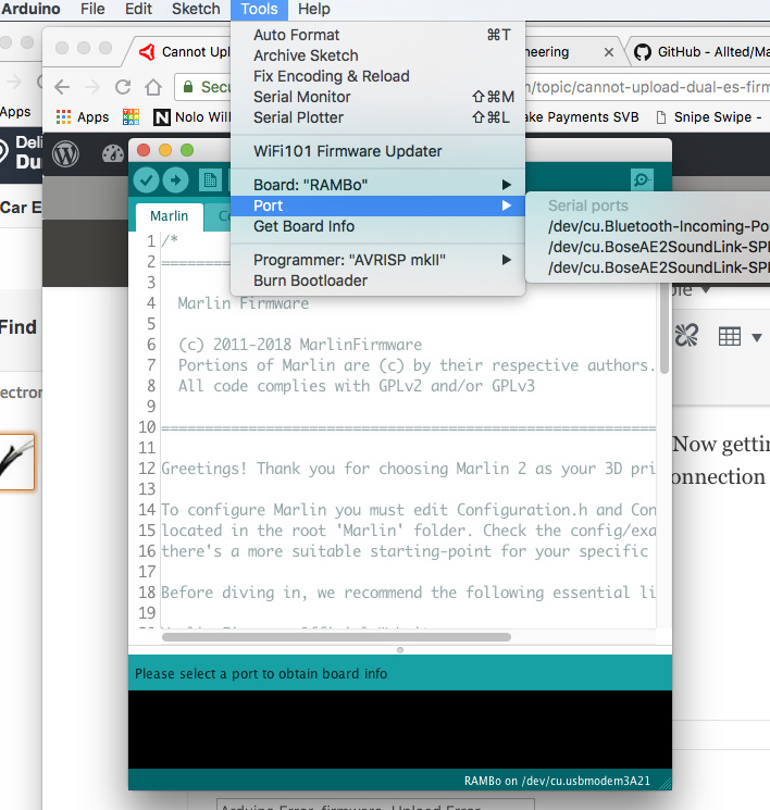

OK well, that’s it. TOAST. BRICKED BOARD. Now getting heartbeat blink yellow light next to green ON light. No more connection to Arduino. Hours of frustration and now this. The board now doesn’t even register on the PORTS list. I ALSO tried an XP computer all Arduino updates, could not see the port COM 1.

You should not have been able to actually brick the board without some serious effort, or external damage. Nothing you could have done over usb could have damaged it. Are you sure your power supply is working, and that you haven’t blown a fuse somehow? You were powering it during flashing correct?

  5. At least 3 separate posts suggested pressing reset as the app is trying to load the firmware, so I did. I pressed it 3 times as the error message kept scrolling on the computer screen. (My better judgement was told to shut up and be quiet)
    Lights near the USB port began blinking in a heartbeat fashion, board no longer visible to the Arduino Serial Monitor.
Tried shutting it off, disconnect USB and all Power, nothing worked. I bricked it.

Send it. I have never flashed a bootloader and am not convinced that is actually the issue. If it is I have hundreds of arduion’s to flash with (it doesn’t have to be a tiny). I have a know good system. I am honestly more worried about physical damage, the only way you should have been able to mess up the bootloader is if it was actually flashing and you interrupted it at the exact right moment, or physically damaging it. Sounds like you were never actually connected, just recognized the com port.
