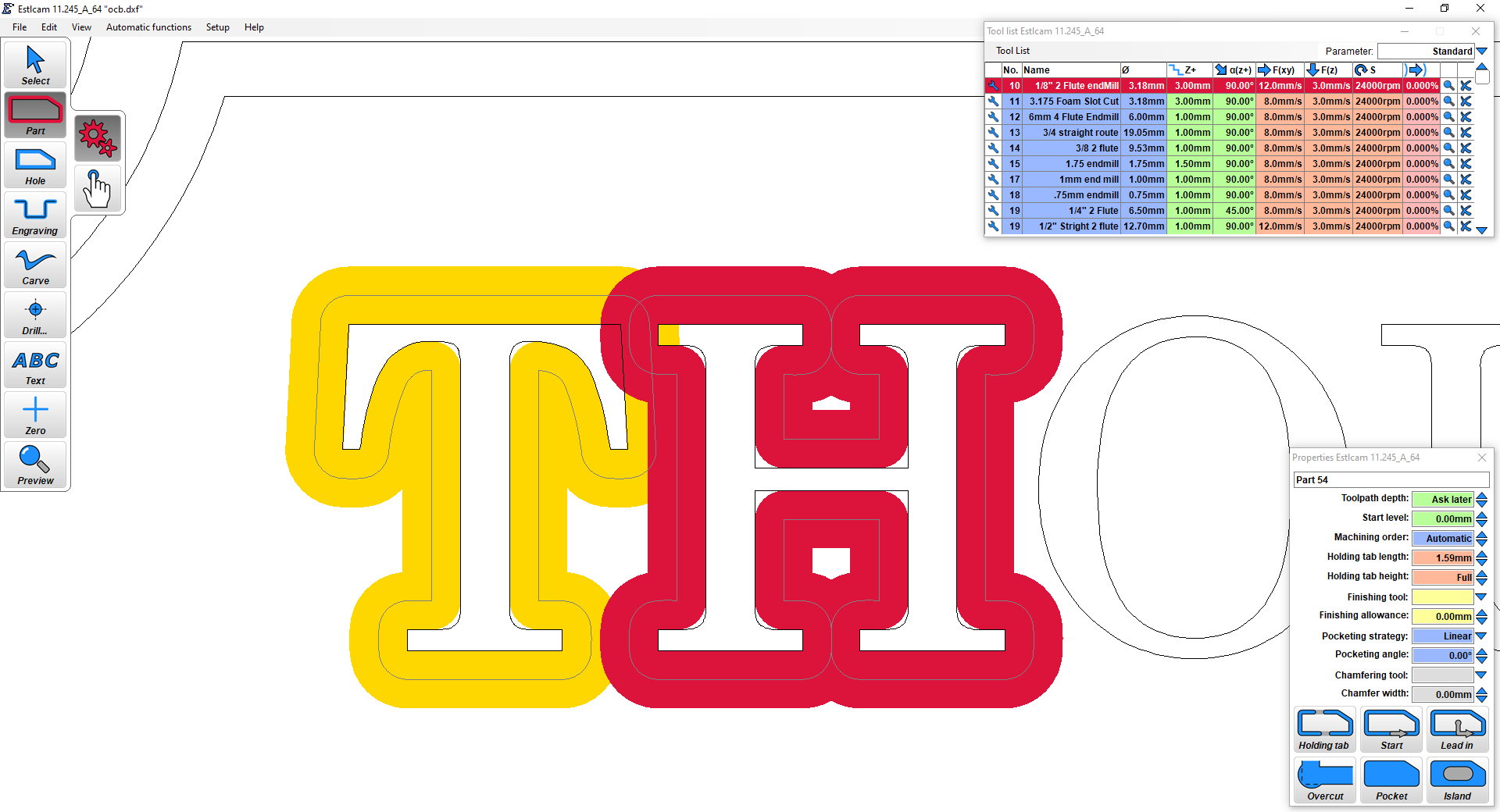

Can you prevent Part toolpaths overlapping in Estlcam?
I want to carve a sign where the text is proud of the background.
Is there any way of making part toolpaths repect the boundaries of different parts so I can use one but to rough out and then a smalleer bit to do the small areas only.
Heres an example - see how the toolpath for H cuts into the T and vice versa?
When you then do a Hole - Island operation it removes all the part toolpaths but the overlap remains
I’m using v11 but v12 is the same. Any ideas?

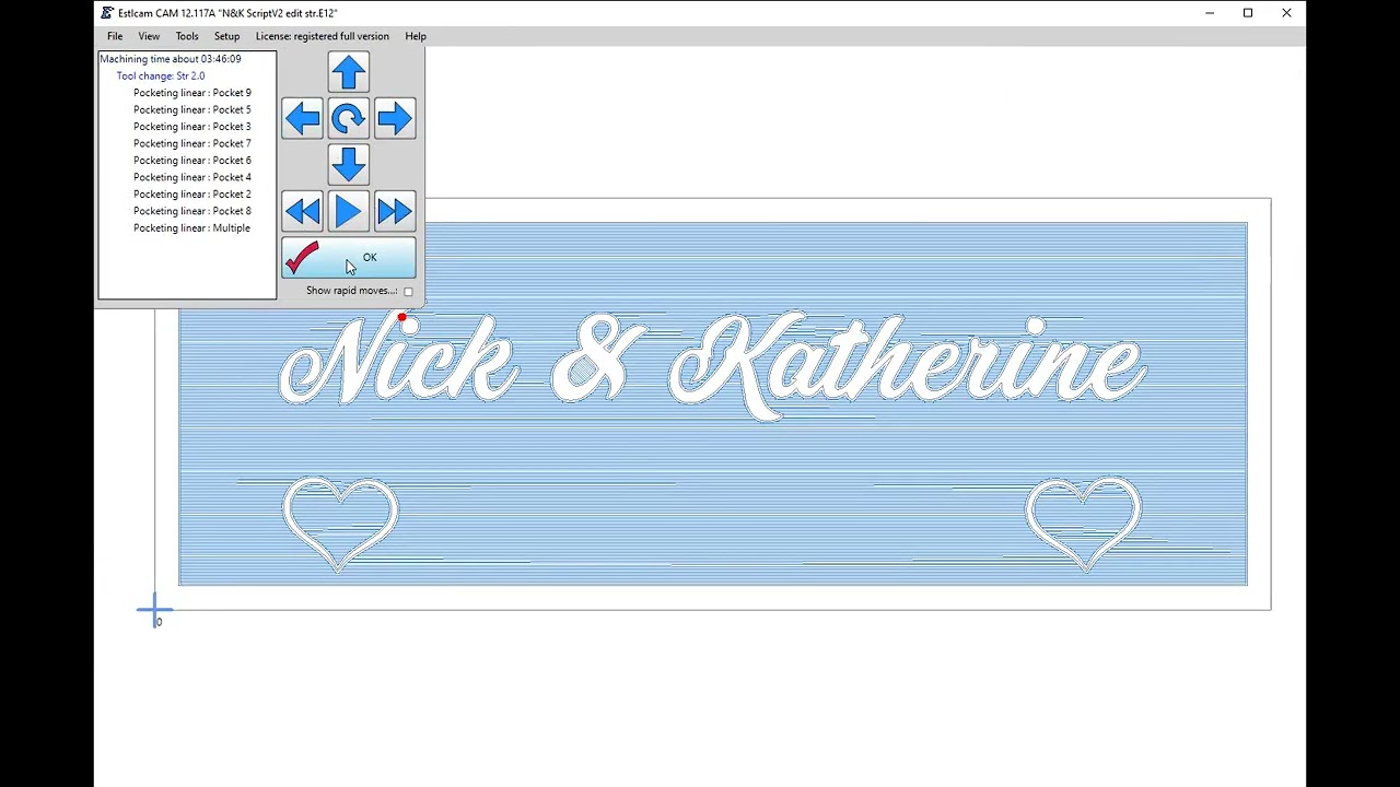

Your primary tool has to fit between all the lines, e.g. it looks like a 1.5mm tool would work. With v12 you can add a pocketing tool in path properties. The pocketing tool will cut what it can and then the primary tool will cut whatever is left. See also: Stacked Text Attempt - Help With Island and Multiple Tools

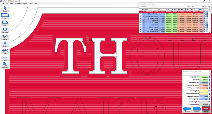

I’m trying to do it with 2 toolpaths, one using a larger bit to remove the bulk of the material and then a second toolpath using a smaller bit to only pick out the lettering.
You might be able to do that with a carve as well and just select your smaller tool as the carving tool. Let me try… :smiley:
Then how do you do the pocketing with a bigger tool?

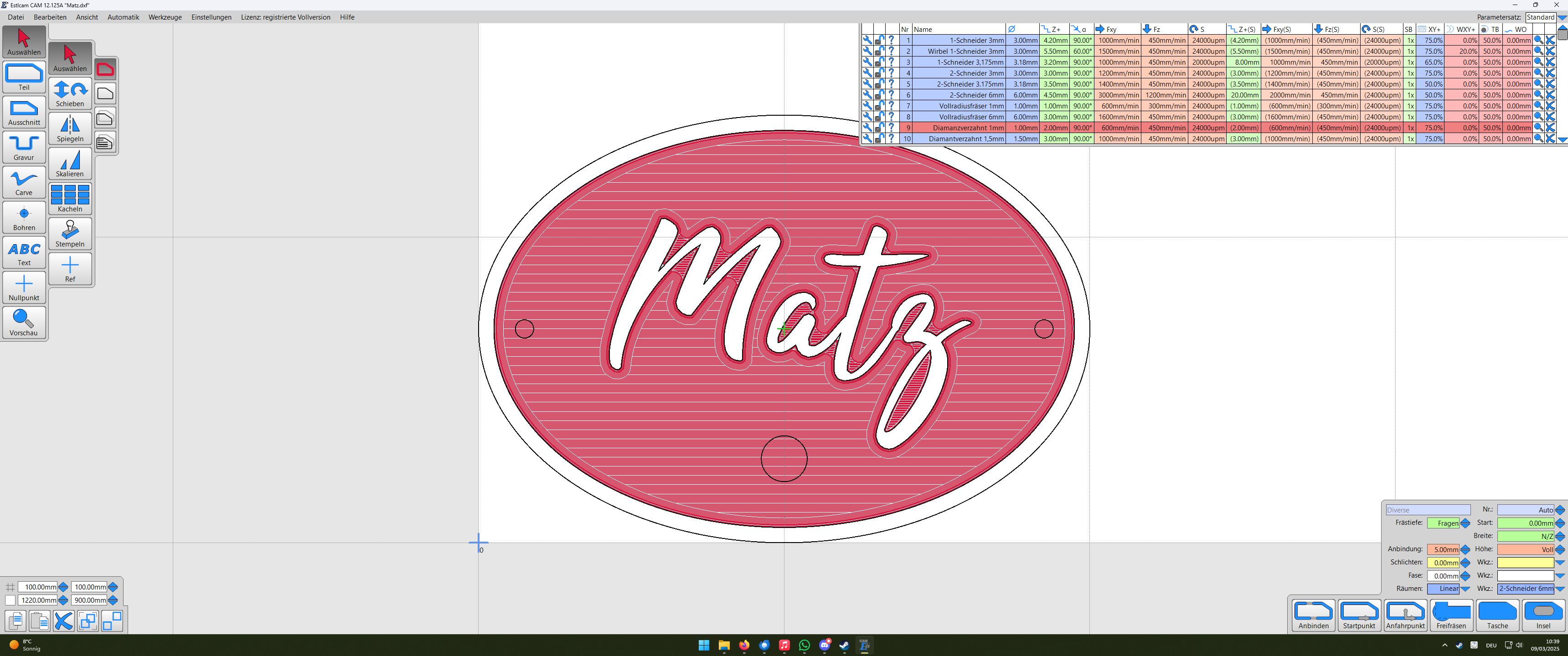

At the bottom right in the box you choose a clearing tool (blue field). It does throw an error with the flat tool on carving, but you might be able to cheat it by setting the angle to 179° or sth like that. :smiley:

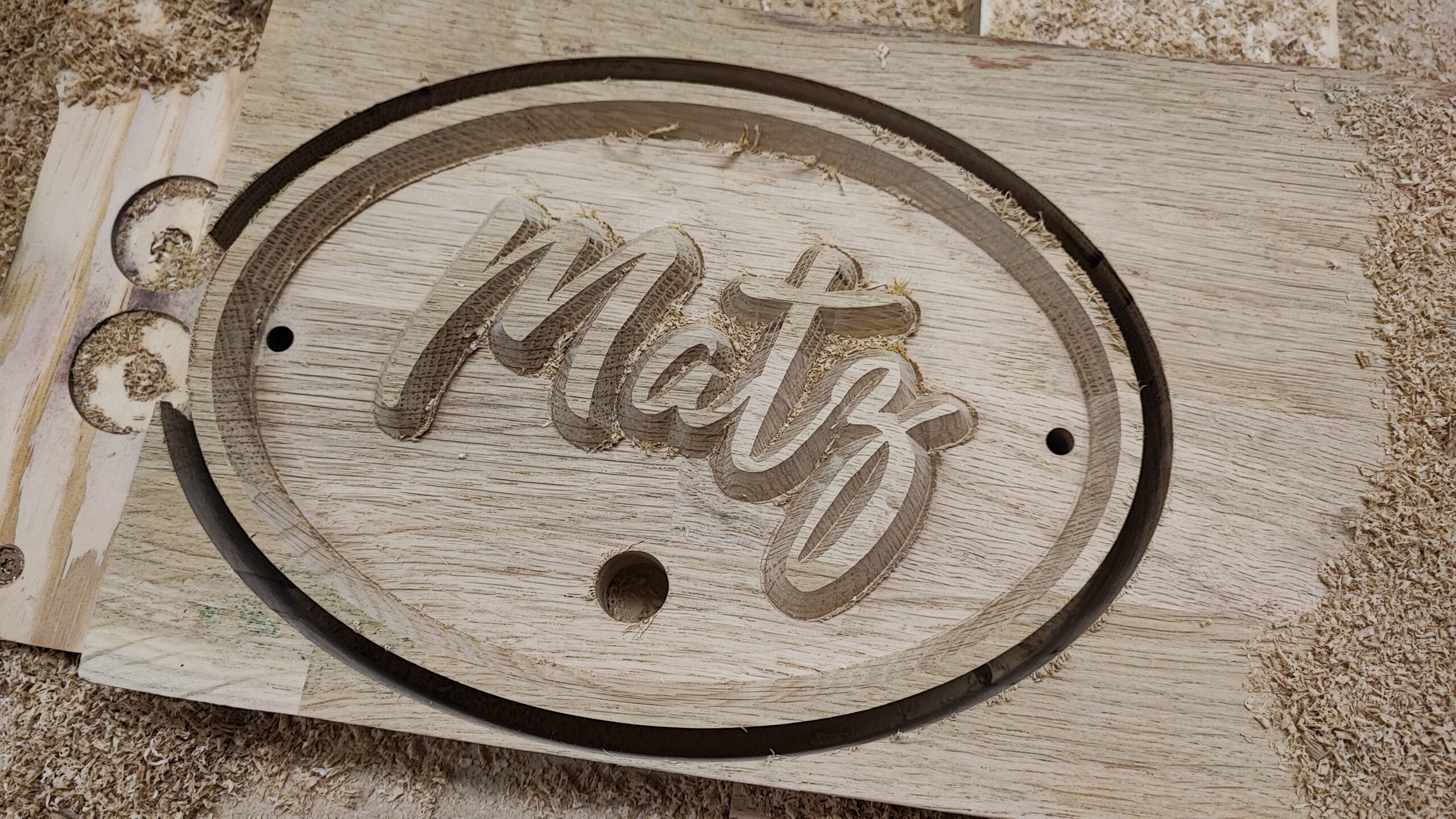

It also works with an island. I chose a 1mm endmill as the tool and programmed the cuts, then I chose Island and then put my 6mm endmill as the clearing tool (blue box bottom right). You can easily see it swap the tools.
Eureka! Thanks Phillipp
