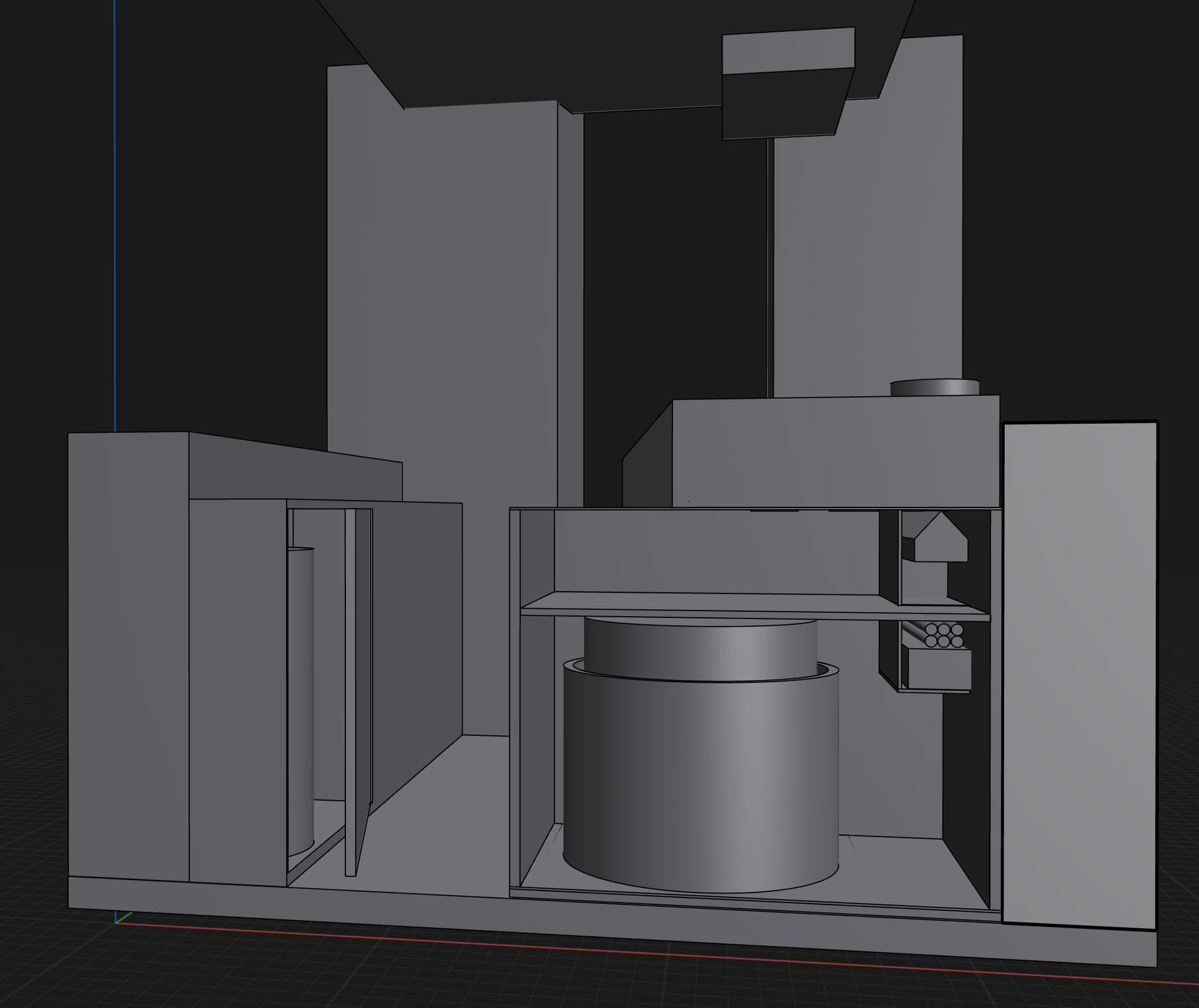

I am 90% done on my first build. Its a unit for the rear of my camper van to keep things organised. The reasons I build this were:
  • the garage area turned into a dumping ground. Everything everywhere.
  • it was hard to get the long items back into the van.
  • something to keep me entertained
My initial diagram looked like:
This is the unit in the van with the key equipment in it.
This shows the tunnel areas. I wanted this high so a folded bike’s wheel could go in the mid section.
I originally planed to make this my hand but got pointed in the direction of CNC and the rest is history.
One of the first issues I was the tool I used I could not export the sketches. So I switched over to onshape. Given I was using a CNC I went for a curved mid section.
To the left there is a sub unit that conveniently due to the tunnel was the shape of a step.
There is a lowering bed so doubles as stairs to the bed:
Another angle of the design with some bits missing:

Lessons learnt:
  • I didnt fully tighten the y belts. So what I thought was a size was off my 4-5mm. I tightened mid build and caused my self a lot of pain! Bits are off my a couple mm here of there so I needed to sand
  • Why did I start with something so complex! I needed this done my the start of the season. If made it very hard.
The good news is unit fits perfectly and my stuff fits in perfectly. I am so happy.
Its really beed good fun and I’m looking forward to easier projects now!
Thanks to every one who helped my on the journey. It would have been impossible with out you all.
Self praise is no praise etc but coming from a non wood working background. No clue of 3d printing, cad, cam, cnc’s etc. I think I’ve done pretty well! It’s been an experience since January learning all the tools, software, limitations, where it excels. Once I have the step and lids built I’ll take a little break then start building some stuff for the house!
