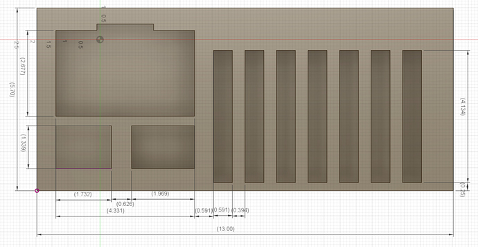

I was trying to get a dxf export of a part with dimensions to give to a friend. Looks like F360 doesn’t include dimensions when you export dxf.
I ended up just screen grabbing the drawing from F360 and sending him a png.
Kinda odd, I guess I need to learn how to work with dimensions in a vector program. I have always used offset lines and center lines but dimensions always seem super wonky. I spent about an hour in CAD, oddly enough most of that was dealing with importing and moving vector logos around. Then I spent several hours trying to Get the CAD back to the Vector. It sucks because it is sooooo close. I have nodes I can move and they are all in the right place. I can stroke and un-stroke them, but they are not connected so no fill. There is no selecting all and fusing overlapping points. The CAD export has "fuse points within X distance, and make poly lines but inkscape chokes if you use that.
I think my statement was confusing…
What I meant was, exporting the dxf didn’t include the visual text of the dimensions in it. Just the lines of the part.
Like this:
Yeah to include the dims you need to make a drawing and from there you can export your drawing as a PDF if you want them. Best you can get with a DXF is some center lines I believe.
Oh. Nice. I didn’t have time to mess with it the other day, so ended up doing the screen grab. I’ll have to play with the drawing stuff.
Drawing are an art form I used to thoroughly enjoy. You can be as detailed and organized as you want…pretty cool.
I’ve done a ton of them in autocad and inventor. Just haven’t looked for it in F360 yet.
