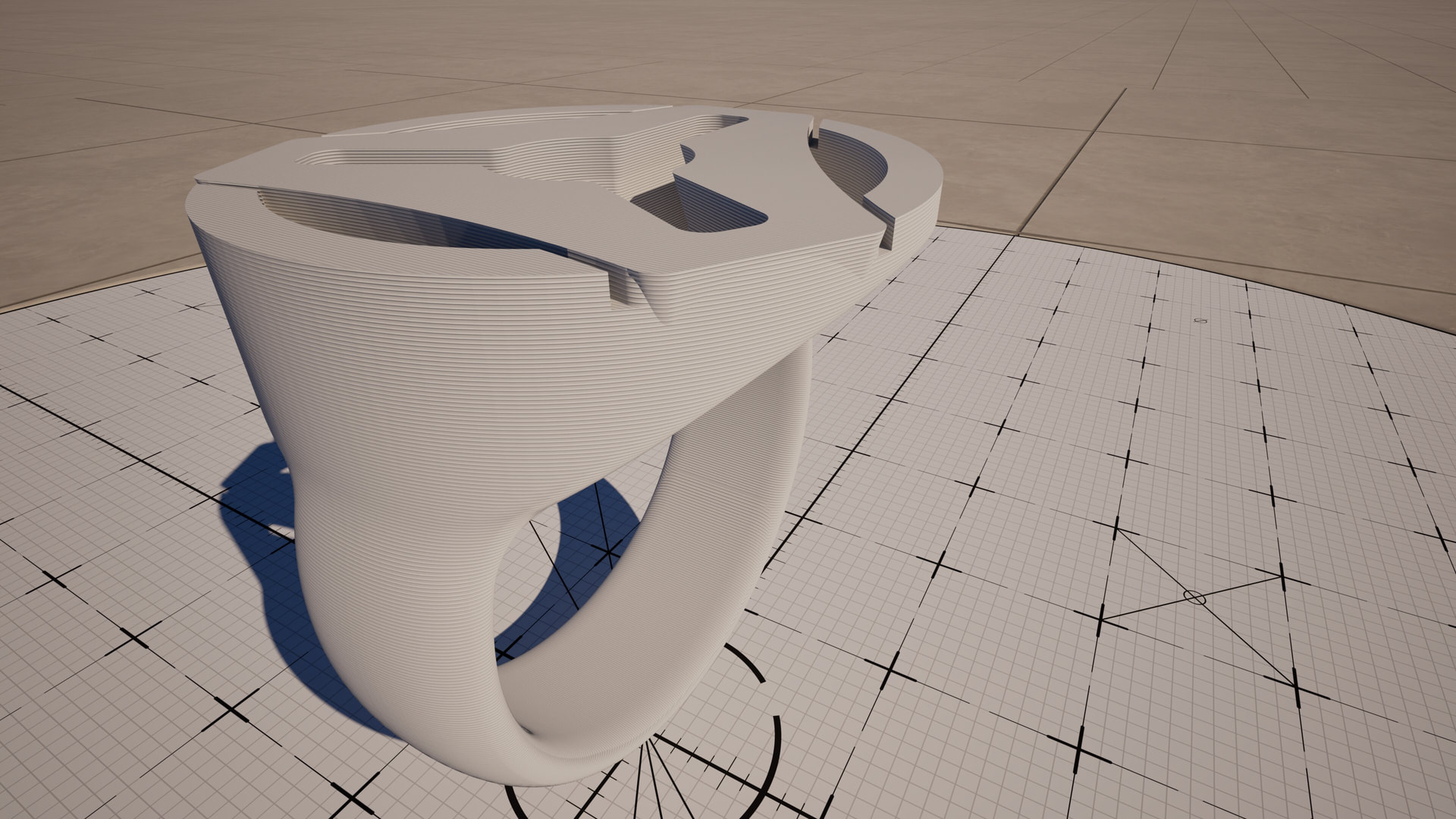

This was after about 10-15 minutes in twinmotion. Free for biz under $1M gross profits, and pretty easy. I think with a little tweaking on it I can get pretty decent results.

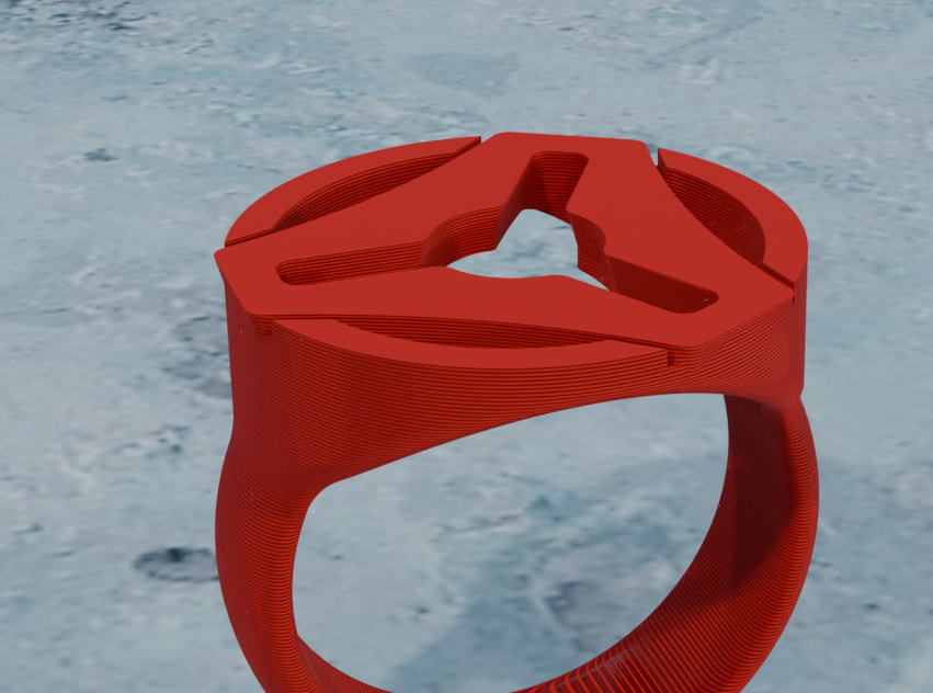

I spent another hour last night actually trying to get this same image and getting frustrated in blender. I got the texture on it, but it mapped funny and I could not figure out how to rotate it or move the camera.

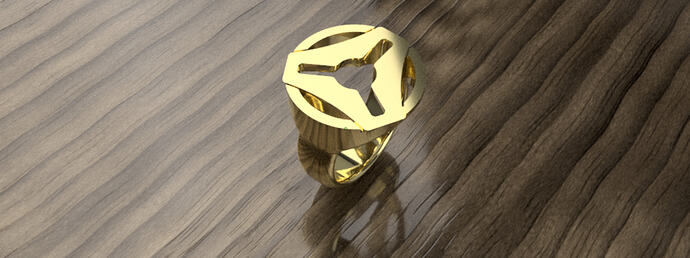

There is also light trace render, $11/month and they are fine with a on off use basis, or like $180 for lifetime. It looks pretty good as well. I might give that a shot later today. It actually looks like it might be a little better suited for CAD renders…not sure that is just a guess.
light tracer might be a bit too limited, great for quick stuff though!

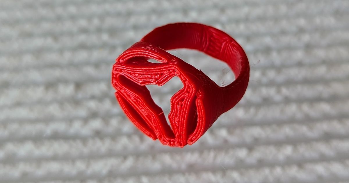

I came across some blender plug ins…these could be super cool, actual gcode renders. too much work for an assembly I would guess but you would get extremely near perfect renders. https://superhivemarket.com/products/stitch3r, https://superhivemarket.com/products/3d-printed-shader
Interesting what is it? A ring? :smiley:

At first glance twin motion seems the best option right now. lighttracer seems to wrap texture in an odd way, unless I am doing something wrong (probably doing something wrong).

Dam you are fast…and the texture is wrapped better.
I will try building my scene and opening it in blender to see if I can do that linear wrap.
okay, onshape gltf exports seems to be great in blender, brings over a lot of info.
Mike, what texture / map did you use for that ring? built in or part of a pack?.
Very cool. I hesitated to guess a ring and thought crap I bet it something EVERYONE knows and feared not a ring :upside_down_face:
