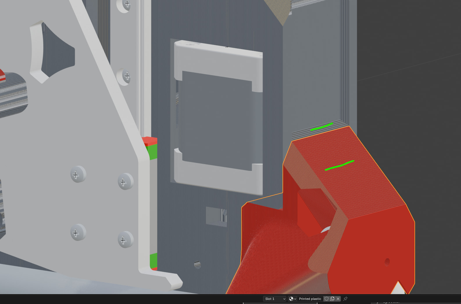

you mean to get your layer lines to be different orientations on different objects?
Yeah. I can rotate and scale them. make copies of the texture and add it to different parts, and change the color but if I rotate them they all rotate.
if you rotate a texture all of the textures rotate?
Or you talking about the geometry?
hard to explain
they are named different things, I can change color and scale independently, just not rotation. I am guessing color and scale are on the first setting page and rotation is three clicks deep.

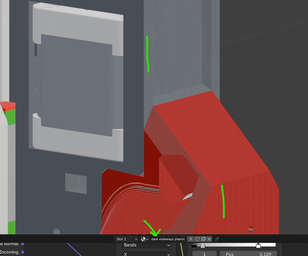

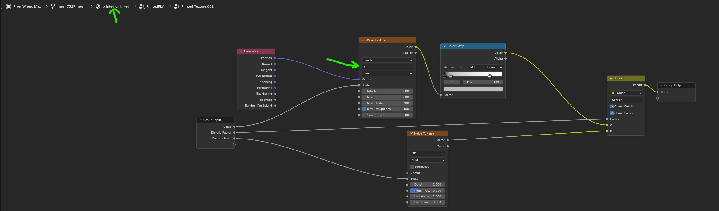

for this texture, I copied it, made a new one, unlinked it, single user. that all seems to work for the surface level controls, but the one to rotate is three levels deep. That is what I am trying to show with this screenshot. green arrow is the texture, rotate is two clicks deeper. The texture creator says in the description this is how to rotate it.
I tried copying and duplicating that module(?) reconnecting, still changed them all.
I feel like I am doing all the right things for other textures but something about how this one is made is not doing what any of the google searches say.
my next hope is maybe to add a surface level rotate instead of the bands XYZ thing. or just find a different texture.
wait, I got it somehow.
My goodness that was nuts.

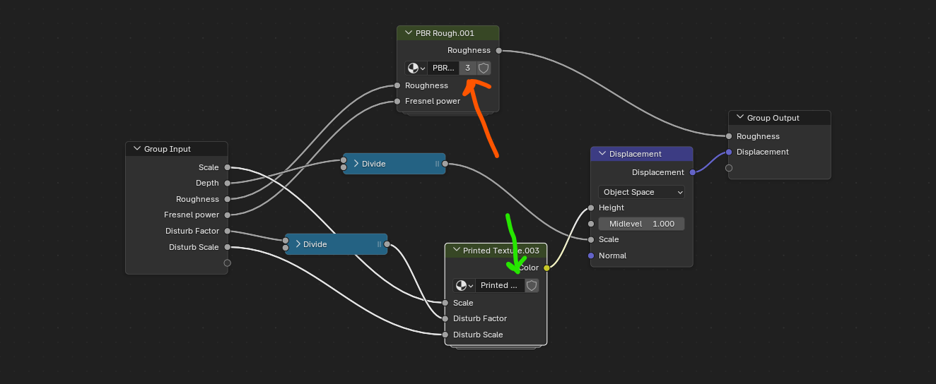

so the green arrow used to have a linked number here like the orange one.
I had to go through all my copied…and unlinked… materials and clear out the links in this section. I kinda understand why, but if you copy a material I really think the default should be unlinked everything and if you need something linked you go in and add it. But that is coming from someone with zero blender experience.

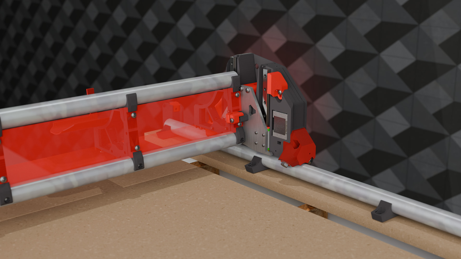

Finallyyyyyyy getting somewhere.
If anyone wants to play with this file, I think I can share it.

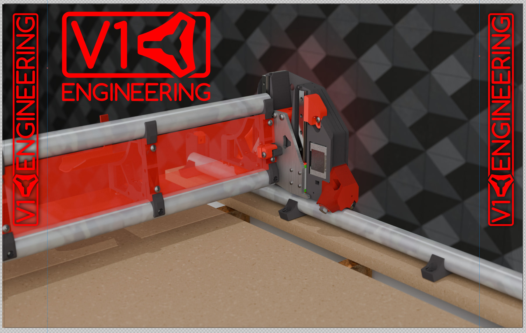

Now I think I need to get in and tweak each texture to make them look more real but it is the best I have gotten in blender to date.
Pretty fun for a backdrop. I can see now I need to rotate it a bit more so there is more LR and less table but Peter I really like it.
Any suggestions?
Are you using EEVEE or Cycles?
I can’t tell for sure on my phone, but looks like EEVEE.
If you want realism, switch to Cycles
Once you do, the lighting will probably look dim.
You’ll need better lighting for cycles, but you’ll get realistic textures, shadows, light bounces, etc
There’s an add in somewhere that can get you single click 3-point lighting.
cycles, gpu only, optix, vulkan. on a rtx 3060 ti
I made my own funky lighting so that could be it.
