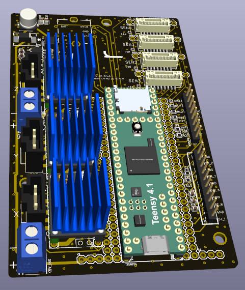

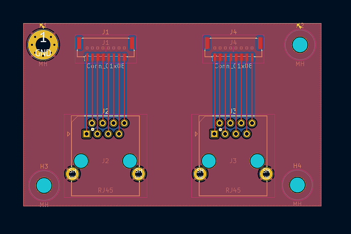

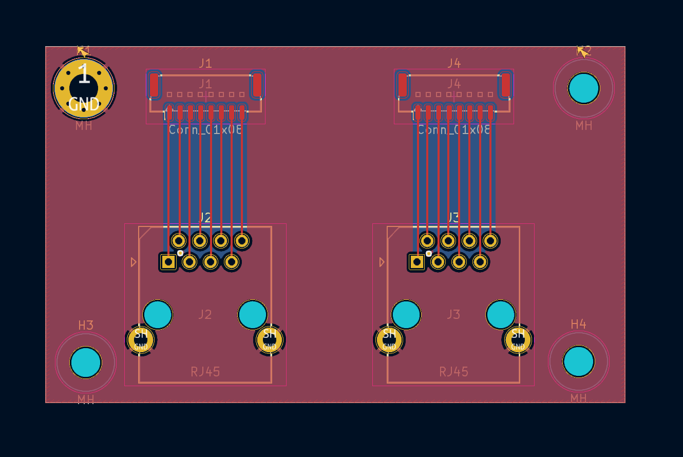

Taking this opportunity to get familiar with KiCad. This is pretty much all we need, right?
Yep, that’s the one. Ethernet patch cables are 1:1 pinned, just with a weird pinout for pairs vs pin number. You don’t have any pairs and won’t be testing for impedance/reflections/whatever so it just needs to be continuous and correctly pinned. Depending on MOQ you could also make it a single smaller board that handles just one end, that way if you only need 1 or 2 sets, getting a MOQ of 10 boards would give you 5 sets.
I also don’t worry about thermal reliefs anymore, personally. All my stuff is high-current and direct connected and we don’t see soldering issues anymore. I’d also add those mounting tabs on J1 and J4 to the ground plane without thermal reliefs for strength. Is there a PTH version of that J1/J4 header? If so, you might want to use that instead as it’s going to be going through hundreds/thousands of mate/unmate cycles. That said, it’s cheap enough that if you’ve got spares or need another it’s no drama. Alternatively, you could specify adding some epoxy/hot glue to the header to help with a bit more stability.
I’d also beef up those traces for strength. Make them the same thickness as the SMT pads and then neck them the minimum amount to get through the pads.
Great tips.
Unfortunately not. It seems like JST only makes an SMD version. I’ll beef it up by removing the thermals and adding structural vias as suggested.

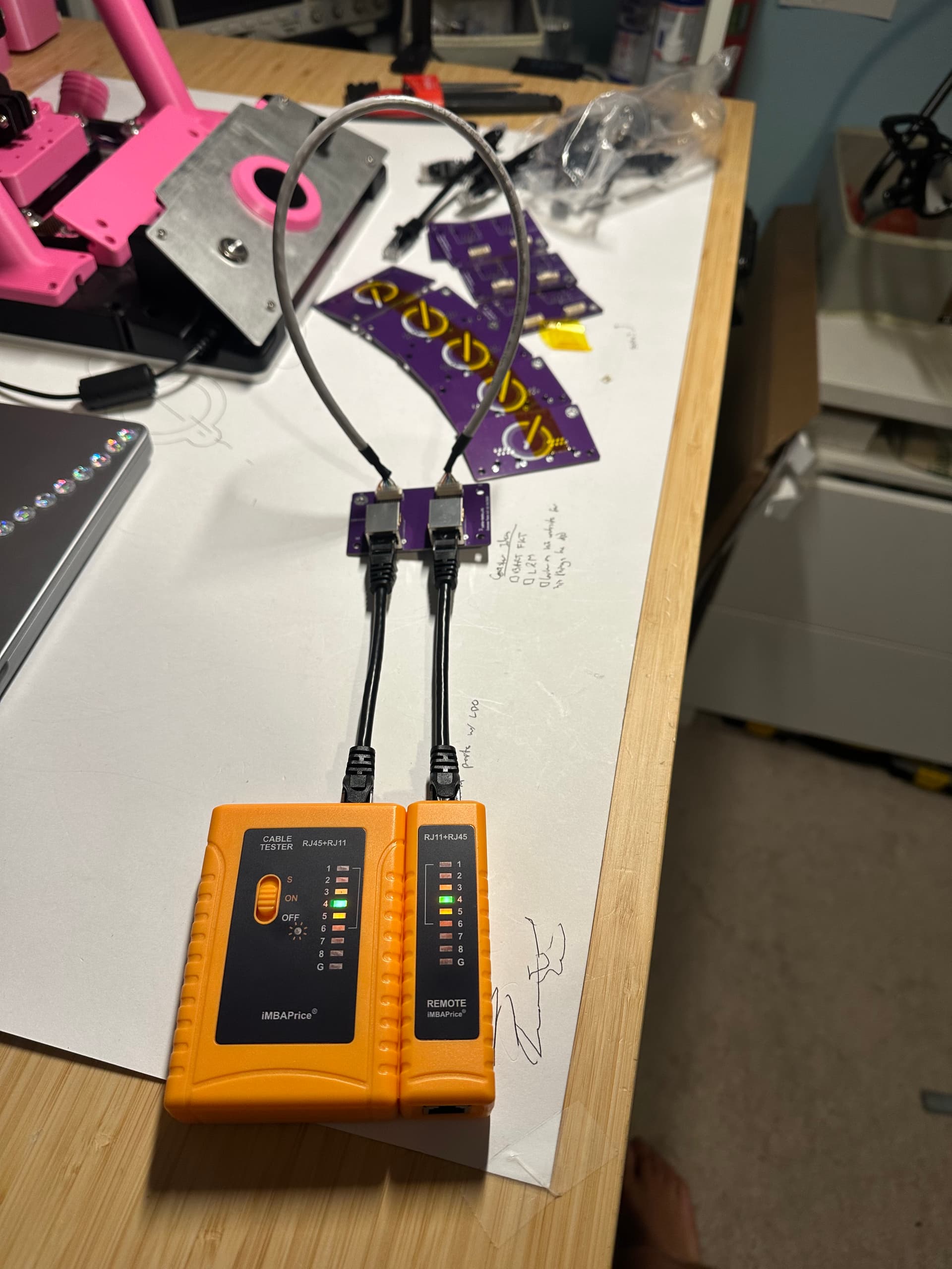

PCBs came in and it does the trick! At least for continuity checking. I just got the cheapest cable tester I could find on Amazon. Maybe it’d be worth it to get a nicer one that can test data transfer as well..?
I think that is not necessery.
You have no mega transfer rates on it.
And if you use CAT6 Patchcables ready assembled, they are proofed.
I got in our company a FLUKE DSX-8000
It will cost over 9.000 EUR.
I think that are ROCKETS on small BIRDS…
This tester is not testing anything other than continuity and lack of shorts, so it’s perfectly suited for this kind of test setup.
I don’t see any reason to try chase anything else, especially not data down the cable. Cross-talk should be fixed at design time, not tested for in this case. By the time it’s causing actual data corruption, your signal integrity is so bad that you’d already be running into real world issues.
Heard, thank you guys! This setup should do just fine

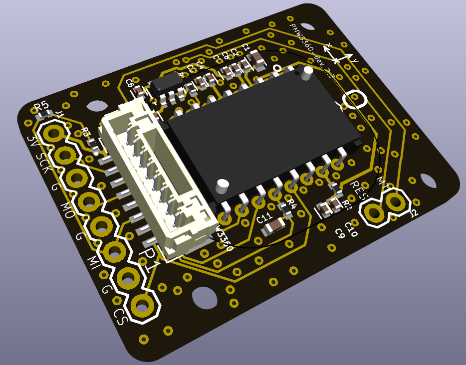

Finally dragged the PCB’s into KiCAD V9.0 they look fine. (Assuming I imported correctly :wink: ).
Might have reduced the number of ground vias but better too many than too few, otherwise looks good.
Sweet! Are they still easily editable after import?
Yes, just getting familiar with the new interface.
Couldn’t get the 3d model footprints to automatically import and had to manually re-assign them.
Can share the Kicad project files if you want.
Sure that’d be awesome! I want to start shifting everything to KiCad anywho. It’s such a better streamlined format, and exporting for manufacturing just makes so much more sense
Compass.zip (5.5 MB)
Files attached.
See how you go.
Not sure I should have brought the PMW3360 under the Compass project but haven’t had time to tidy it up yet.
I haven’t uploaded the Teensy or TMC2209 3d models as these are large >18MB. You can download directly from Grabcad.
If it’s an issue I can share on Google Drive or similar.
