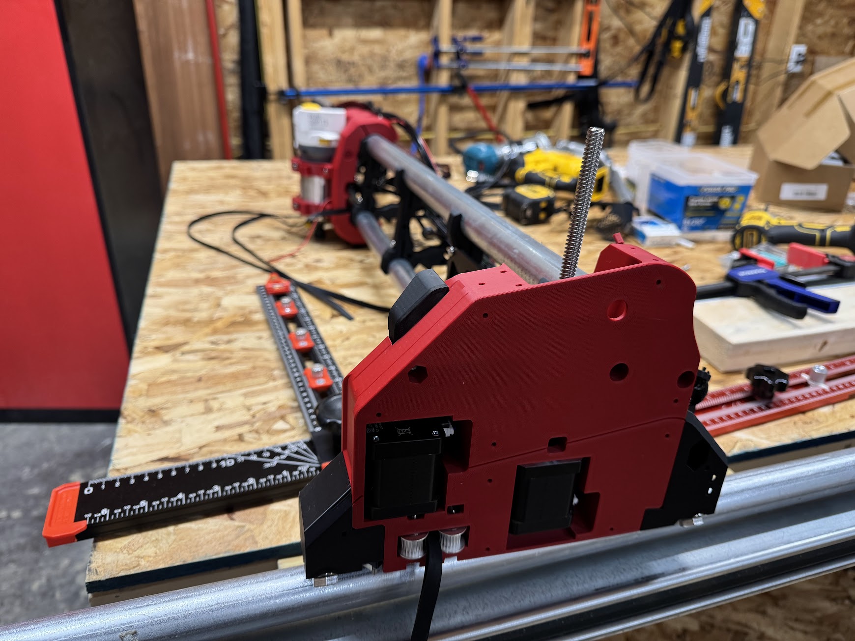

I am building a 4x8 working area machine, and I intend on placing Unistrut on both sides. I am trying to visualize in my head how this will work out with the strut mounting, and best way to avoid a couple of problems. I have the drop belt modification installed from design8 which will move the belt into the strut, and help prevent damage when loading the machine with a full sheet. ( [Unofficial] LowRider 4 CNC: HIDDEN BELTS MOD - Hide/protect wheel side Y axis belt inside metal strut / unistrut / superstrut (v2.0) by Doug Joseph (design8studio) | Download free STL model | Printables.com )
For the unprotected side however, the wheel on conduit side, I am unsure at what height to mount the strut with the conduit attached. If I lower it, the machine would have similar min/max travel height, and expose the rail side belt less, but would that cause any issues? I drew a crappy illustration of what I’m talking about. I am also confused about what best height is for the spoil-board. Should the spoil-board be level with the rolling surface (left side of the picture), or should the rolling surface be level with the table surface underneath the spoil-board. I’ve seen the forum posts of the torsion tables, and they all look like they end up with taller spoil-board than the rolling surface.
Green - unistrut
Orange - spoilboard
Blue - Conduit
Grey - Lowrider V4
It seems that if the conduit side is mounted on the surface, you limit the range of motion of the machine.
I may have just answered one of my questions, I just realized that the rolling side plate is offset, and places the mounting point of the x rails higher - so I think that really only leaves my question about spoil-board height.
Just to confirm it for you: the unistruts are at the same height because of the offset.
I always put my sides on “runners” so the spoilboard would have the same height than the sides. so basically like in your last drawing. :slight_smile:
I used the unistrut mod on my recently built table, but only used it on the “min” side to hide the belt similar to your thoughts. I didn’t use any unistrut on the rail side since it has the rail, I just intentionally built the table large enough to drill the rail down flat to the surface beyond the point of my spoil boards - but on the same plane. It’s pretty elegantly simple since it’s designed to be placed on any flat table.
Personally I don’t really see any benefit in my use case to have a unistrut on both sides, my entry point for full length stock is on the min side and the only side I need to have access and belt protection. I would use your second unistrut above the machine to hold up the vacuum hose, I just did an install of that last weekend with baring runners.
Nice, thank you, that’s very helpful, and a good idea about the dust collection host. That would allow me to use a cable chain where the hose goes. Yours is the one on the printables page I think? Looks good!
