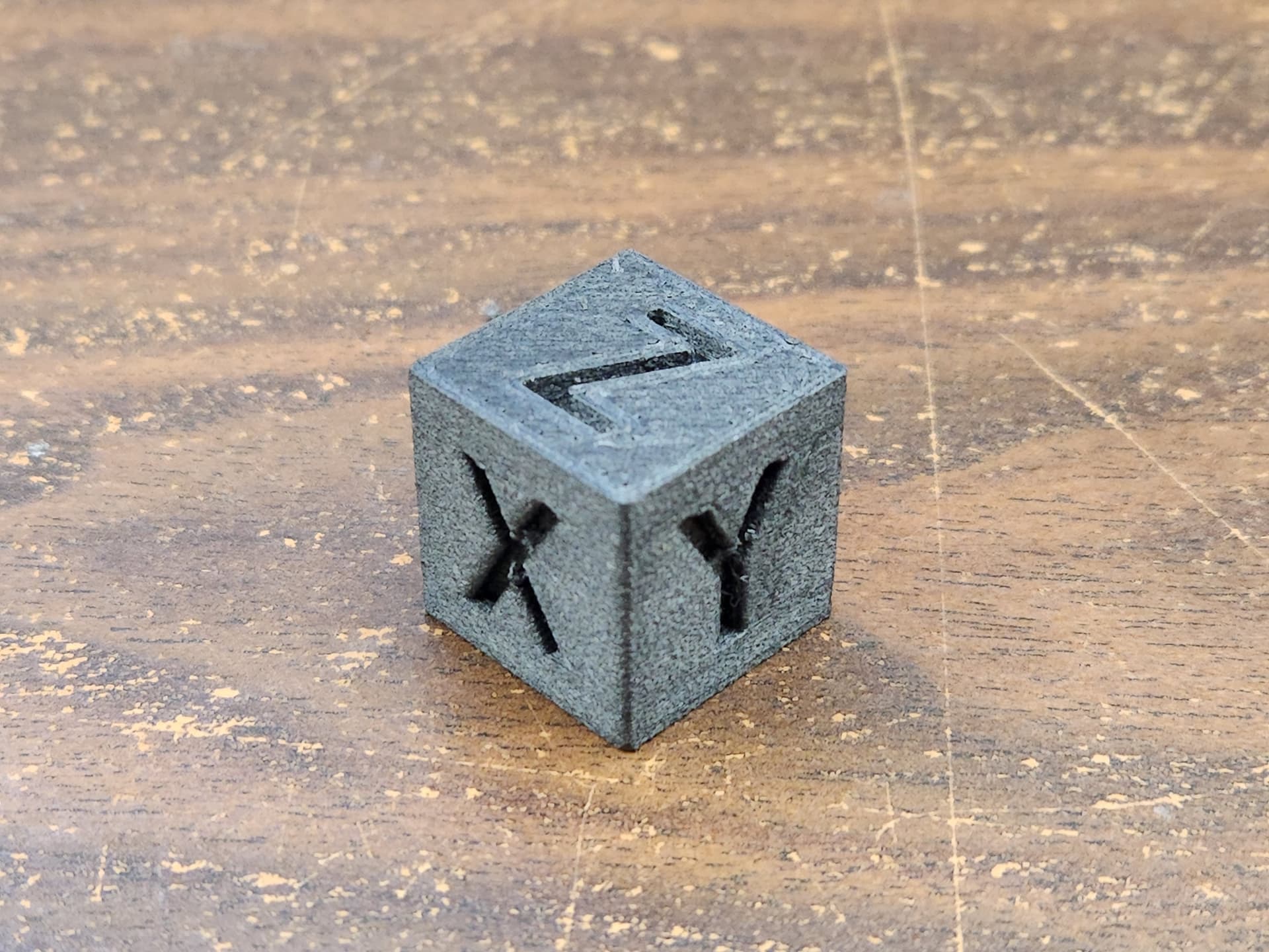

Here is a picture of the test cube I did at 0.15 layer height. I double checked the diagonals even though it’s small and they were the same. This is the same printer I sed for my Burly and had no problems so I was more worried about accuracy of the new filament because I knew my printer was already pretty decent.
I did find out this weekend that some of the larger parts were giving me some blobbing so I upped the layer height to 0.2 and it seems to have helped. Maybe printing at 0.15 was a bit optimistic. Especially for a filled PETG.
I would at least triple the scale of that block. In my opinion, it is far too small to help with any sort of accuracy test. It does help see print quality though!

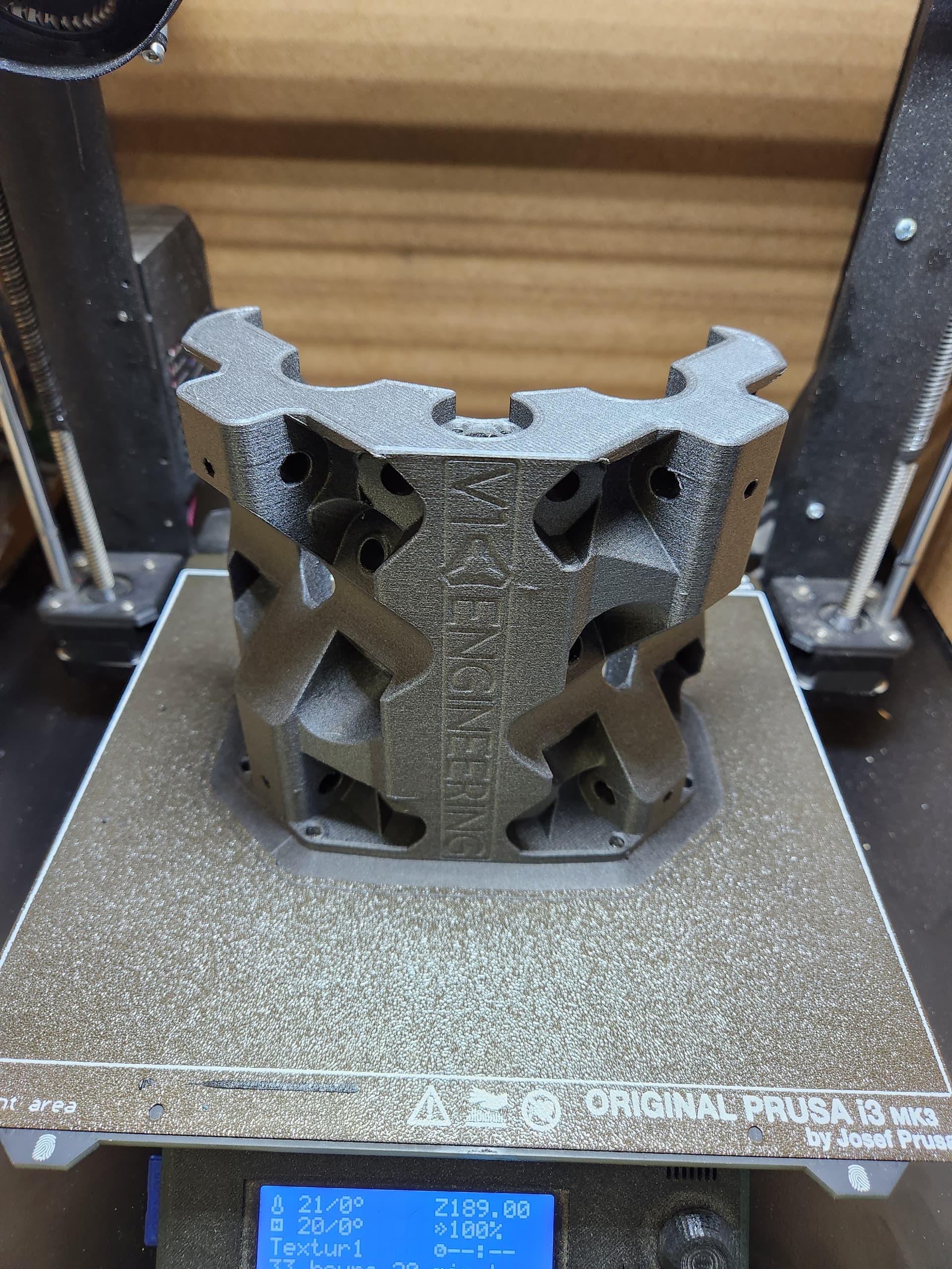

Now that I got the material pretty well dialed in and I ran out my first spool, I decided to print the core with a fresh new spool. And everything went really well, especially for a 34 hour print. I still have the occasional blobbing but they are small and can easily be scratched off.

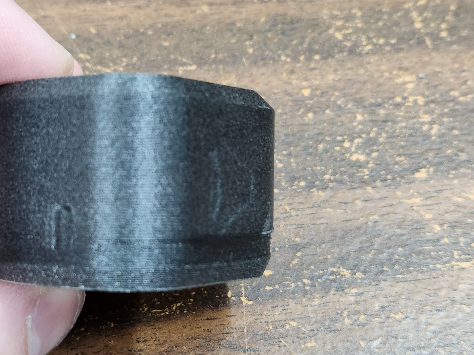

I have a question on the corner leg locks. Everything else seems to print fine but these are having what almost looks like a layer shift on just one side. Does anyone know what could be causing this? My first one was fine but the next two had this more pronounced and were loose in the corner bottom part pocket. Almost like the bottom section is printing too small. The third one I moved and sliced it again in case it was a slicing issue but that didn’t fix it. I also greased up all my rails.

It looks to me like your wires are too short so all the way at the bottom it can’t reach, or perhaps your spool is having too much drag. In what direction is it too small, X I am guessing. If it is Y then your bed might have been hitting something.
I believe it is in the front right corner which would be both the X and Y axis. It just seems odd that it is pretty much the same position on these leg locks but I printed the core after printing these and it didn’t have any inaccuracies on the lower layers. And it’s only on one side of the part. One side looks small until this odd transition point and the other side looks fine. I’m just going to hold out on printing these again until last and if I run out of this CF filament then I’ll make them out of PLA. Just asking to see if this was unique to me.
As in the file itself? That has been proven thousands of times over.
The shift is only in one direction. So it was shifted in X or Y unless you placed it on your bed at a 45 degree angle and that would be even more odd because it would have sifted exactly the same in both directions. The print itself corrected perfectly as well so whatever happened stopped happening without missing any steps. That is extremly odd.
I wasn’t thinking the file was bad. I just thought maybe if it was due to unzipping the file or something with my slicer than maybe someone else may have experienced it. But, looks like I’m just the lucky one.
Given that it is just this part and the way it’s happening, I’ll just accept my printer just doesn’t like this part at the moment. I’ll just wait until everything else is printed then I’ll trouble shoot it some more and let you know what I find out.
If it happens every time you print it, download it again, move it to a different location on the bed and try again.
I don’t think I have ever seen a corrupt part file with such a minor corruption.
