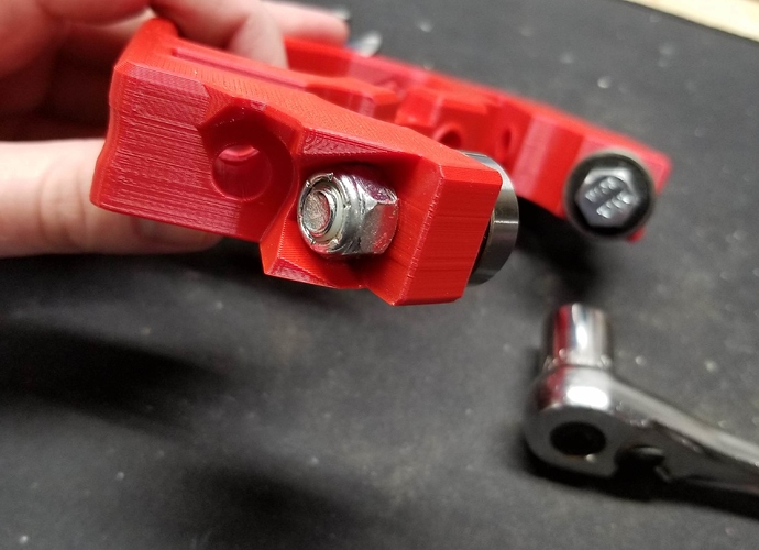

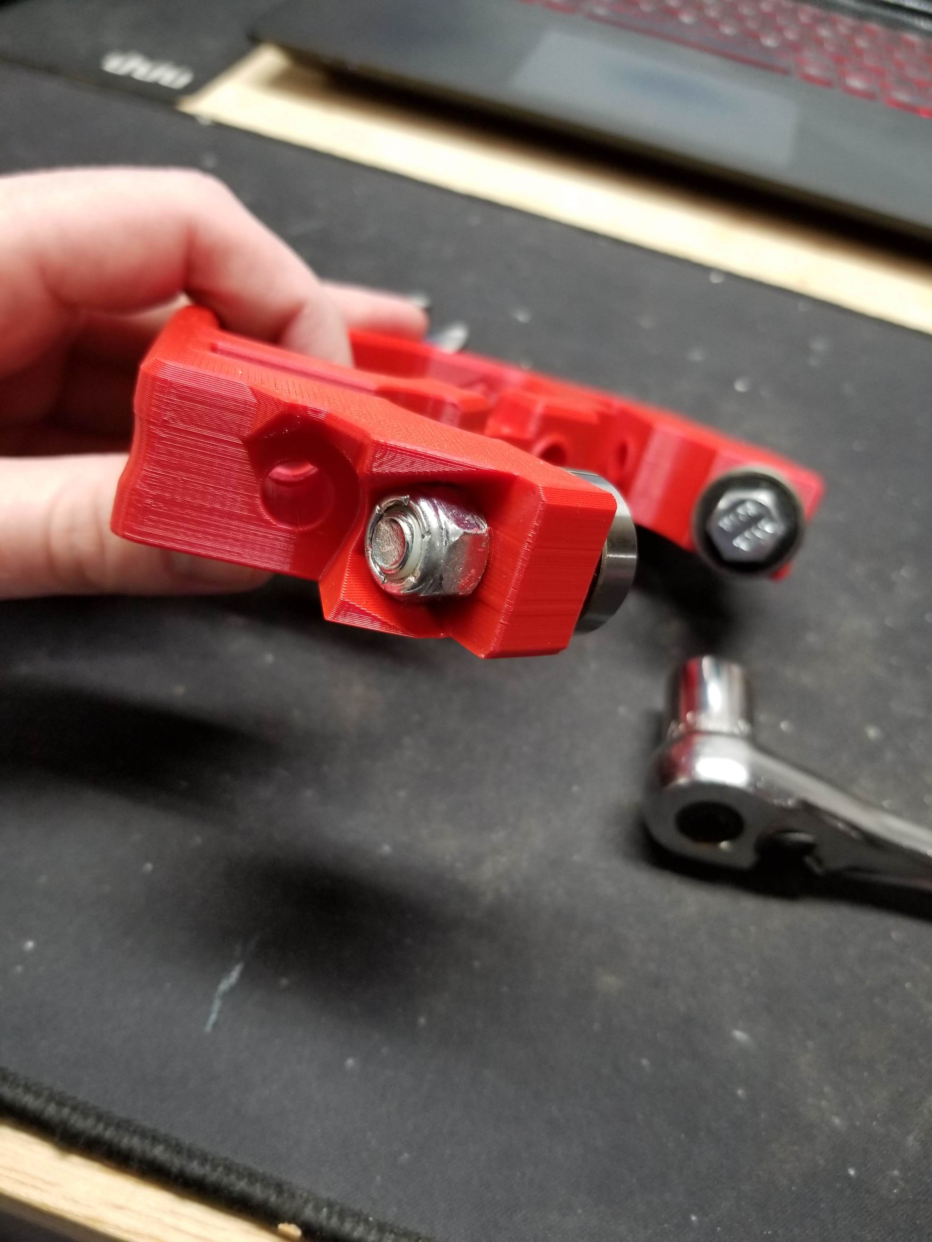

One quick question, is there a trick to this nut? I know you mentioned that the Burly parts are a little more tricky to put together but the nylock nut is spinning on me and for the life of me I can’t tighten the bolt in it all the way.

I used needle nose pliers for those.
Or a small flat shim, screwdriver, whatever you can get in there. It is sized for the larger 8mm nut for the international builders. We have to deal with that nut they have to deal with the smaller #6 nuts. (all because I am too lazy to make parts for both in all the build sizes)
Needlenose did the trick. Had to have the fiance turn the bolt but it worked!
No worries, like you said in the instructions it only needs to be tightened once. Thanks!
