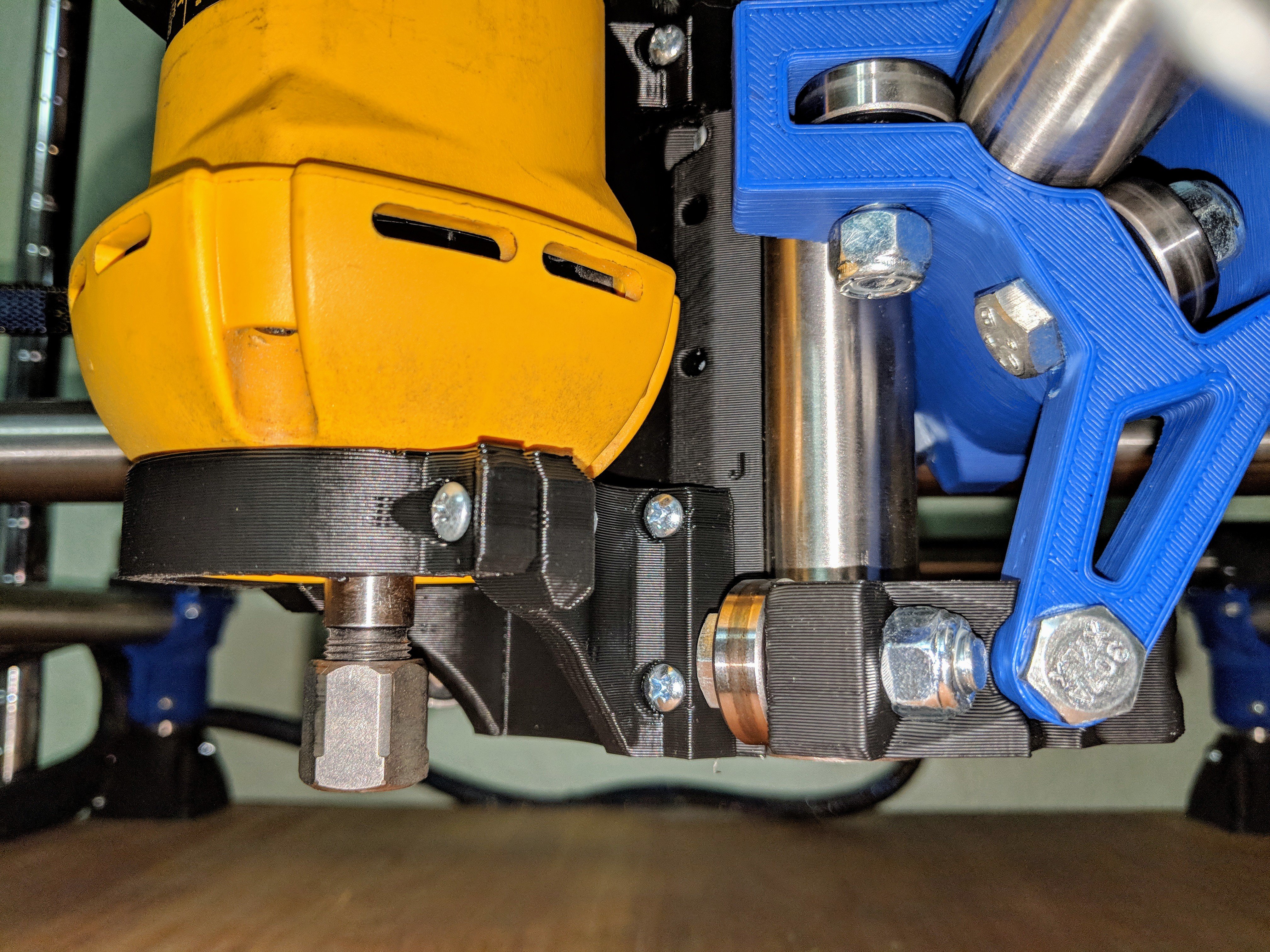

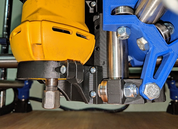

Revised the 660 mount a bit, nothing fancy just more…Burly. I am already getting tired of that, I liked “525” better.

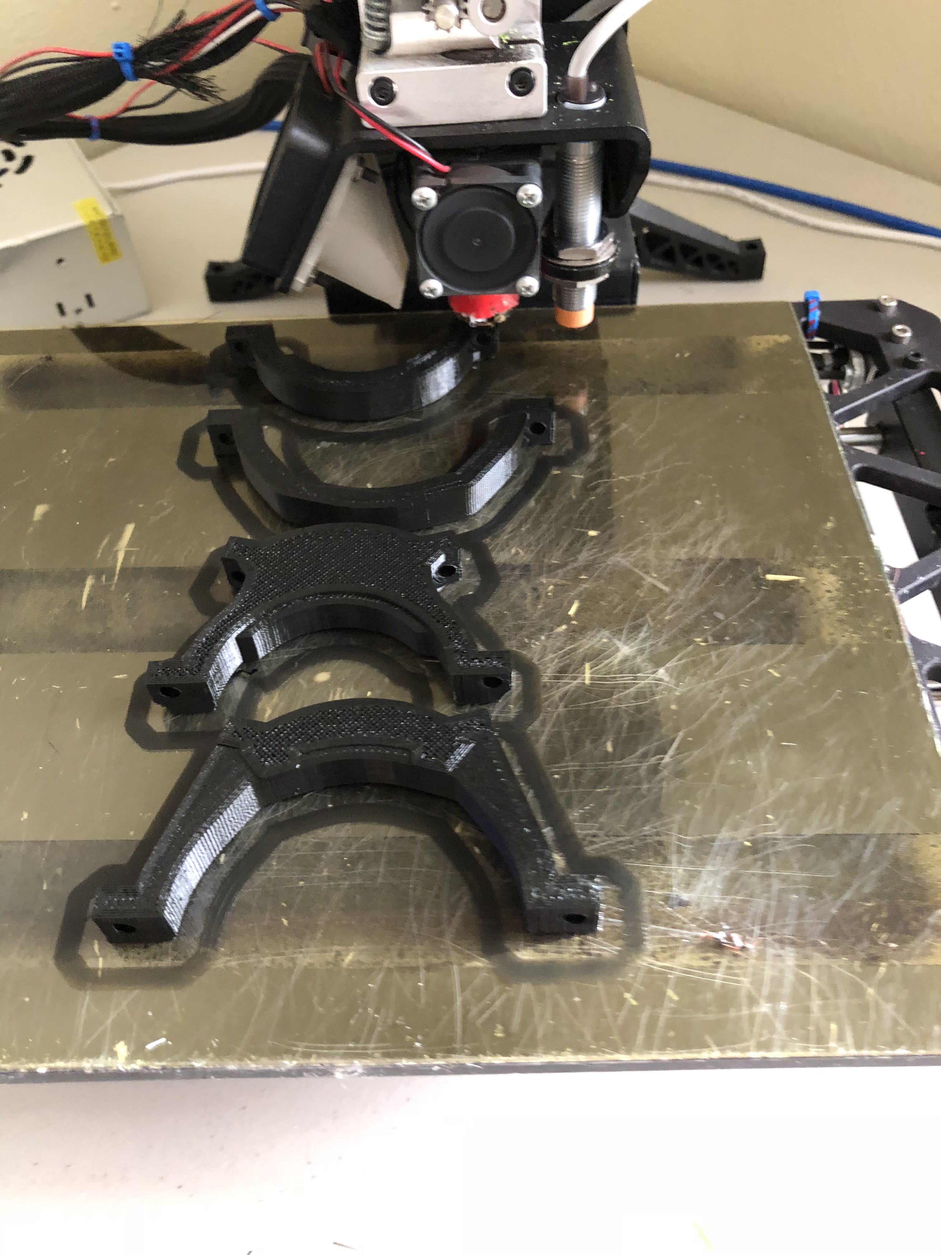

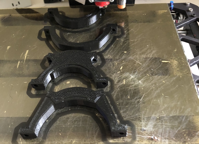

Getting close to having the new Dewalt 660 mount printed:
[attachment file=“2018-10-22 16.05.28.jpg”]
Totally depends on what you make. But the size calculator defaults are a good place to start.
??? Those are the old parts. As for the 660, Most of us take off the black ratchet part on the bottom, but leave the top lock.
