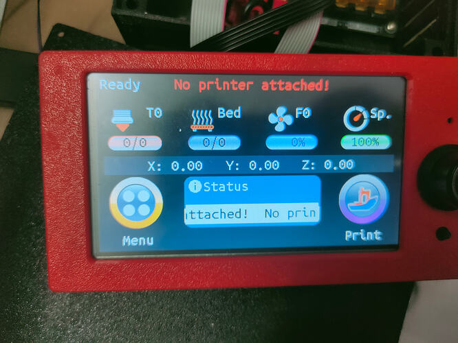

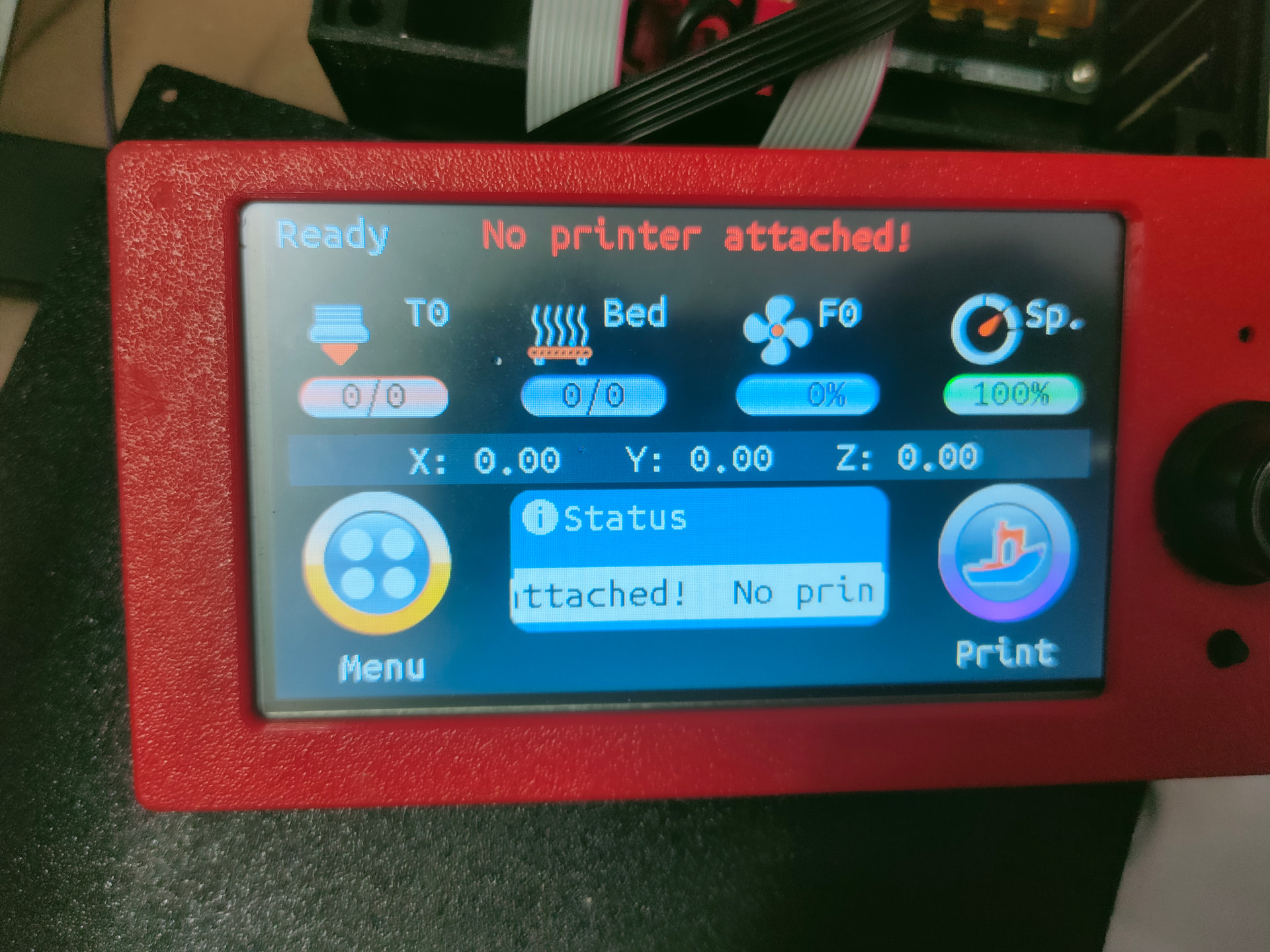

:red_exclamation_mark: Problem
When using Touch Mode, the screen shows:
:red_circle: “No printer attached!”

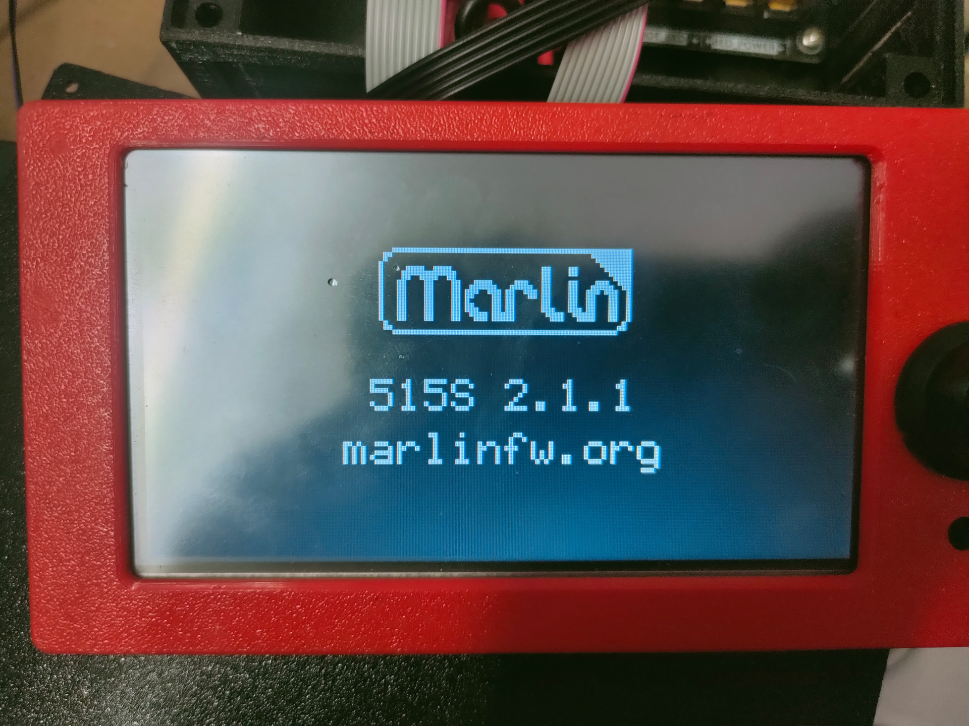

:white_check_mark: In Marlin mode (EXP1/EXP2) everything works perfectly

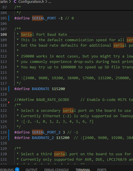

:brain: Marlin Configuration Tested
Current configuration (compiles successfully):
C++
Copiar código
#define SERIAL_PORT -1
#define BAUDRATE 115200
#define SERIAL_PORT_2 3
#define BAUDRATE_2 115200
I also tried:
C++
Copiar código
#define SERIAL_PORT_2 0
Other combinations caused compilation errors like:
Copiar código
template argument 2 is invalid
SerialOutputT {aka int}
With the current configuration, Marlin compiles fine.

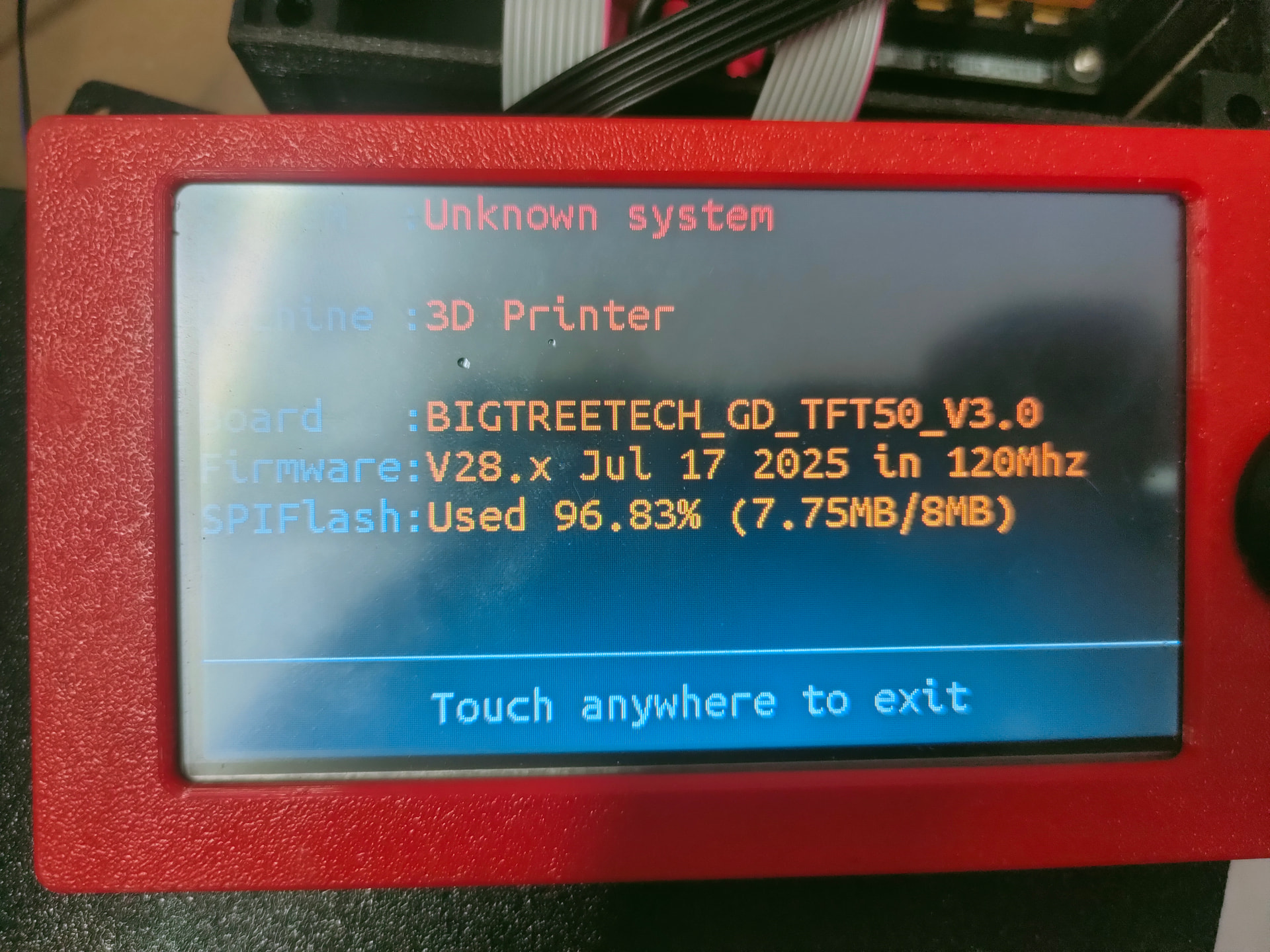

:magnifying_glass_tilted_left: Strange Behavior
If I unplug the 5-pin cable completely:
The TFT still shows activity under:
TX gcode bytes
Scan rate
So it seems like the TFT is transmitting, but not receiving anything from the board.

Is SERIAL_PORT_2 3 correct for SKR Pro V1.2 TFT port?
Could the TFT port be mapped to a different UART?
Could USB (-1) be conflicting?
Is there something that must be enabled in pins_BTT_SKR_PRO_common.h?

That message will always show up for about the first 30 seconds or so upon power up.
If it doesn’t clear after a minute or so, it probably indicates either a wiring issue or a configuration issue.

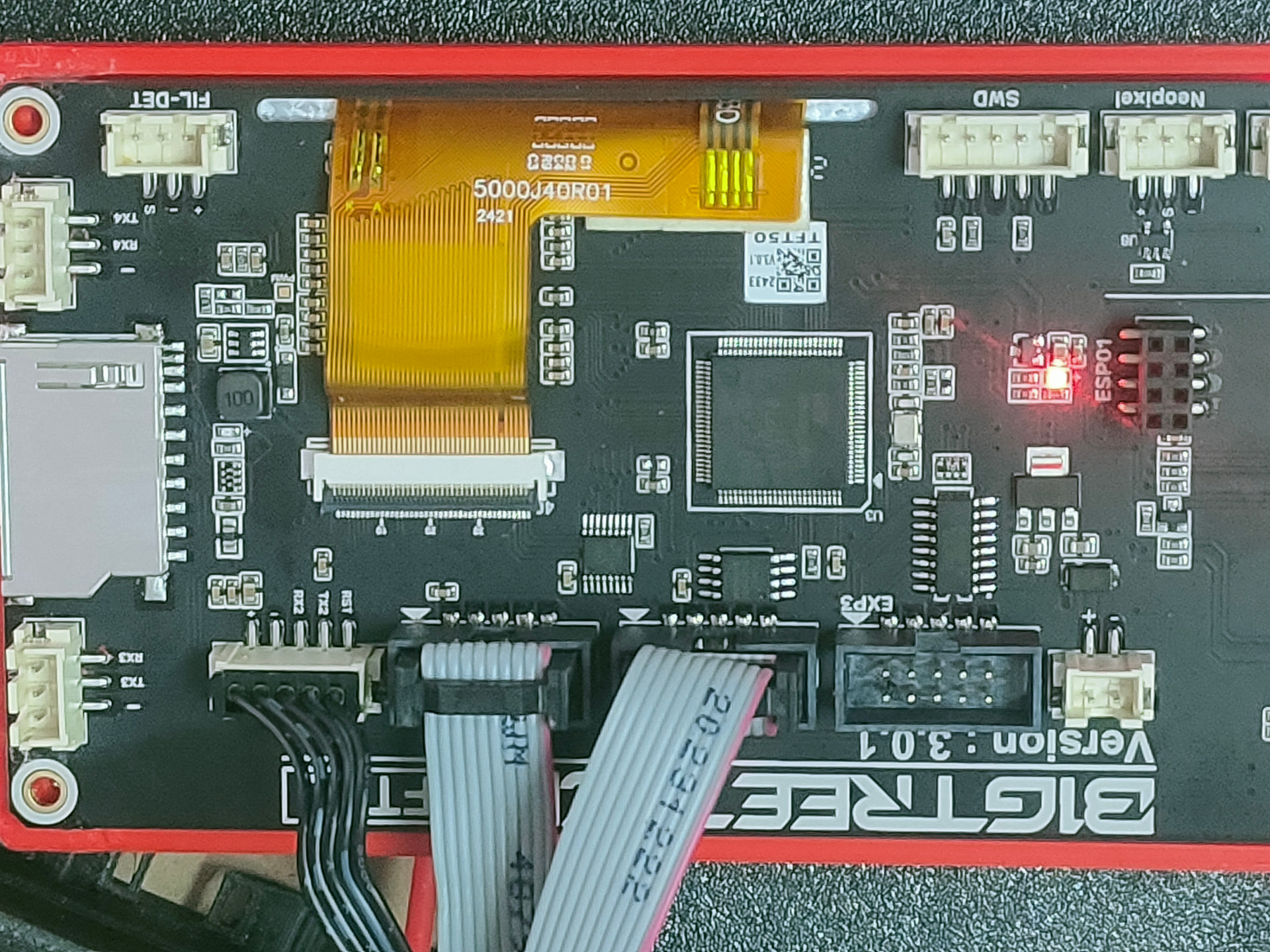

Hello. I've found the communication problem with the TFT and the SKR Pro. I tested a TFT35 and it works perfectly. The fault in the TFT50 is the GD chip. I've already ordered it from AliExpress. The problem is the TFT's TX and RX. Thanks.
