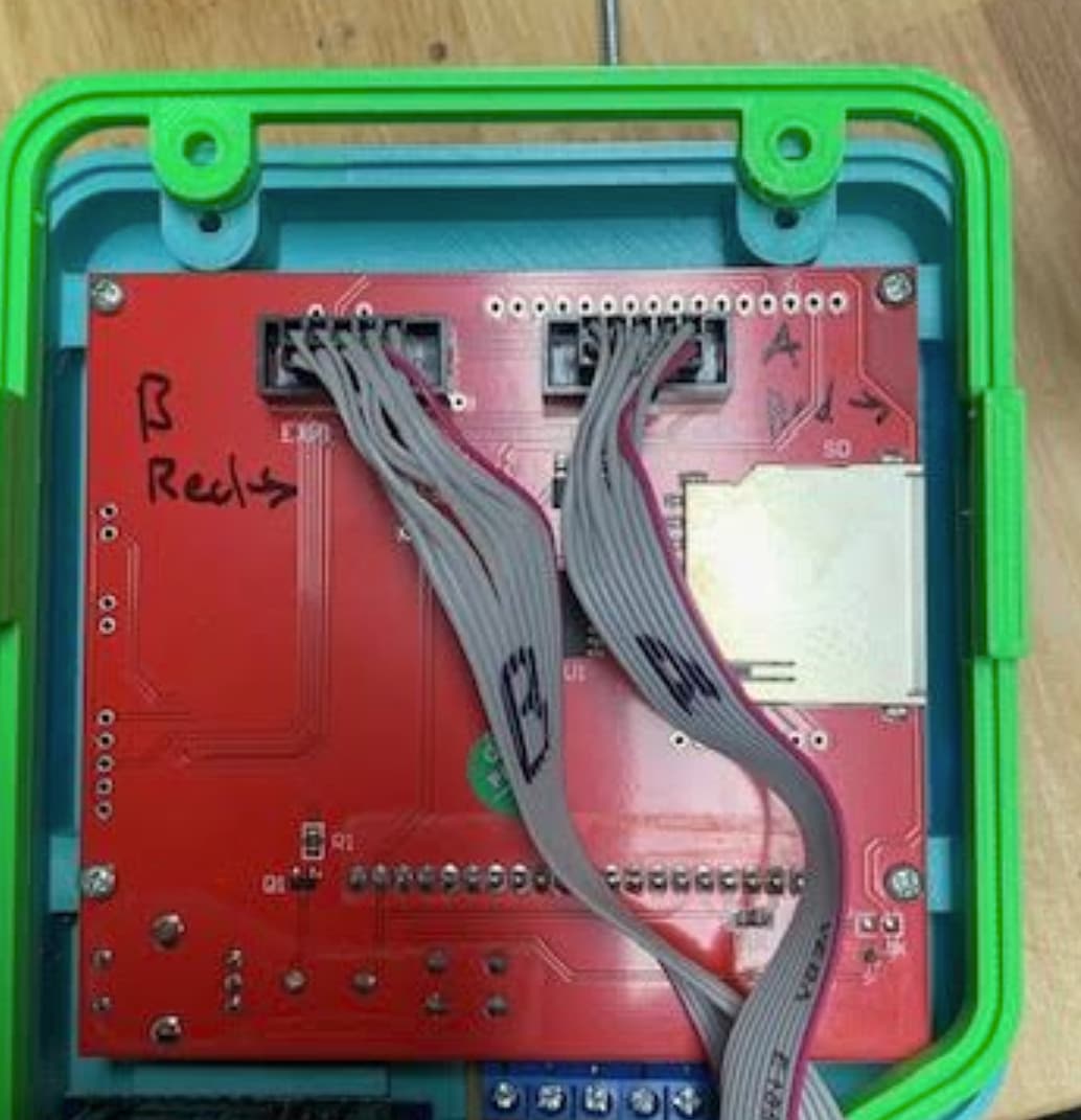

I am hoping there is a person that knows the deep inner workings of a Rambo 1.4 that can offer some insight here. I am rebuilding and I think I may have damaged my Rambo 1.4 in the process. Blew out the serial comms anyway. When I fired back up, I am just getting a blank LCD (backlight is on, and fuses are all good). I am also unable to connect via PlatformIO, but I am not sure if it is because of Windows11 (new machine) or the board itself. The COM port does not show it as a RAMBO, just a USB device, but it does show up.
In the rebuild I did not disconnect the working LCD from before, so the cables were not switched or anything. As a debug, I also tried a second display, and a second set of cables with all same results. The only other wires that were redone were the steppers and the limit switches AND an extra serial connection that I accidentally pulled off that I have going to a pendant (home built to use a joystick and an arduino for some custom buttons). That connection is on the Rambo X39 header. I believe when I first pugged it back in, I was off by two pins low on the header. So the mis-connection would have in theory crossed VCC and GND thru the pendant on the Serial expansion (X39) and the Analog expansion (X40) since the X40 also has that wired to the pendant. Does anyone know if what I am seeing is indicating a blow out and is it recoverable?

Can you provide a high resolution picture of your Rambo in the machine, and a picture of the LCD?
When you power up the rambo, does the LCD show it has power but the screen is blank, or does it remain completely dead? (Most displays will at least have a backlight or LED on them which turns on if the display has power, regardless of whether or not there is content on the display)

@MakerJim Here is the current wiring without the pendant, which was working fine for a long time (March 2020) prior to my rebuild.

Double checked my connection to pictures taken just prior to disassembly as well as ones from March 2020 and all seems to be in order (same connections) but not working.
