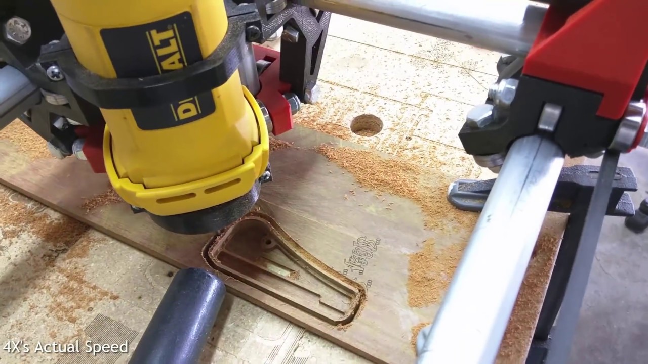

Hey, I’ve been happily using my MPCNC for over a year now. Mostly I’ve been doing V carving and have done some 3D relief work with various woods now and then. For most of them I skip the rough cut and have been just doing the finish cut. But, in my current design the cuts are too deep and I’m using Hard Maple and so I have to do a rough cut first.
Maybe I am just pushing things too fast? But, I am having a problem and was looking for some advice on what settings others are using. I use the DW660 with a manual speed controller - I usually set the speed to about 40-50% spindle speed. I am rough cutting with 1/4" bit, I have tried a straight 2 flute bit and a 2 flute up spiral, and get same results on both.
I first was cutting at 3000 mm/min (118 inch/min) at 1.2 mm depth per pass. It will seem to be cutting fine for the first 1-2 passes, then all of a sudden you can hear the spindle slowing down and the bit starts digging down into the material. Usually the x or y axis will also get off and i have to hit my emergency switch and stop it.
I tried cutting at half the speed 1500 mm/min - or 59 ipm and it did the same thing. Am i pushing it too fast for hard maple? Actually, it has been months since i cut with 1/4 i need to keep a written list of good settings. But, since I’me only cutting 1.2 mm per pass, i would think i should be able to at least cut at 100 mm/min. A lot of people (using pro CNC machines) talk about a cutting depth equal to the bit diameter… that would be 6.36mm I am not cutting anywhere near that deep.
The other part of my question or concern is, why does the bit dig down into the wood? When I say it digs down, it will dig down at least 1/4 - 1/2" (into 3/4" stock) and yet it will still often be cutting forward but the x or y will skip and get off because they can’t take the amount of force to stay on course at that depth. And, as it goes deeper down you hear the spindle slowing down because of the added power needed to cut at that depth.
My point is, I am not sure if it is the spindle that is slowing down first (like it hits a harder spot in the wood and slows down) which is causing the problem, or if it is the Z axis that is too weak and somehow it starts dropping, and as it digs down and cuts deeper that is why the spindle slows down? What I am getting at, is, do i need a stronger Spindle motor or a stronger Z axis motor? I currently have an 84 oz/in Nema 17 motor on the Z-axis. I see there is a low current (1.8 amp) Nema 23 that has ~340 oz/in torque. That would give me 4 times the Z axis strength and would help to keep the bit from digging downward. (Sometimes, however, the bit will pull out of the collet - so i am not really sure a weak Z axis is the problem.)
My MPCNC is modified. That is, I have 2 pipes on both the X and Y axis, and have 2) 3/4" plywood platforms on the Z-axis, which gives it a lot more strength - and my table is 3’ x 4’ (have middle feet on all 4 sides, so 8 feet all together - the unit is fairly solid.
