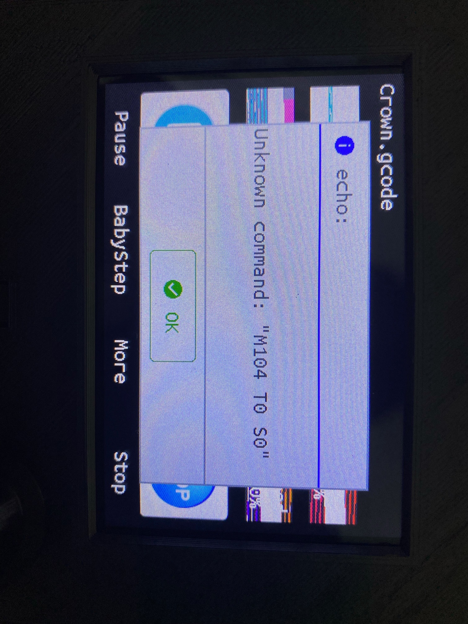

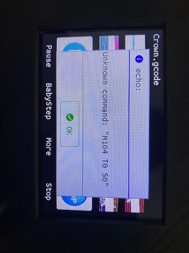

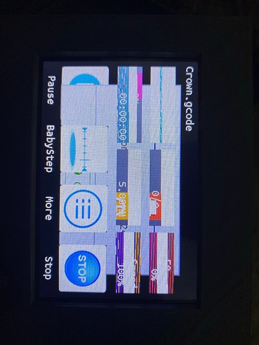

Can someone help me figure out what I am doing right- I don’t know if I loaded he wrong files . I have attached some pictures .thanks
That doesn’t look like the V1 firmware for the TFT to me.
M104 sets the hotend temperature, In this case Tool 0, set to 0°C (Usually off)
The Crown test gcode file does not have M104 included in it at all., try that one. If you still get the error, it may be the TFT firmware trying to tgreat your CNC like a 3D printer.
Try flashing it again. Remove the grey cables while flashing.
Just curious… what happens if you leave the grey cables connected while flashing the TFT firmware?
I flash with them on, others have had issues for some reason. So the advice is just to be extra careful.
