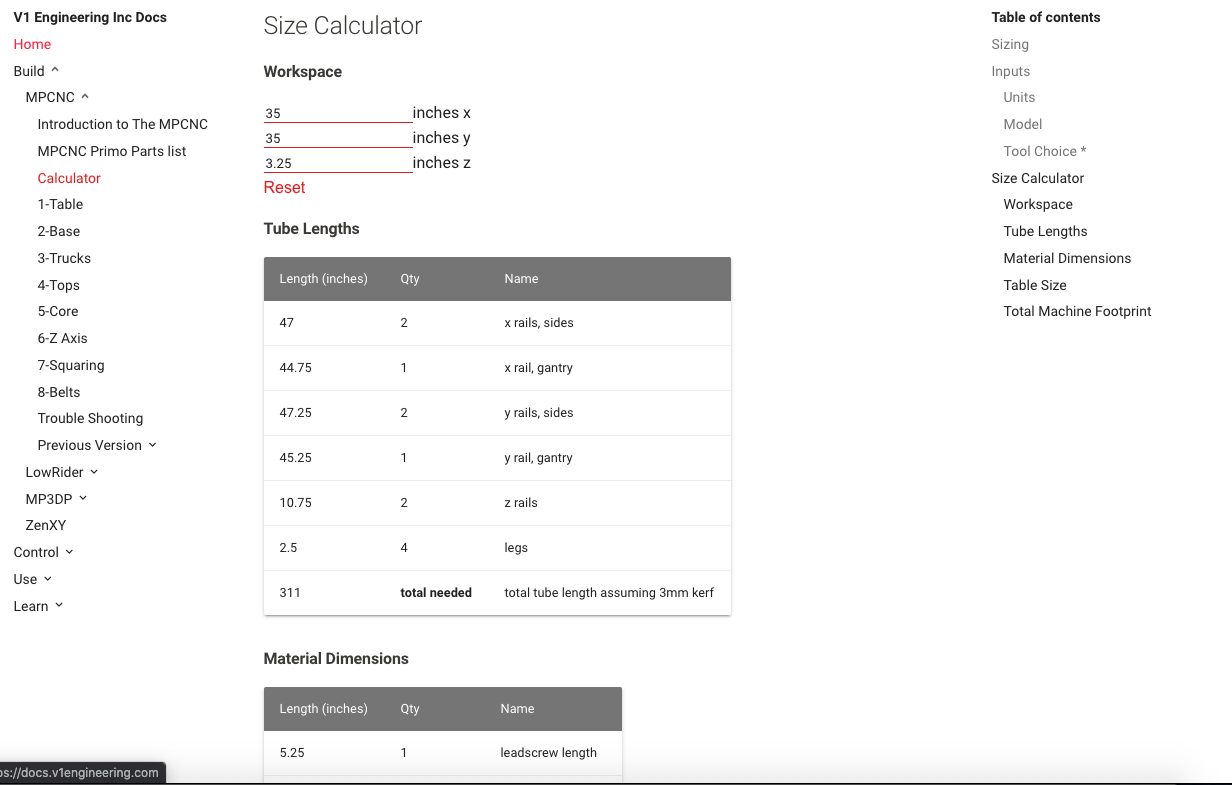

OK thank you all so cane you help me I would like to make a 35x35 would like to know what do I have to put in the Calculator do get that size I am in the US
If you are looking for a workspace of 35x35 inches
just get the dimensions into the Workspace area of the calculator, like in this picture.
Now if you want your table to be 35x35 and not have any part of the machine hanging out of the table (machine total footprint), you will have to do some math to get your tube right.
