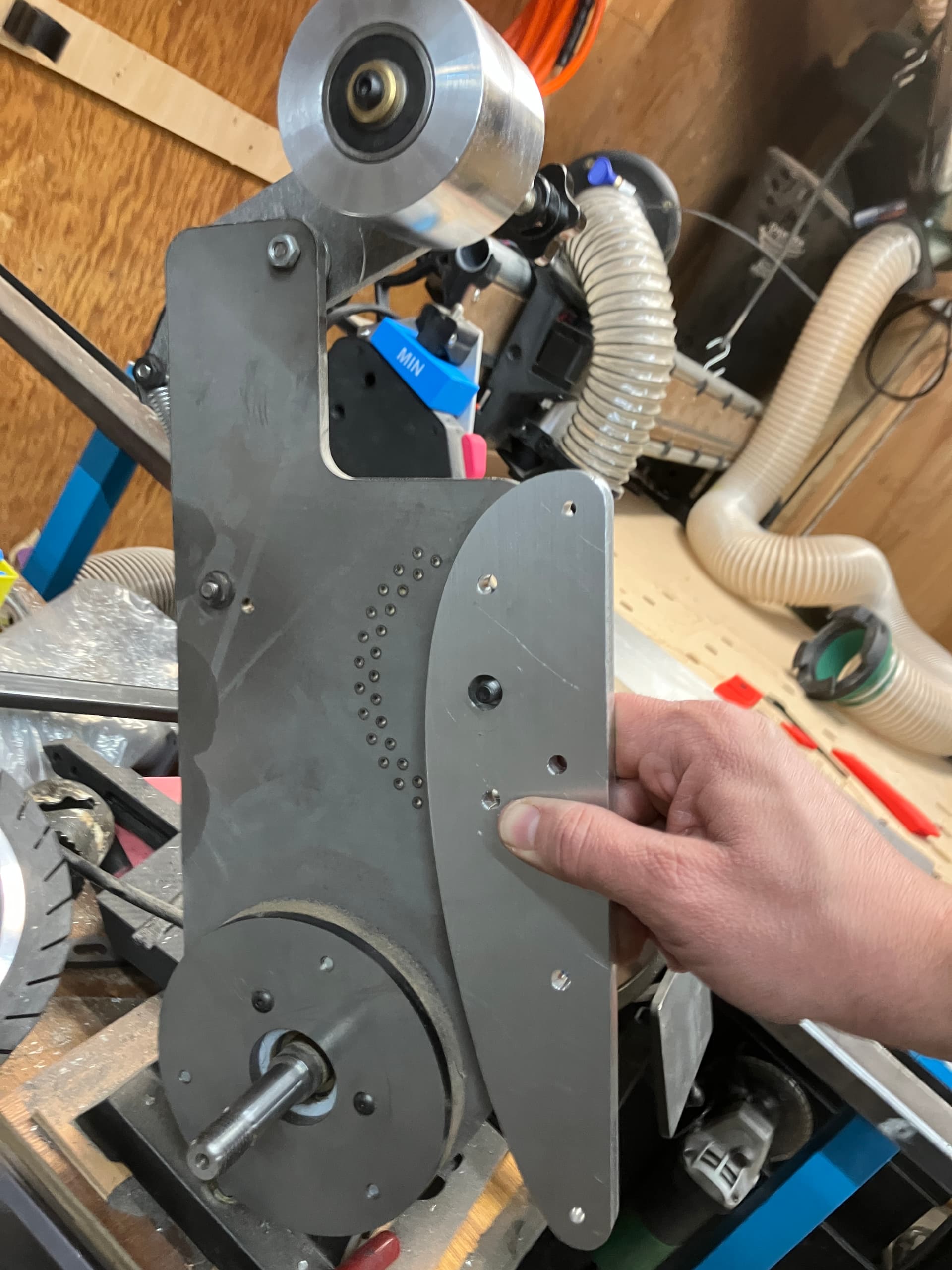

Belt grinder attachment for 8 inch bench grinder. Cutting 3/8" aluminum on LR4

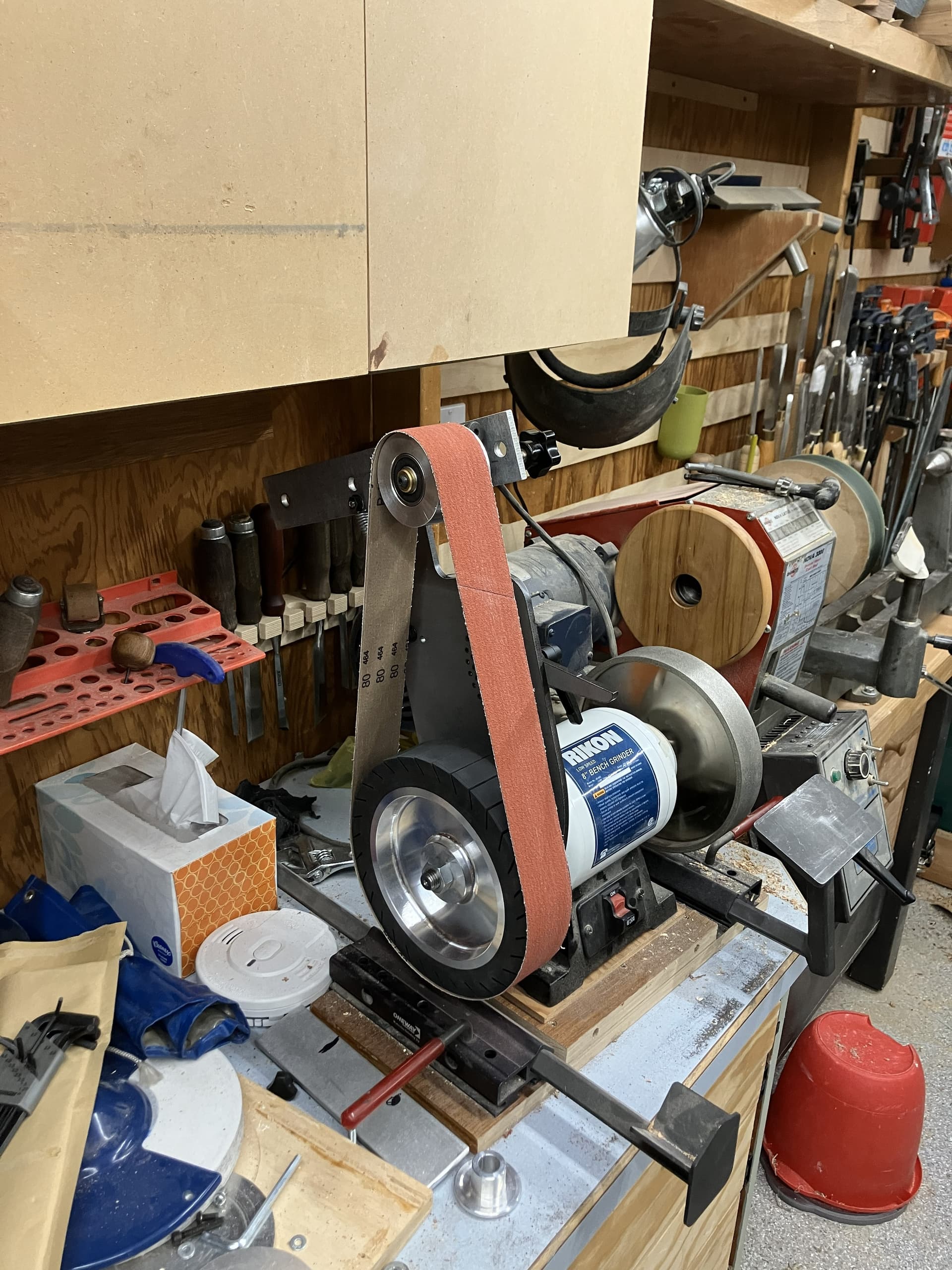

About 2 years ago I designed a belt grinder attachment for my bench grinder which used an 8 inch contact/drive wheel and built it using 1/4" steel plates from send cut send.
It’s worked well and met the design goal of allowing me to use the same woodturning tool sharpening jigs that I use on the other grinding wheel. It’s allowed me to change grits quickly and grind stuff that I don’t want to mess up my nice CBN wheel.
But after using it a while I’ve decided that the surface speed of the belt is just too high. So I’ve designed a modification to change out the 8 inch wheel for a 4 inch one with an improved flat platen.

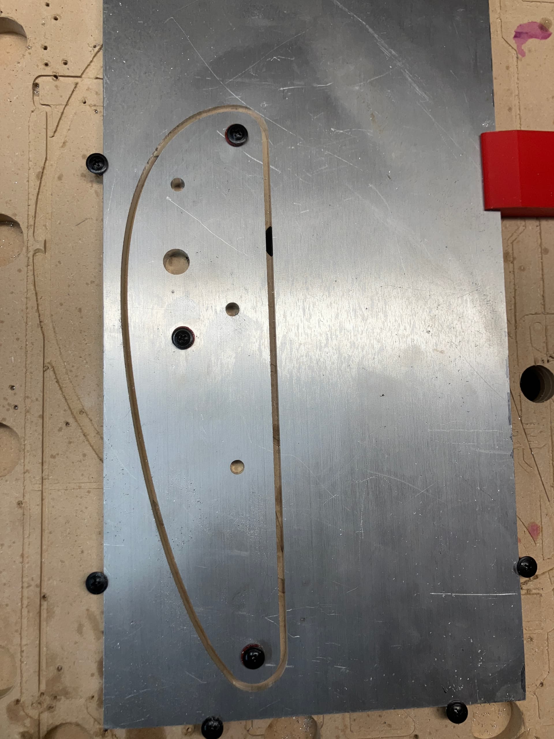

So I motivated myself to finally attempt aluminum milling. I was surprised how easy it was. At first I did some tests following this excellent guide by Mike. But I was interested in trying regular milling instead of trochoidal. Here are the parameters I ended up running:
bit: 1/8, 3 flute
rpm: 24k
feed: 30mm/s
doc: 0.01"/0.254mm
I first bored the holes then added screws to hold down the inner section, then milled the profile. The total job took just under 30 minutes. It worked really well and I think I could increase the depth of cut or feed rate a fair amount. I think I’ll test 0.02" and 0.03" depth of cut since the cutting force was only about 2lbs/0.9kg. And I have it in my head 8-10lbs is possible for the LR4?
Anyway here’s a video of the job.
Absolutely.
Try a single flute, much slower RPMs. Your cut looks perfect, With aluminum taking a larger bite prevents work hardening and makes your endmills last much longer.
Yeah, that makes sense. I bought the three flute ones on a recommendation from someone before I finished my machine and learned more. But I threw them in since I had them in my head as “aluminum bits”.
Are the single flute 1/8” bits from v1 good for aluminum? I have several so I guess I should go give them a try.
I have used them on aluminum several times and they worked well!
