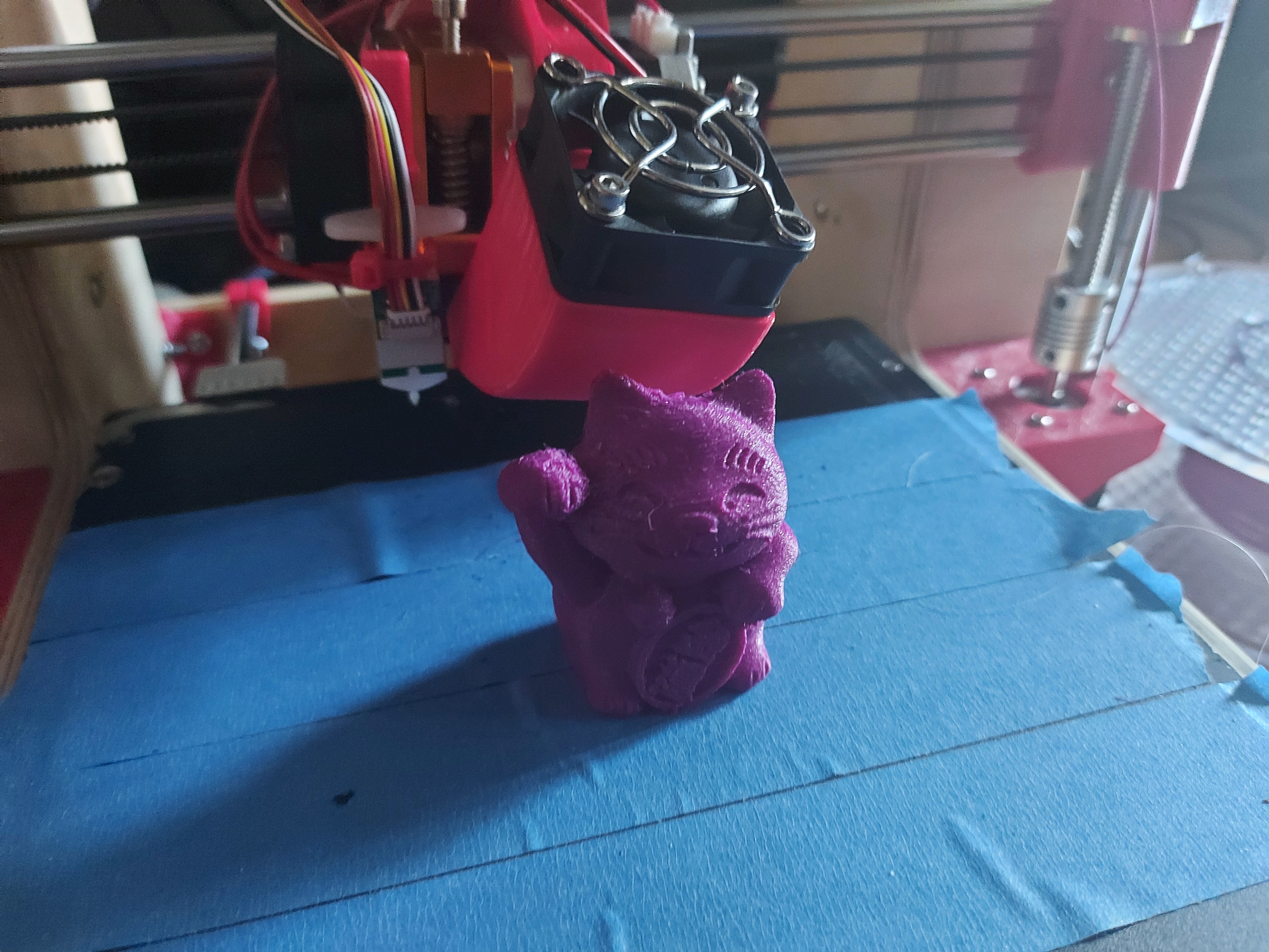

Prints look a little overextruded, with some stringing, so I’ll have to re-tube the extruder steps. It’s been a while since I’ve done anything at high resolution.
It’s been a while since I’ve done much at 0.1666667mm layers. There is some loss of detail where it looks a bit over extruded, I’m sure I can make it better. Maybe I forgot to set steps/mm on the new board.
So close. It looks pretty dang good if it weren’t for the blobs.

The inside looks pretty bad for stringing. Looks like a few PETg spiders have been busy in there… I think that it is overextrusion, not terrible, but it does build up. I probably need to re-tube retraction for the Mk8 nozzle as well, but this is standard printer troubleshooting at this point. The heat failures were worrying, I still have some things to run there while I tune the rest of the settings.
