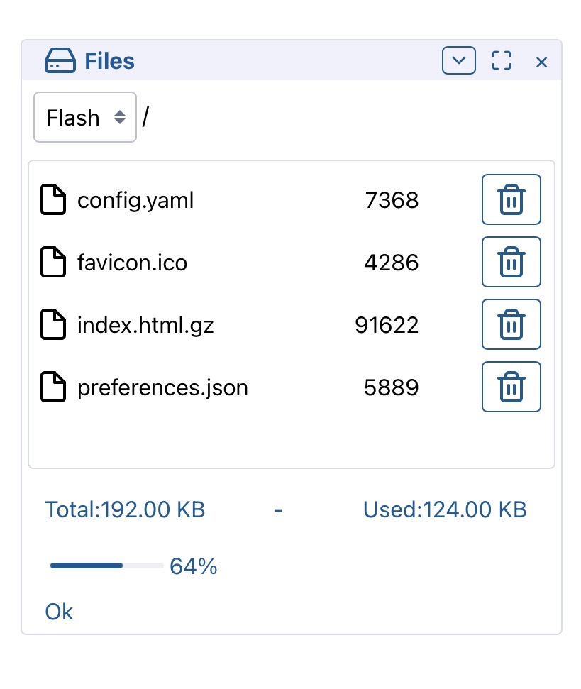

This is probably a basic question, but for some reason I just can’t get my head wrapped around the FluidNC dashboard and how to edit the config.yaml file.
Specifically I wanted set a GPIO pin to the AutoSpin T1 spindle for the on/off setup and to set up the power curve.
Also, it looks like there is pretty good adaptability in control and design of the Web UI. Where can I find the files to edit these settings and web UI? Didn’t think I would hit a road block so quickly moving over to the software side….
Also seem to be leaving the yellow brick road at this point because I only have Macs, and plan on embracing the Freecad system for CAD and CAM.

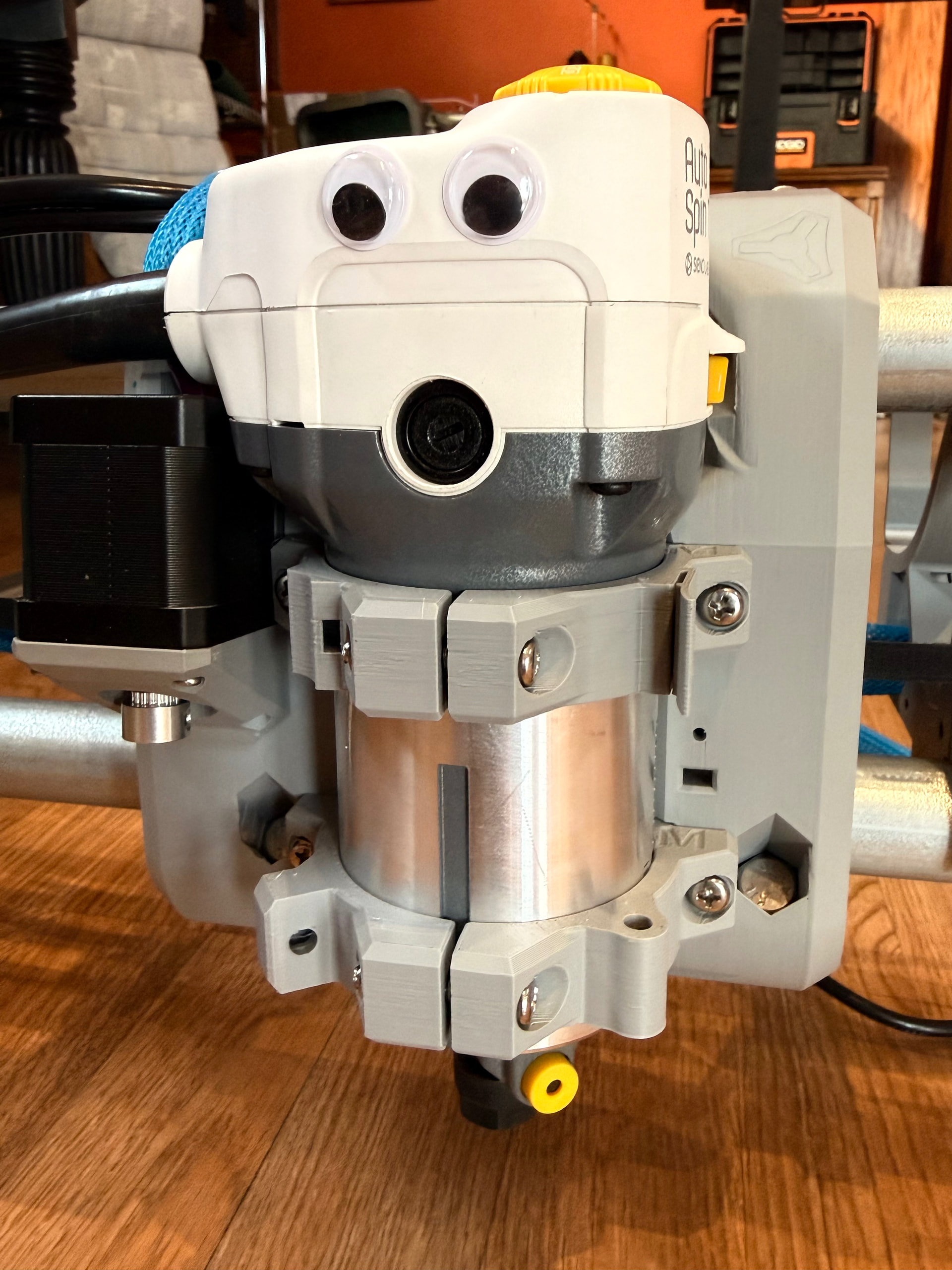

The good thing is, he looks hungry!
Which WebUI are you using? v2 or v3? v3 is much more configurable.
I am running a bone stock Jackpot 3 with @vicious1 default webui. Really haven’t done a thing with it yet except jog the motors to ensure everything is set up right.
…oh jeez I am blind…
That being said, I wouldn’t mind updating the dashboard.

The short answer is to go here. You can control which panels are displayed and in what order.
You can add themes and extensions. For example, I made one that pops up a dialog when a pause happens and another for touch joystick jogging.

Googly eyes BELONG on a LowRider!
