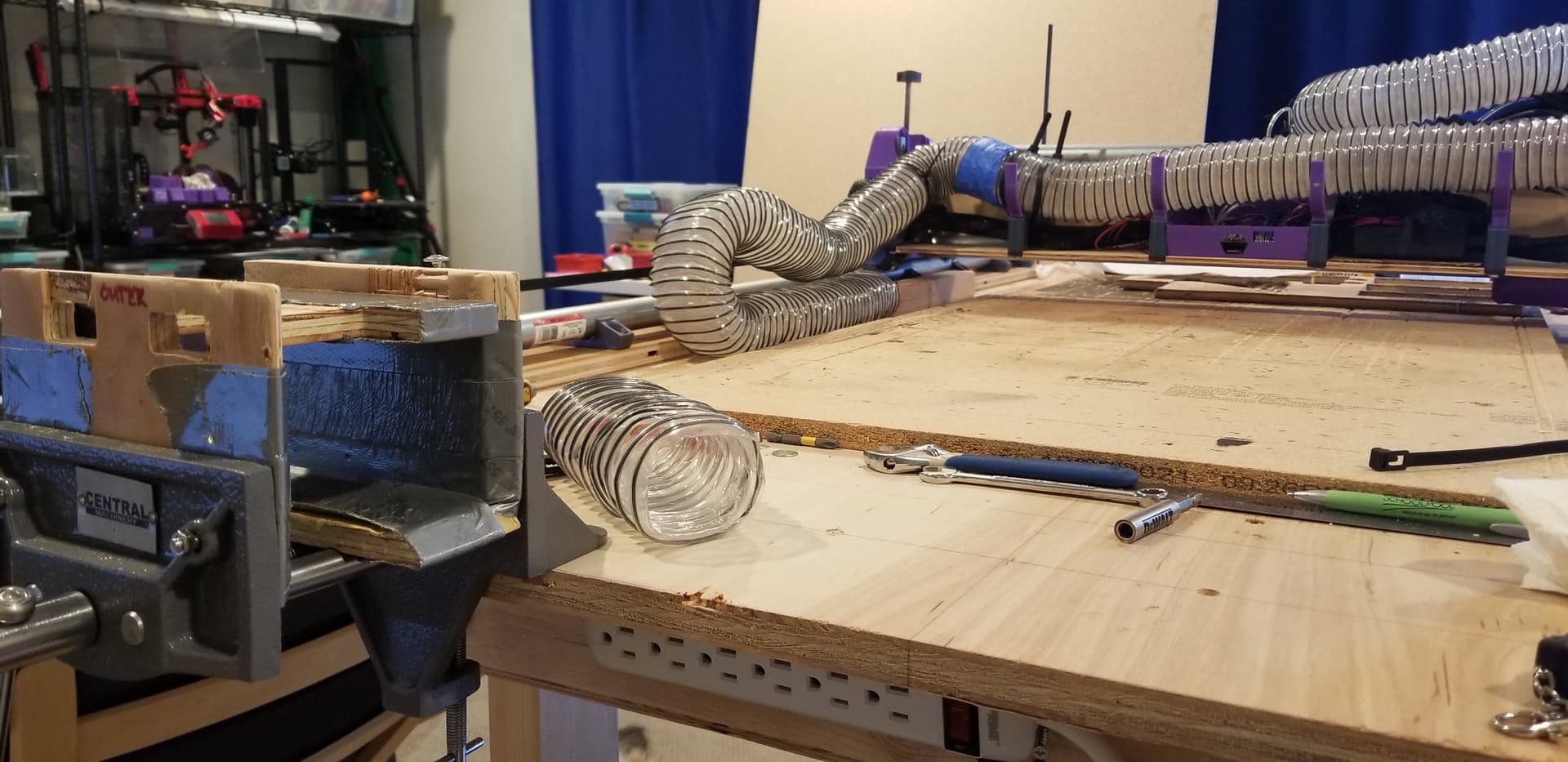

Neat! Thank you @PKochZ71, I appreciate seeing your Vac setup. Like your idea of putting hose on the X Max/right side. Good points about X travel and preventing hose being hit. Will make my final Struts 1"-2" longer than the extra 2" they have to leave room for the Drag Vac Hose (DVH).
Will limit X travel using software and/or hardware (e.g. attach stop block to X rail(s)), so Core (and Router) cannot collide with DVH near X max.
Like the moving blanket clad enclosure, that’s more professional than the janky layered towel setup I was planning. So, thanks for sharing info about your multi purpose enclosure.
Your use of PVC pipe sections in the spoilboard is neat too, I have a bunch of Pex and PVC fittings/pipe that could be used like this. Great use of materials!
Just noticed your “PVC fence” and Vac setup post in LR3 to LR4 Upgrade! (Alabama, 2024) - #59 by PKochZ71
Cheers!

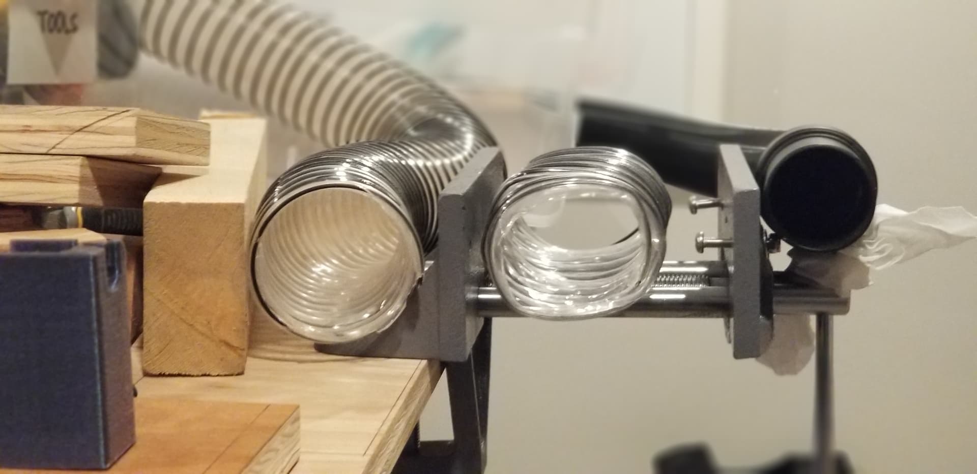

EDIT: Noticed some recent Vac related posts, sharing incase this helps… @PKochZ71 has given me hope about using the deadzone on the railside. Currently squishing a 2-1/2" Vac hose to fit…
Squished 2-1/2" fits under bottomed out LR4 on 3/4" raised Y. Would build torsion’sh box differently if was starting over, would create a deeper channel for regular 2-1/2" hose to fit. Hose is not stiff enough to self support, a legit drag chain or some kind of support/reinforcement would be needed for Longer bench.

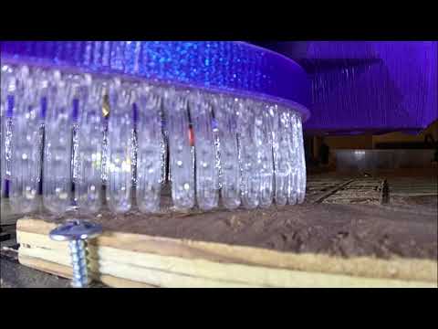

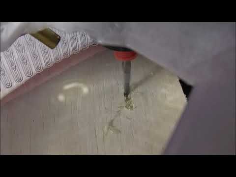

Anyone seen exceptionally eye/camera friendly dust shoe+skirt setups on a V1E or other machines? I like how effective current design is at doing it’s job.

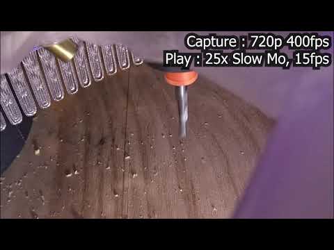

Am trying to get decent footage showing off the LR4, and better understand behavior/limits when pushed… Better slow-mo cam would be ideal.
at 0:20 you can see your skirt and shoe bouncing

Time to see how quickly the lens gets dust covered and scratched…
Still need to see how effective the Dust Vac still is. But am already liking the peek-a-boo port hole even when not filming.
Well done! That’s a super solution- I am going to keep my eye out for something smaller in size and cost, but I doubt that will happen this year!
I am really looking forward to some moving pictures of actual stuff happening. :exploding_head:

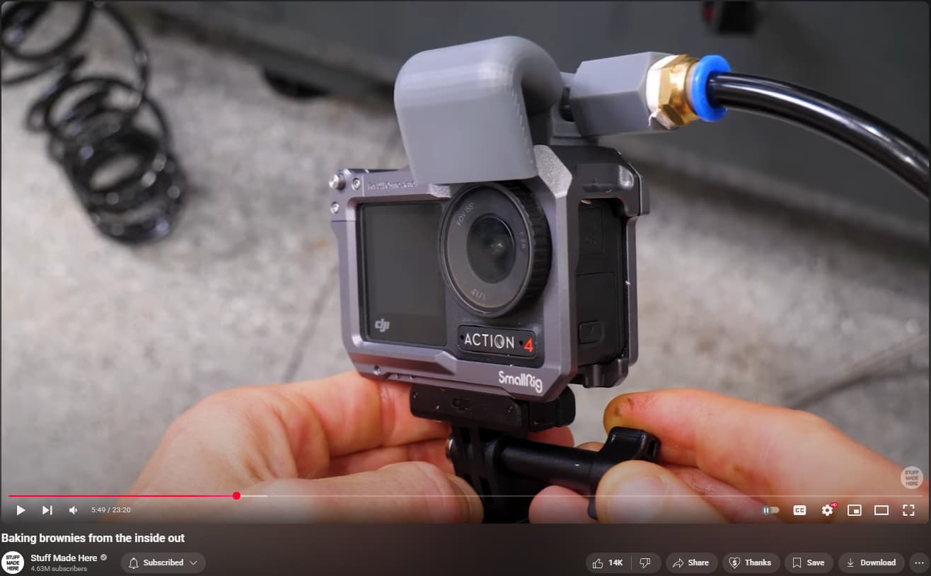

TODO: Air knife… See neat “Stuff Made Here” video @ https://www.youtube.com/watch?v=dXIkUkwzTQU&t=340s

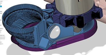

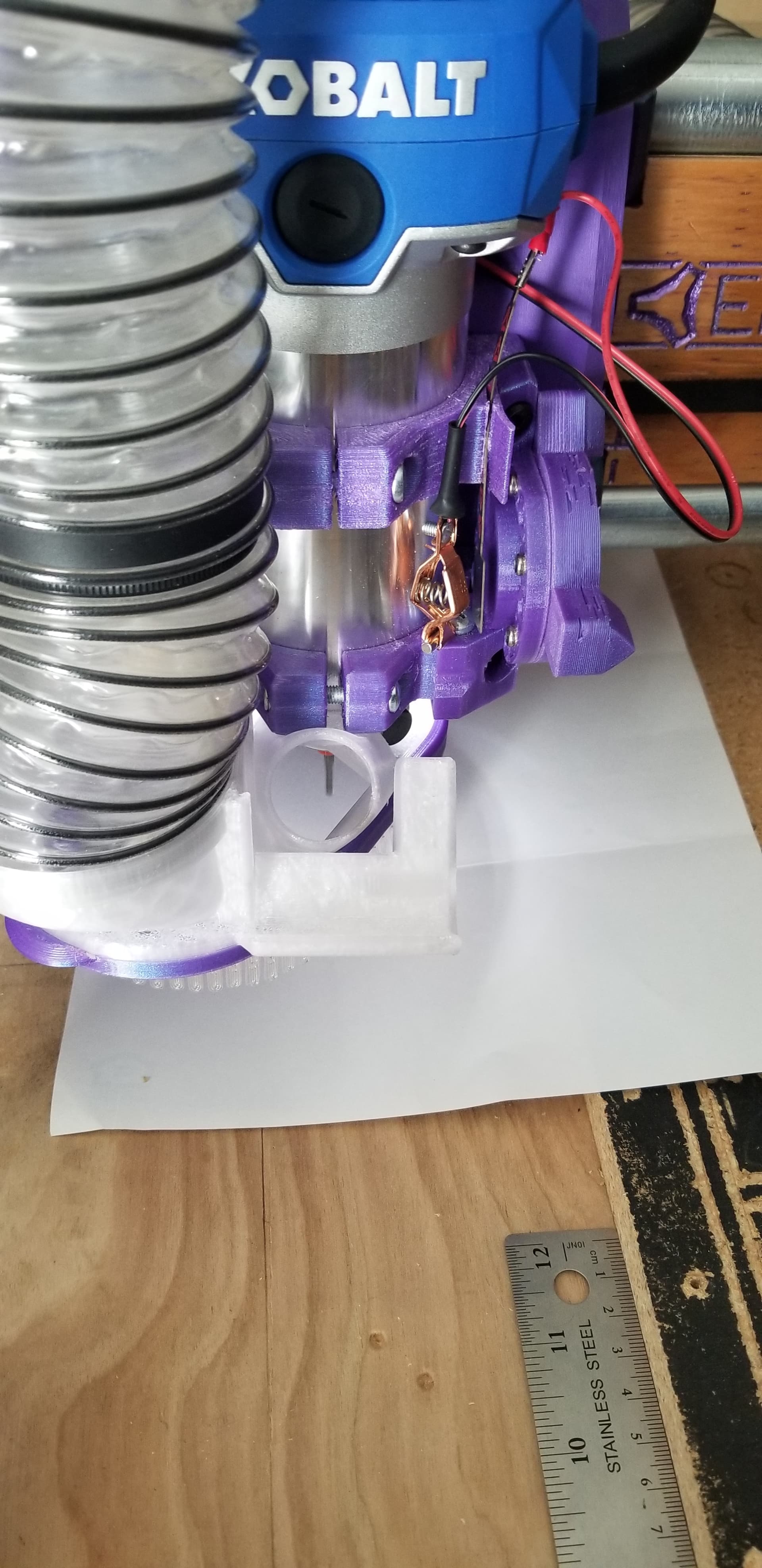

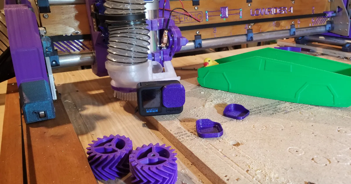

Shared Kobalt Dust shoe mod I’ve been using for a bit… (no air knife…)
Features:
  • This remixed Dust shoe is compatible with the original dust skirt and TPU Bristles.
  • Can see the cut, mister and chips flying left towards the Vac hose. Vision on right side is bit restricted so we could reuse existing dust skirt and bristles.
  • Can easily inspect/view the router bit while standing up, even without a Camera being used. No more bending over or neck strain while watching long jobs…
  • GoPro Camera compatible, recommend macro lens able to focus at 8cm (e.g. https://www.amazon.com/dp/B0C9GTKLF9 ). Just rest Camera on the mount, no need to bolt or strap easy to remove.
  • Includes wedge mount, mount holes and generous ledge enabling other Cameras to be mounted. I’ve not made any adapters, hopefully others will.
  • Rounded finger friendly profile enables easy fast fumbling for the spindle lock.
  • Includes mount to precise placement of air/coolant mister mount even if dust skirt is attached.
  • Increased material for secure mount to router clamp.
  • Kobalt router has LEDs, so I’ve tried to minimize thickness of material enabling maximum light to shine through when using transparent filament.
