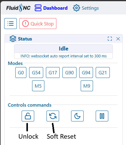

Here’s a screenshot on WebUI v3.
Unlock executes the $Alarm/Disable command (short command is $X). It tries to clear the alarm.
Soft Reset is a realtime ASCII command.
Also note that how you handle an alarm depends on what the alarm is.
Also, I just checked, my FluidTouch pendant does a soft reset, followed by an unlock to clear an alarm.
