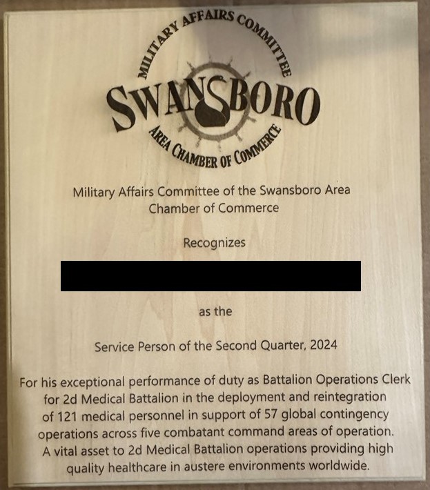

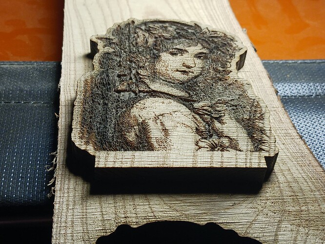

I just received an Atezr P20 Plus, and I must say, I really really like it so far. I had played around with the Cenzo JL1 a bit, and made a few things with it, but I need to get David’s “lift mechanism” installed on it so I can do a better job focusing it ( I have learned so much on laser capabilities over the last week or so while waiting on the Atezr. I have plans to put it in a DIY enclosure with what is hopefully a pretty good extraction system. Time will tell on that. I have only done a few tests with it, and did an engraving on Basswood for a friend of mine who was in a pinch as his Omtech went on the fritz (he’s waiting on a new control board for it) and has a plaque due out on Monday. I think it came out pretty good:
Can’t wait to get the enclosure done so I can really start to cook with this thing!! But first I have to finish my table saw outfeed table that will double for the table for my LR3. Too much to do and not enought time to do it. This whole W.O.R.K. thing keeps getting in the way of my fun time!! HA!!

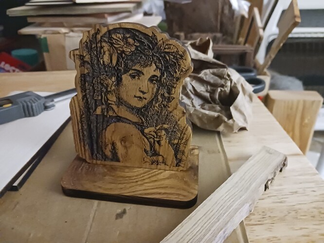

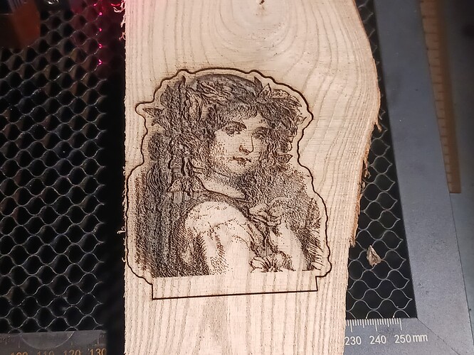

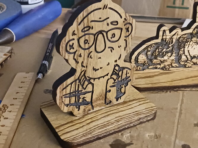

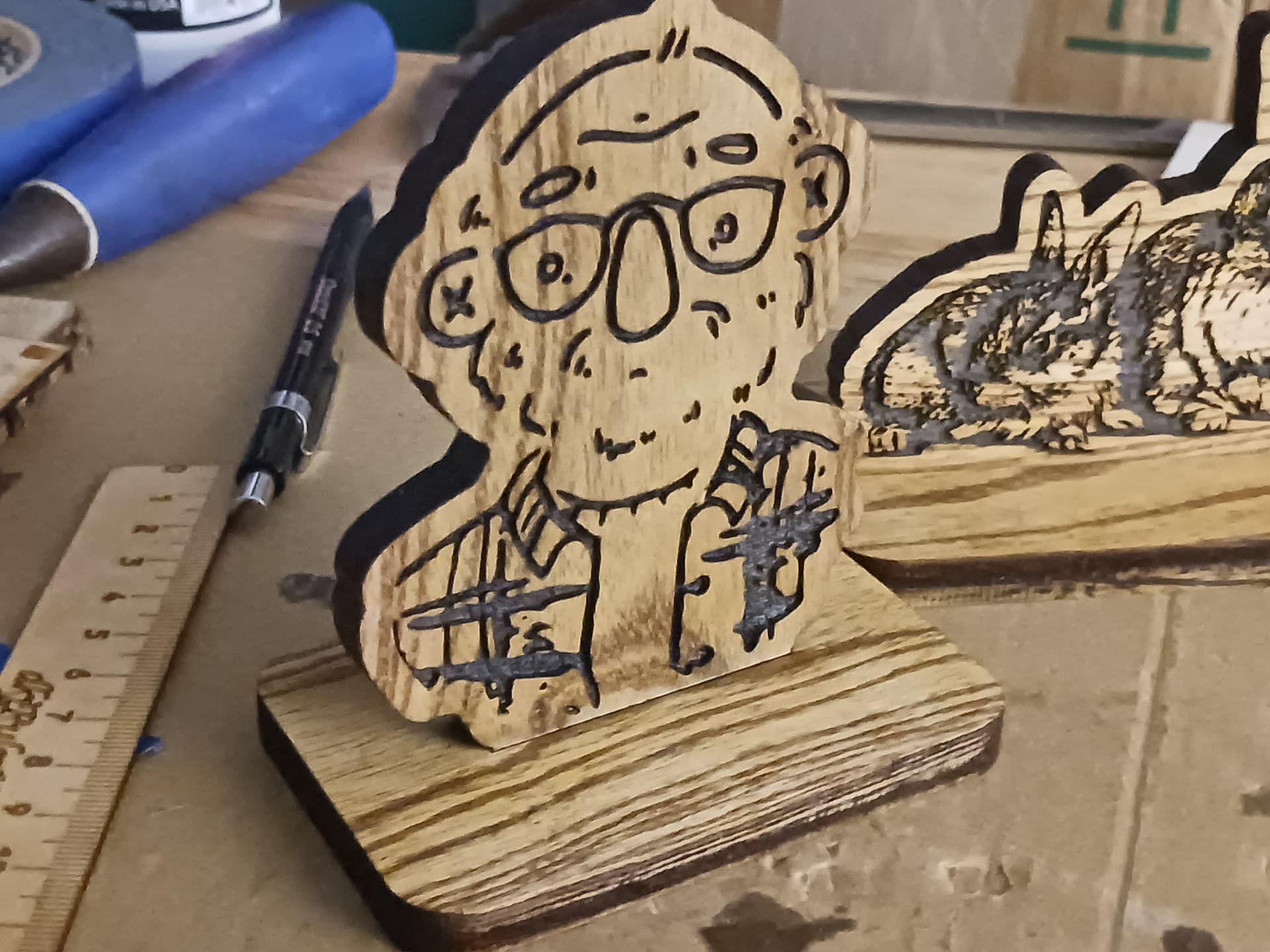

Nothing major… Just piddlin’ around and eye-balling several extra catalpa planks (from my knick-knack box projects)… and wondering what I might do with them. With super-manly effort, I finally came up with a few test pieces to run past my kids and grandkids…
This was an all-Lightburn and -laser project… and ~9mm thick planks of catalpa. I was pretty proud of myself, coming up with the idea of using the profile cuts… and had in mind it being a way to show off my grand-daughter’s caricatures, ala the old man piece (me!). While the kids all thought it was “nice”… they seemed to think it might be more suitable for a custom nativity setting. TBH I like my idea better. I just need to “steal” a few more drawings from my grandkids…

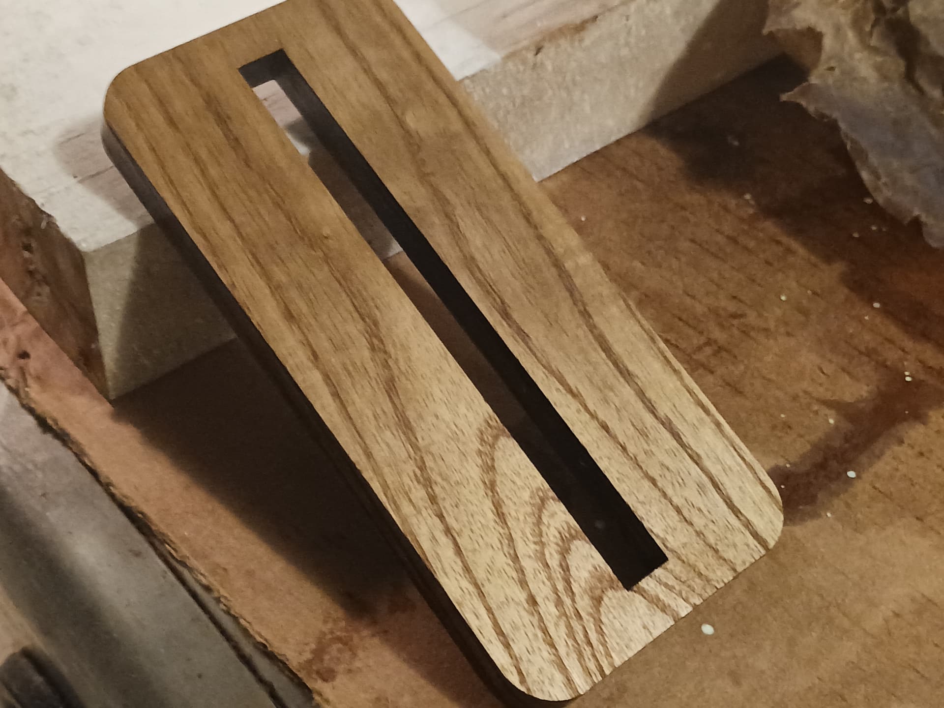

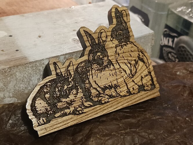

It turns out that catalpa laser cuts beautifully. These cuts are made with 10 passes at 2000 mm/min and 100% power with my 36W (optical output) Atezr laser… and there’s no hint of charring or burning. All those nice tight box joints I did were with those same settings.

Thanks. It’s a bit deceptive… recognize that you can make 10 passes at 2000 mm/min (10x) the speed in about the same time it would take to make a single pass at 200 mm/min. And the beauty of making more and faster passes is the beam is not lingering in a small-ish area as long… and prevents the burning and charring associated with going slower. Also, the through-cuts are all relatively simple profile cuts that really don’t take long anyway… compared to the engraving.
Oh, and you really don’t want the jobs to take so little time it doesn’t let you get settled into the recliner to rest from your labors for a bit.
