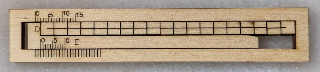

I also played a bit with the laser kerf… there’s still a tiny amount of slop before glue-up but it’s not too bad. Right now I’m using 0.07 mm – 1.4 mm / 20 cuts, shown here…

Where did you get that kerf measuring ruler design?
Dang! I knew you were gonna ask that…
I got it from the Lightburn forum somewhere
Ah, here it is…
It’s very small and quite fiddly for these old, shaky, fingers but a pretty slick idea anyway…
– David

I saw in a YouTube video recently a much simpler, easier way to measure kerf, providing you have an accurate set of calipers. It involved cutting out a square, and measuring the inside width of the hole, and the outside width of the cut square, and subtracting the former from the latter and dividing by two.
The method shown looks like it could be more accurate, but also some users in the LB thread mentioned the small cut pieces falling out through the honeycomb, etc.
