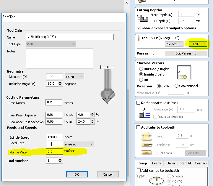

For the rapid Z plunge rate, according to the Aspire site, “By default, the Plunge gap is set to the same value as the Clearance gap, which means that there will be no rapid plunges.” I have my base plunge set at 3mm/s, which shouldn’t be changing.
Would the rapid rate reverse the Z-axis? That was the main issue I saw: instead of raising to 3mm above the material, it plunged.
Zip and post your gcode, I can tell you exactly what is happening with your speeds.
Plunge rates are down into the material, rapids are out of it in the Z. XY rapids are all non cutting moves. Most all programs link the XYand Z rapids. We un-link them because we use different gear ratios.
The speed for plunge is in the tool selection menu, near the top when you’re adding/editing the toolpath, and using edit will let you alter the value for that specific cut. Please post a picture of that, instead of the material setup. I use aspire on a daily basis with my mpcnc, so I’m sure we’ll figure it out.
I’ve attached a photo if you need help finding it, ignore the feed rates for x/y, it’s for another machine.
Yeah, my rates aren’t really any different, other than a significantly smaller pass depth and feed rate.
Here’s what mine are set at:
If at any point that tries to move the Z at 20mm/sec it’ll fail with those types of symptoms.
It never tried to move 20mm/s on the Z… but I think it did move the Z 20mm in the wrong direction.
