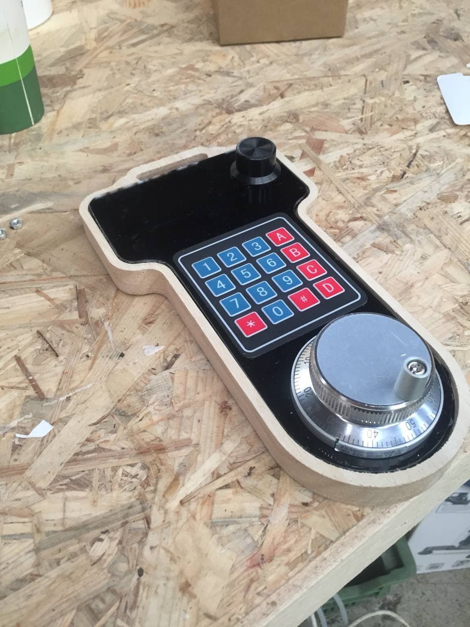

I have created myself a pendent using a encoder handwheel, Lcd, poti for feed rate, menbrane switch matrix and an arduino Nano.
I run it on a lowrider with a ramps board connected to the serial 1 port pins on the ramps Zmax and Zmin,
It works perfectly when I use it for setting up jobs, but when I use octoprint it is causing issues, the job stops and says too many errors, or somelike that… I’m not at the work shop…
Furthermore, I set up out the job with the pendant, place it in its holder and start the job with octoprint that is running on a raspberry pi 4. When the pendant is not connected it works fine.
my arduino code only sends data after an event, so I not sure why its happening…
any ideas??
in the marlin setup of have enable both ports.
