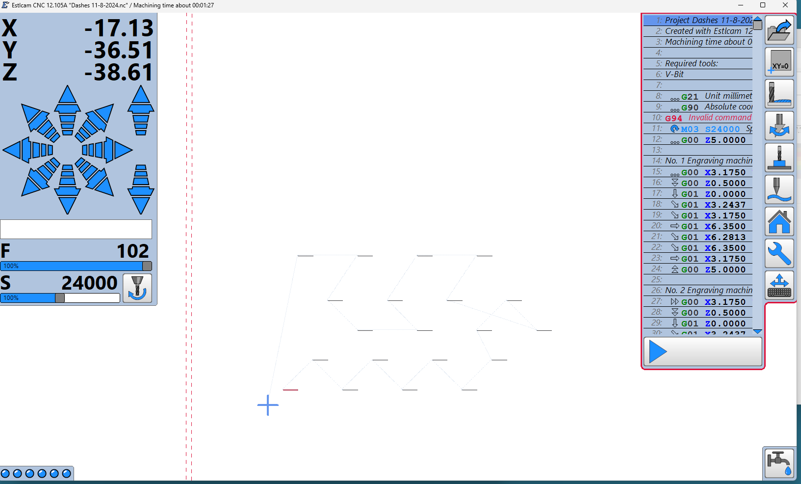

Thanks, got it. Here’s a simple engraving, just a bunch of short lines. I set up my logic analyser to watch the Arduino pins 7, 8, 11, 13, and A3 and it’s clear that I can connect to pins 7 and 13 to operate a relay. The screen shot shows pin 7 toggling as the CNC program runs, and pin 13 toggles at the start and end of the G-code.
That last image changes things. To get that image you have to have installed the Estlcam firmware which means you are not using GRBL. Since you also said you are using a Nano (my bad for not noticing that earlier), there is no reason to use anything GRBL. The only reason to use the GRBL compatible pinout is if you are using GRBL hardware that does not allow you to use the Estlcam Arduino pinout. The only reason to use the GRBL presets for Settings Basic and PP is if you are generating GRBL compatible G-code for GRBL firmware. When using GRBL presets with Estlcam firmware you get things like that G94 Invalid Command because Estlcam firmware doesn’t need/use G94, G21, G90, etc.
If you do not want to rewire your Nano to the Estlcam pinout, you should at least change your Settings Basic and PP to Estlcam presets. When using the GRBL compatible pinout you only have one available Output (Estlcam pinout has two Outputs, pins 02 and 03) and that is pin A3/Output 1 (Controller : Outputs). You can name that output solenoid and use solenoid on/off commands (per above image) or M08/M09 (…clicking that bottom-right spigot icon will also turn it on/off).
The easiest way to use that output to pneumatically extend/retract the spindle at the start/end of the cut is to define/use a Laser tool (bottom right tool) and add your on/off commands to Controller : Texts Laser before/after Z down/up (per above image)… The only Laser tool settings that matter (for center-of-the-line Engraving) are depth per pass, feedrate’s and spindle RPM. Nothing else matters, e.g. Tool diameter can be whatever you want, it has zero effect on the G-code… The importance of the Z settings depends on how fast the pneumatic Z is, i.e. does the spindle reach the set depth before the cut starts or is a slower feedrate needed to slow the program down/give Z more time… example G-code:
