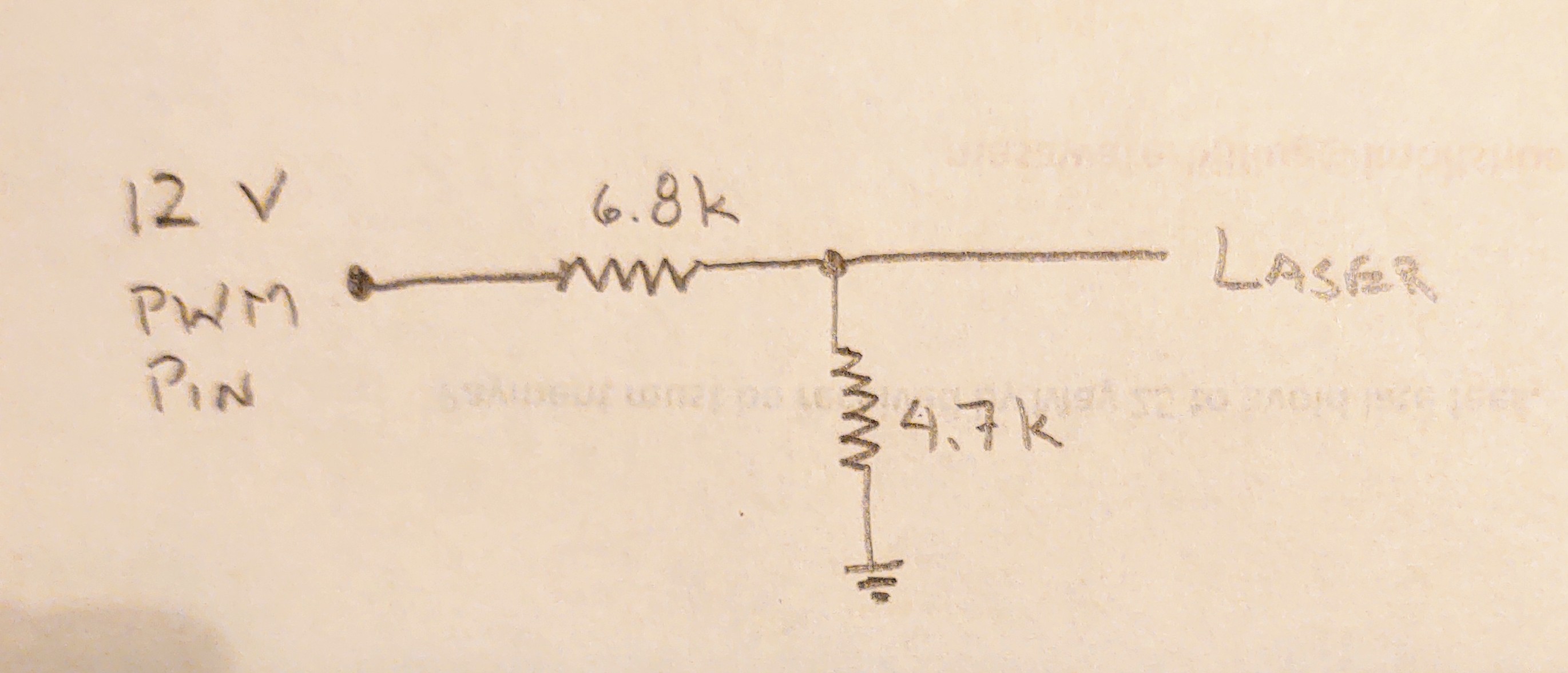

I think we could probably work out a circuit to use the 12V fan output. I would have to look at the schematic and see how it is gated, but if you have a variety of resistors, we could make something that would be close.
Or, you could just keep using pin53 and only have 100% or 0% power.
I am not comfortable enough with my electrical engineering skills to attempt such a task, though if it turns out that this board doesn’t have a pin that could be used for this, I would be interested to know if there was a good premade 12v to 5v step down that worked with PWM. I found dozens listed on various import sites, but I am not knowledgable enough to know what I actually need.
Any reason a simple voltage divider wouldn’t work?
Unless my math is wrong, this should drop the 0-12V PWM output to 0-4.9V.
470 Ohms and 680 Ohms would do the same, but draw more current on the Archim pin, like wise 47k and 68k would produce the same voltage output, but draw less.
I bet it would get very close.
But the 12V is from the power supply, and it is switched on the low side. But the low side also drives an led. I don’t think the led would matter, but I remember having trouble with it when I tried something similar before.

Hmm, that would make the voltage divider an unsafe option…
The level converter looks like a good solution.
Yeah. Now I remember, the gnd is tied to 12V through an led. So when it floats, you get 12V on gnd.
