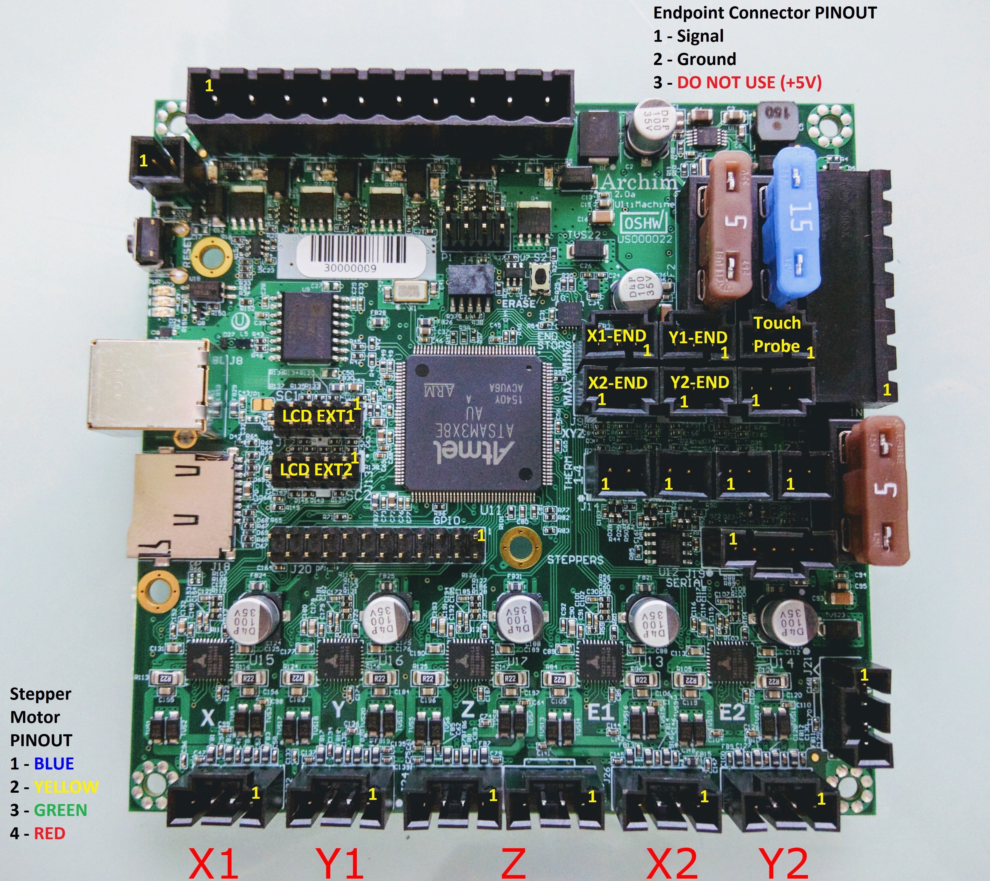

ARCHIM 1.0a connector pinouts - updated picture
I took Ryan’s picture of the ARCHIM board and added the location of PIN 1 on all the connectors on the board.
Particularly important for the dual-endstops as the upper row of connectors are swapped compared to the lower row of connectors.
I couldn’t find this info on the ARCHIM wiki, but used the ARCHIM github site and found the schematics included board artwork for the later versions.
Here is my markup for the ARCHIM 1.0a:

This is helpful, thanks!
One thing which isn’t clear to me is the appropriate setup for when using the series winding harness included in https://shop.v1engineering.com/collections/lowrider-parts/products/lowrider-cnc-bundle. Or should that harness be avoided altogether with the Archim 1.0a?
