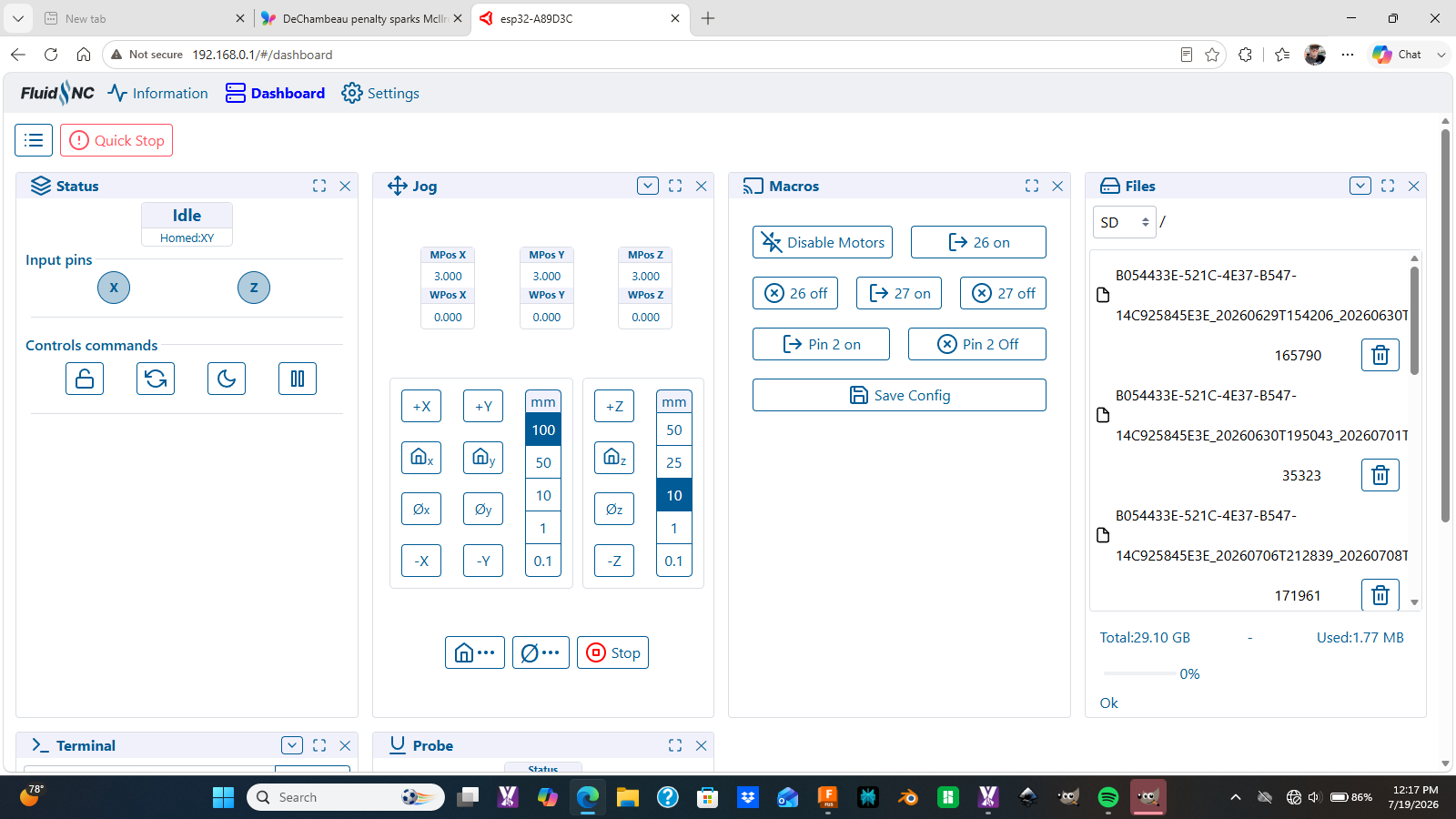

Please I thought I solved but as I said previously I really don’t understand how the FluidNC software works for connection to my Jackpot controller. I recently switched to a new Jackpot 3.

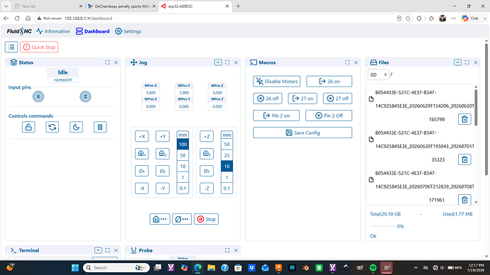

Step 1: I connect to FluidNC SSID:
Step 2: I switch to 192.168.0.1
Step 3: I verify I’m connected by homing and moving around

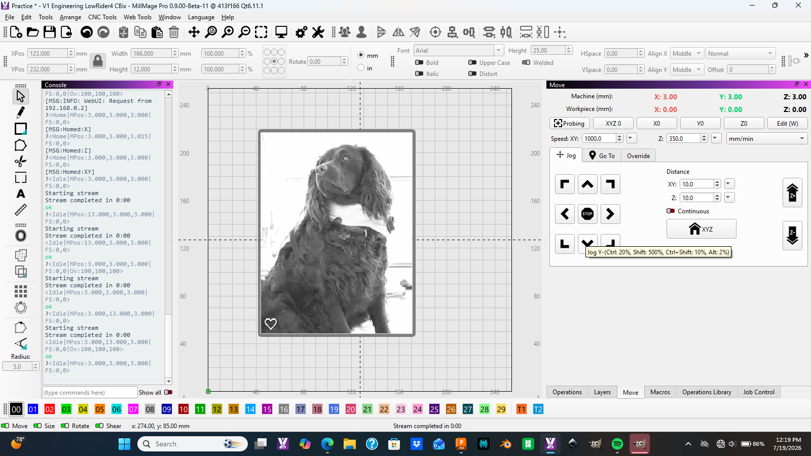

Step 4: I then open MillMage
So at this point I take over and take control. Re-home to verify.
Then I start a job and chances are after a few minutes of running I randomly loose connection! Frustrating!!
Not sure what setting I need to change?
Note: I keep the browser active and connected to the FluidNC. I’ve also closed out once connected but not sure what is correct.
I have uploaded the gcode to the SD card and can run but really want to run and control via MillMage which I am really loving.
Anyway THANKS.
If you are connecting MillMage over wifi, you shouldn’t have your browser connected to Fluidnc also. Use one or the other because they can conflict with each other while running a job.
I use USB to connect to MillMage. If you do that you can have your browser connected too.

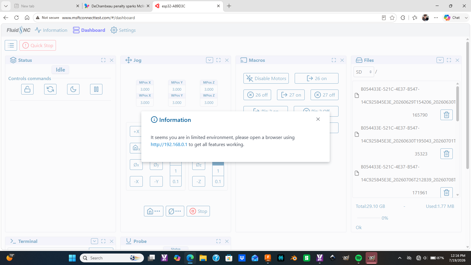

You are using FluidNC in Acces Point mode. This way, Windows connects directly to the WiFi of the esp. Since it doesn’t have internet access, Windows might be dropping the connection at some point.
If you have WiFi router at your shop, follow these instructions to connect the controller to the existing WiFi:
I tried connecting in MillMage over the hostname fluidnc.local, but there seems to be an issue that I’ll investigate.
However, using the IP address of the controller does work.
Your WiFi router might give the controller a different IP at some point. It’s a good idea to set up a static IP in the router’s admin panel.

AP mode should not be used, except for setup and recovery. In the link above, the FluidNC devs specifically say that it does not work well for day to day usage.
Connect the controller to your xFinity router’s WiFi and you should be golden. (If you have separate network SSIDs for 2.4 and 5GHz, the 2.4GHz network is usually more stable)
To ensure that the the router doesn’t assign a different IP at some point, log in to your xFinity modem and look for “DHCP” settings.
