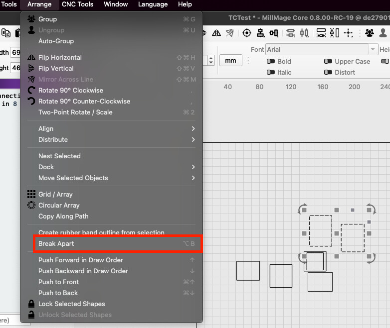

That depends a lot on what you mean by that.
From what you followed with (shapes in different operations), it sounds like you might just mean ‘Un-group.’ What Joe showed above is ‘Break Apart’, which will break shapes into all the little line and curve segments that make them - IE, a rectangle becomes 4 discrete lines.
You can do either/both. To put shapes in multiple operations would only need them to be ungrouped, or grouped into “op 1”, “shared”, and “op 2”.
