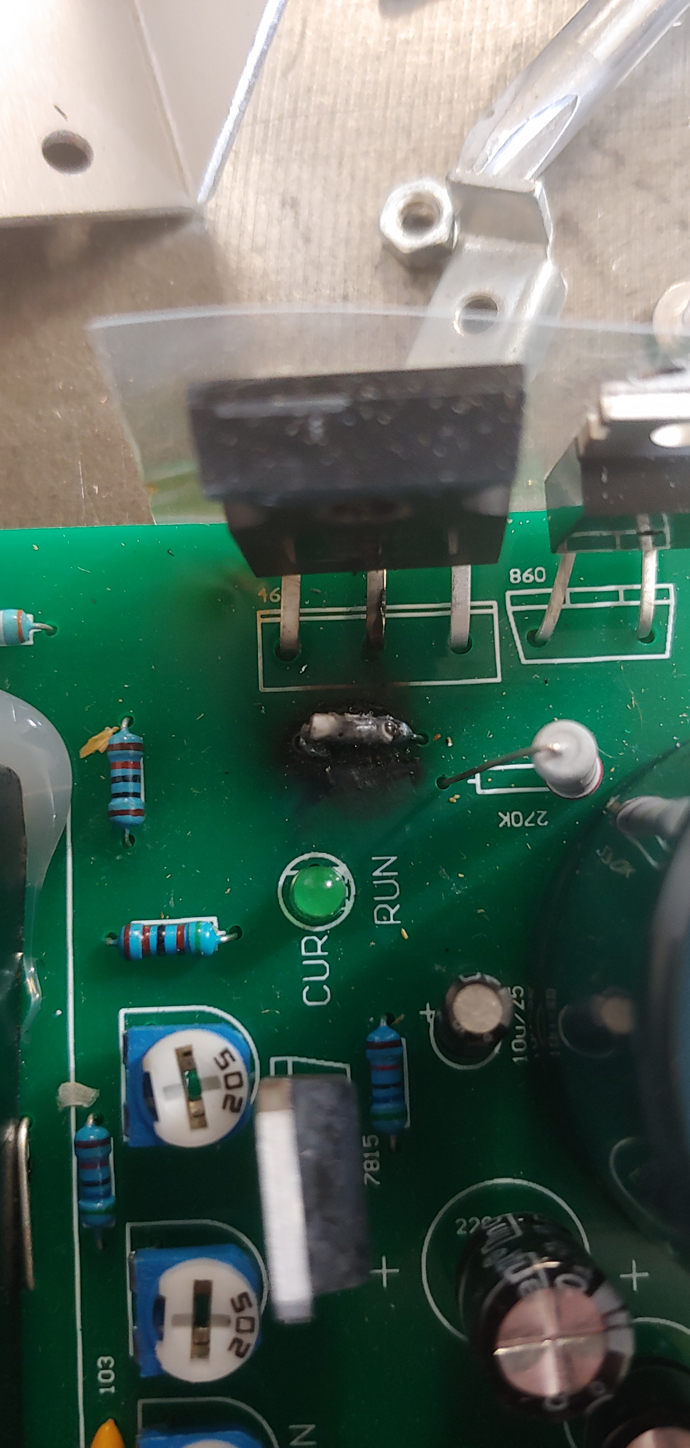

I was working on my cnc and shocked myself by touching the Z conduit. After testing continuity on all the stepper driver wires and getting nothing on any of them I decided to turn up the spindle power supply from all the way down to full to see if that was shorting. Well I heard some high pitched noises and then snap crackle pop. From looking at the board there is definitely something fried but I have no idea if it’s a resistor or diode or what values. Does anyone have one of these power supplies than can tell me what it is? I was surprised to find that these power supplies are basically as much as the bundle I got with the motor and all so I’m hoping it’s repairable.

Thanks, I’ll get that resistor replaced and hopefully nothing else got fried. And yeah I used cheap wire with silicone insulation that tears when you look at it wrong. I didn’t realize it when I bought it on Amazon. Should have new wire coming this week to replace that garbage. It’s also not 20 awg like they claim.

Is that a diode symbol on your board under that resister that burnt out on mine??? Mine is too charred to read even after I removed the old one and tried to clean it up.
No luck with replacing the resistor. It powered on fine but I got no output voltage. One of the other components must have taken a hit too. The big mosfet heat sinked to the case looks like it had an arc between the right 2 legs. I might dig through my junk pile and see if I have anything comparable to replace that with but I doubt that will make it work either.

Looks like a Diode symbol…but isn’t that a resistor Brown, Brown, Black, Brown, Green?
Yes that is a resistor which is why I’m confused.

I put in a 1.1k resistor but I guess it could very well be a 5.1k.
Also replaced the mosfet with a W12NK90Z from a PC power supply. Still not getting anything on the output rails.

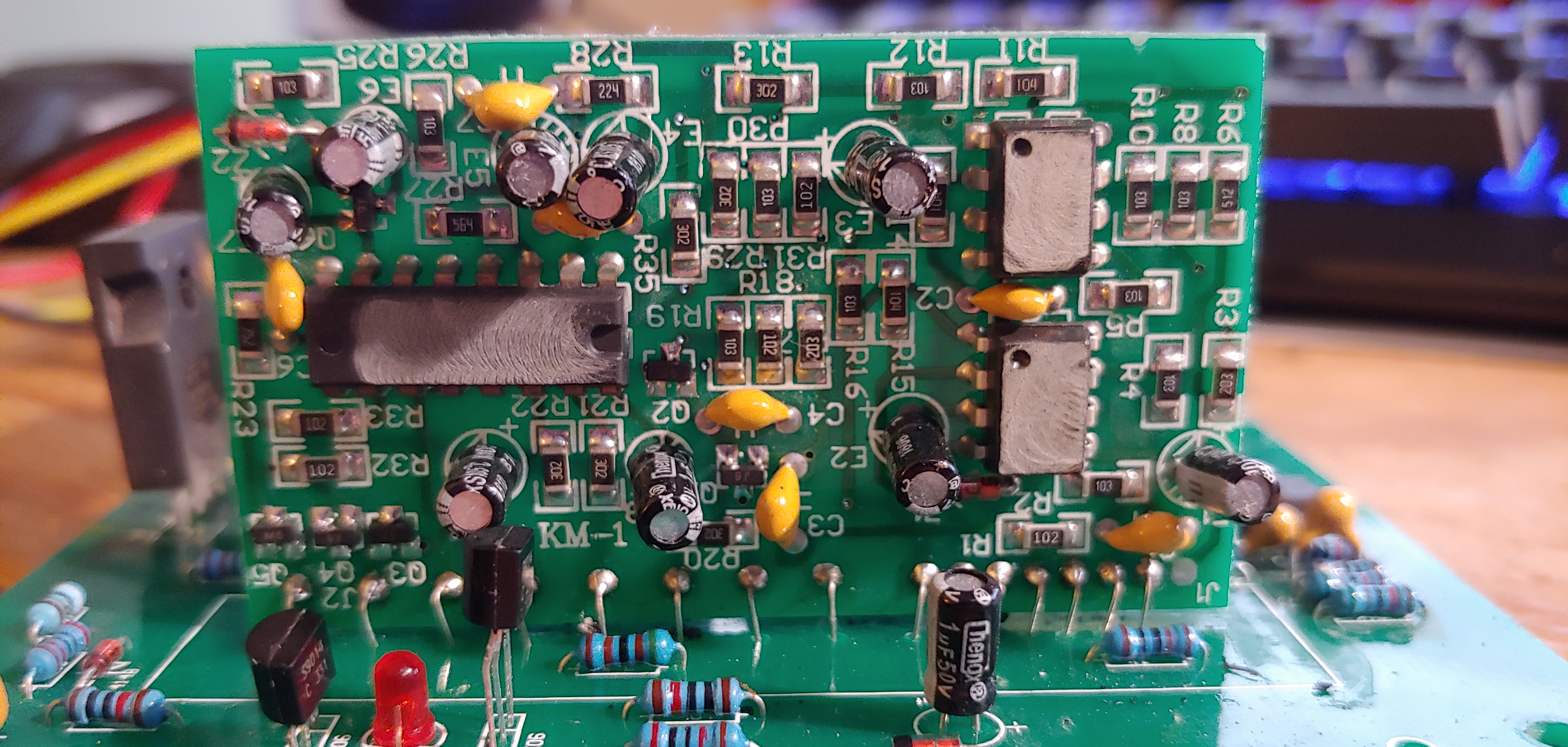

I tore apart the black box and don’t see anything in there that is obviously burnt so I guess this power supply is done for unless someone has a schematic or any ideas what else I could try.
And the fuse is OK I assume?
No, was blown but I soldered the 2 ends together and shoved it back in (don’t try that at home!)
Here’s what’s in the black plastic box for anyone interested.

It has a diode symbol and a voltage rating silk screened on the board. Since diodes can have color code bands too:
http://www.csgnetwork.com/diodecolorstable.html
it might be, if I read the chart correctly, a 1N1101E. I found a data sheet for a similarly numbered diode:
https://www.mouser.com/datasheet/2/308/FJH1101-D-1809323.pdf
with a reverse working voltage of 15V. Just guessing, but that might explain the PCB symbol and labeling.
