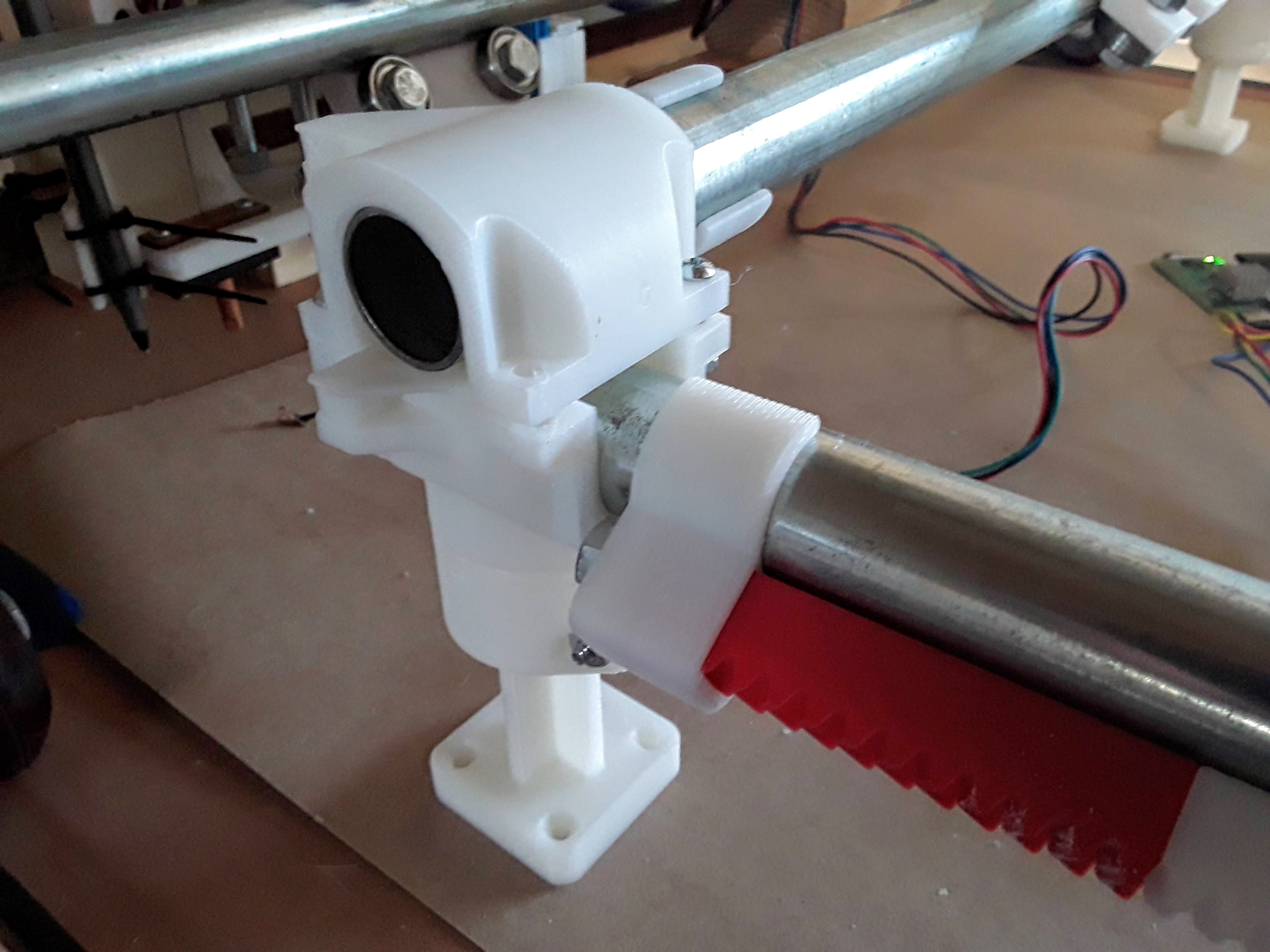

Anyone ever try printing legs in lieu of using conduit?
I don’t have a chop saw, so getting the conduit cut perfectly is a bit of a challenge. I’m printing off some legs now, but I’m just wondering if anyone has ever tried this before.

I printed legs for my R&P Burly MPCNC when I couldn’t find my tubing cutter…

As an alternate solution, create 3D printed spacers that clip to the legs between the foot and the head of the leg to standardize the height.
I use this system but take it a step further. I drilled holes below the tubing for each leg, made my legs longer, and have three sets of spacers at different heights. This allows me to keep my Z height low for most milling, but allows me to jack the height up for things like 2" foam.
I’ve done the same thing with my MPCNC @robertbu. I change the height depending on what I am trying to fit under my laser.
