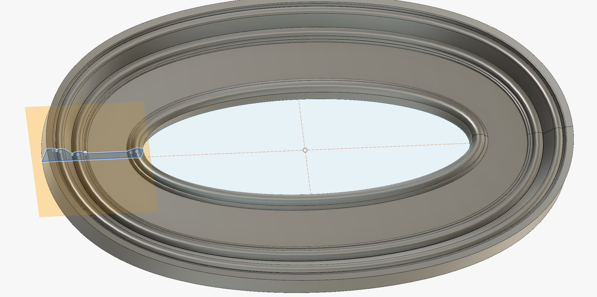

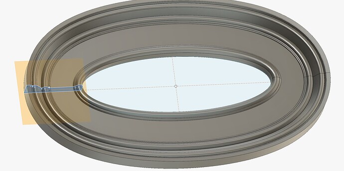

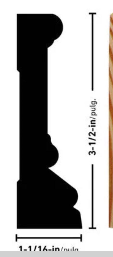

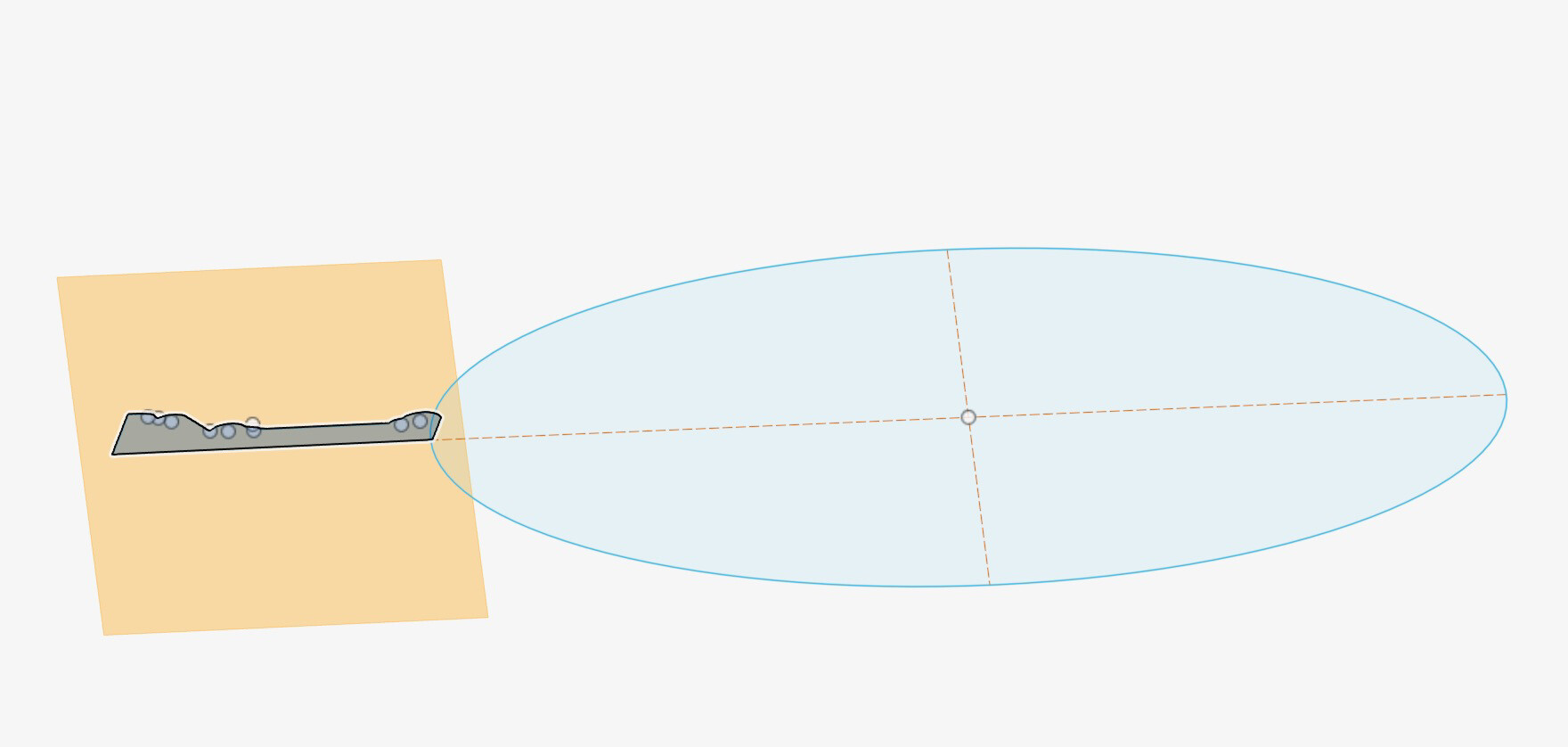

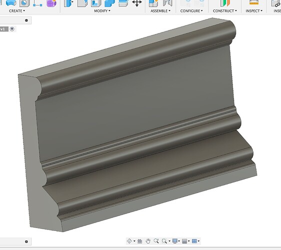

Last night I went online and searched “RB3 casing” or “Howe casing” which is the nicer profile in our house. Lots of sites have drawings of the end profile of their moldings, along with thickness & width dimensions. I grabbed a screenshot, imported as a canvas in Fusion360, and traced it out with straight lines and 3-point arcs. Once I had the profile, I created a little 6" extrusion of that shape.
Then, for grins & giggles, I created a small ellipse and (I forgot the Fusion term) extruded that along the curved path.
I’m guessing I’d need at least 3 different bits to achieve such a profile. Even if I never actually create the carving, this was a fun exercise in modeling.

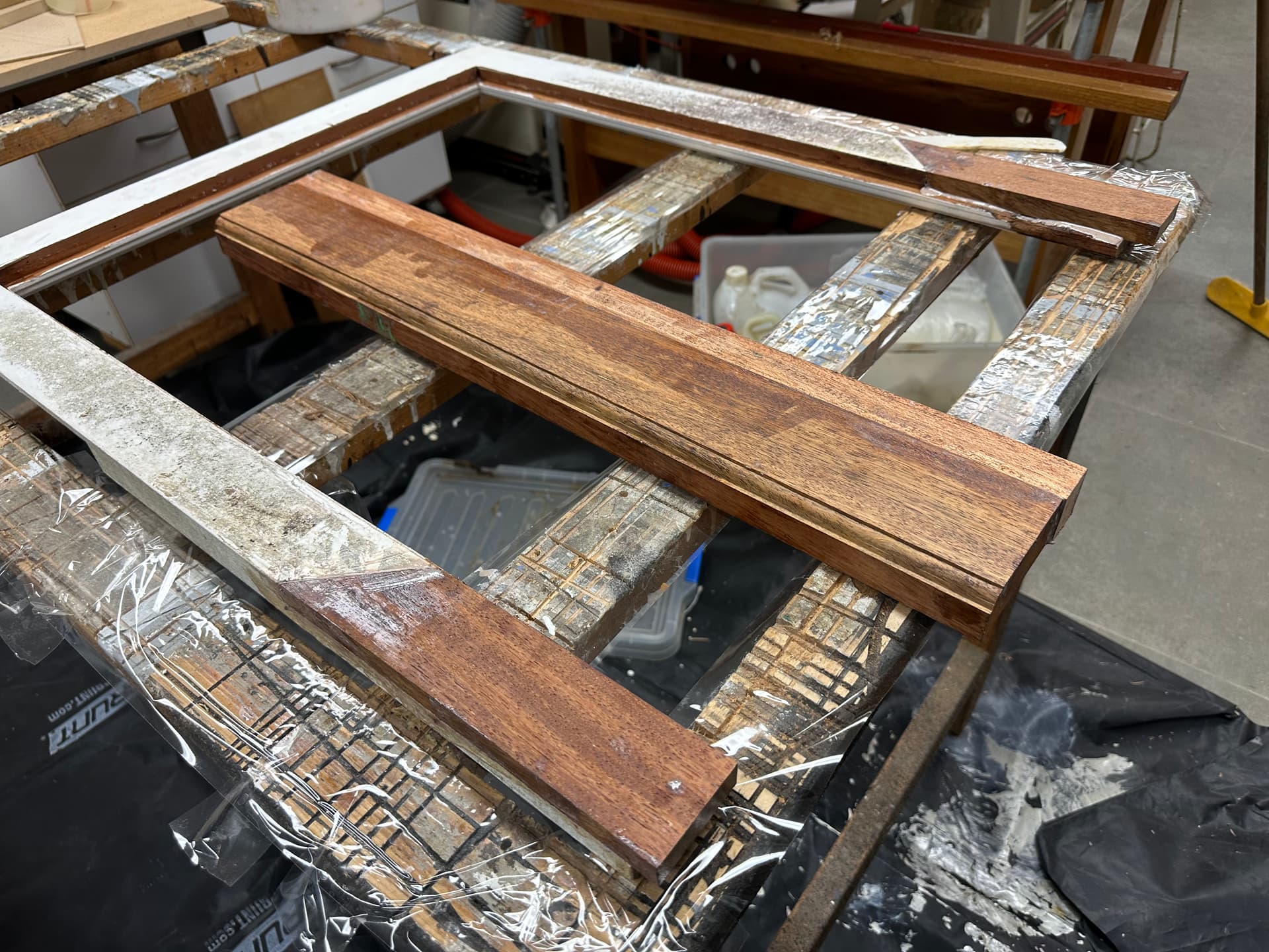

Usually I can get a close match by making pieces by routing some parts and fiddling with the table saw. The part in the first post would be five or so pieces for me! I used to keep tool steel strap so that I could make scratch stock to scrape the final profile to close enough to exact, and a lunatic mate of mine made plantation shutters for his entire house that way, all hand planed.

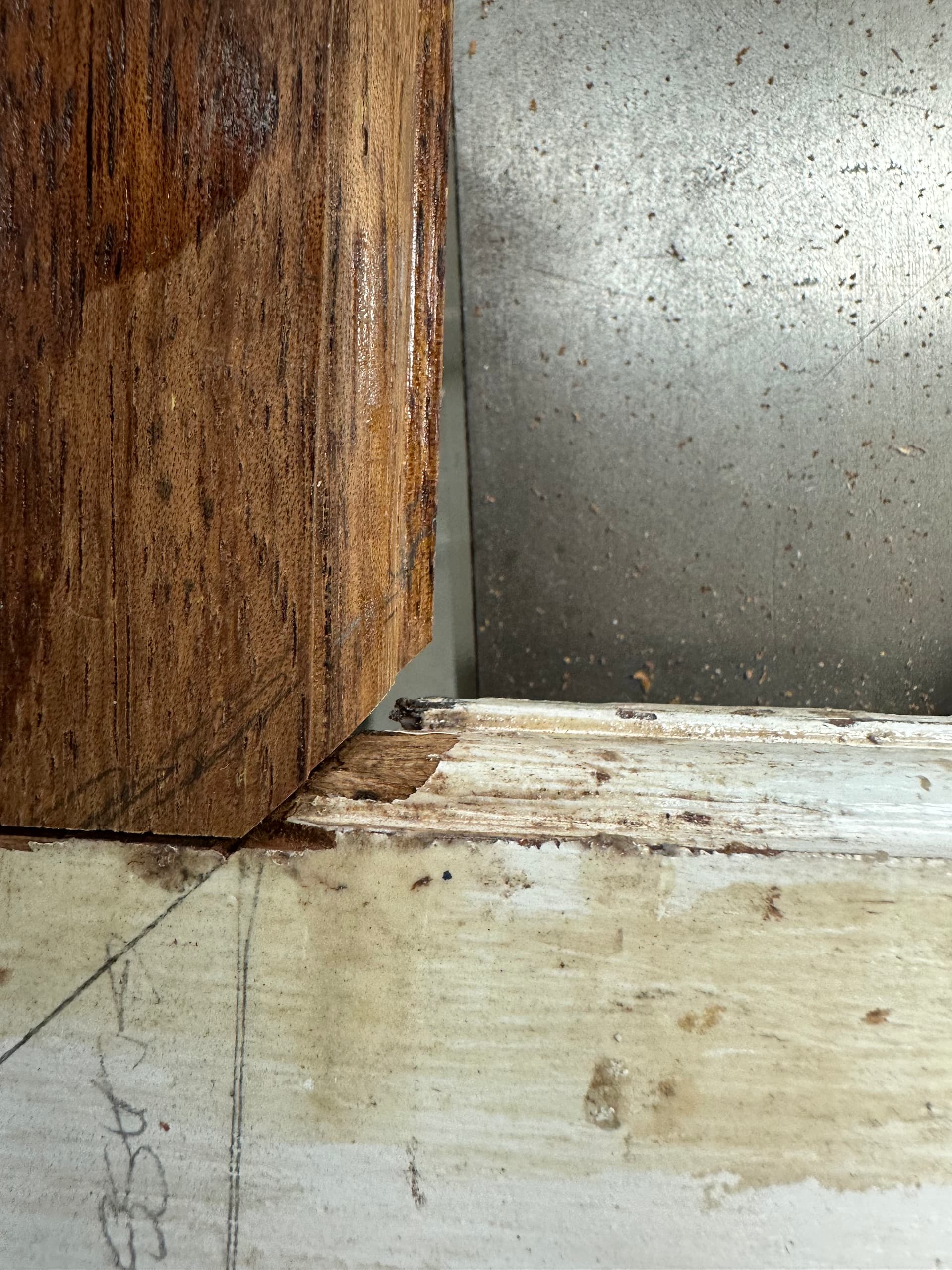

Here’s a simple project from a month or so ago - sorry no other pics than these early ones but you will have to believe me that the finished moulding was a perfect match and after priming the repair was invisible - just two saw cuts and a router to make the moulding, then a bit of hand scraping to tidy them. For the first time, I made a 3d printed male and female template so that I could gauge the exact profiles as I was going along and that worked really well.
The window was from a friend’s mother’s house - she insisted that she would be the best person to do the final painting, and at 102 years of age, how could we argue?
It may have been easier to make the whole frame from scratch, but it’s nice not to waste good timber so I cut out the rotten bottom rail, and half of the thickness of the bottom of each stile, made an approximate moulding shape (in the pics) assembled it with haunched bridle joints - mostly hand tools. It was a lot of fun, but it’s a long way from CNC stuff so I guess this is now off topic, but thanks for letting me share! :grin:

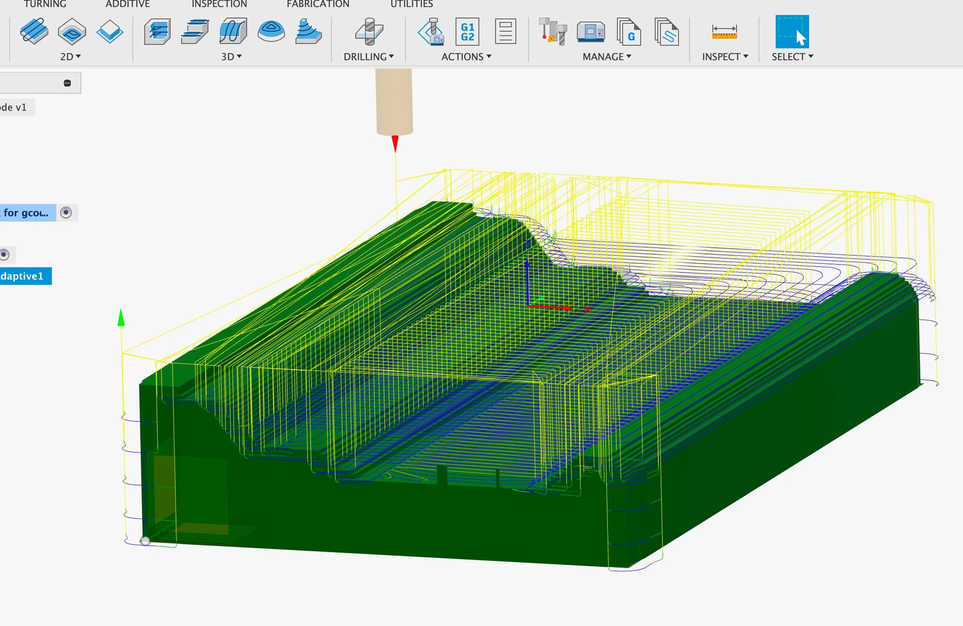

I was able to figure out how to create the toolpath in Fusion for the first bit, a 1/4" roughing bit. It’s also clear now how to create successive toolpaths for other bits, using the output of one as the input contour of the stock for the next tool.
I chose Adaptive Clearing(?) for this one, but I really don’t know which technique is best.
Here’s the result of the roughing bit toolpath in simulation. It’s still reporting a number of errors (like collisions) that I need to work out before I start spinning a physical bit, but it’s progress!

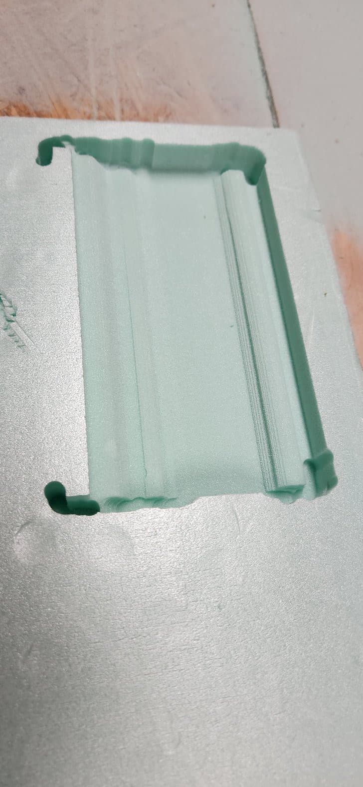

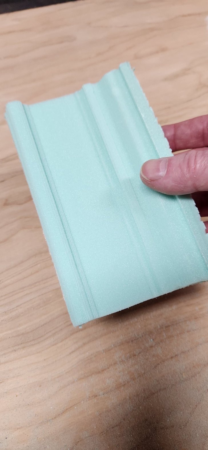

Well, I spun a bit tonight!

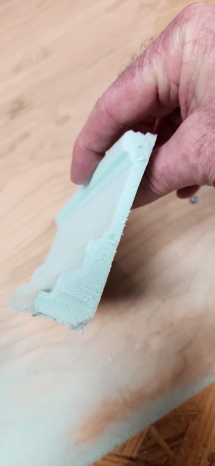

I taped down a piece of 1" rigid foam and gave my roughing pass a try. Gotta say, I’m thrilled with the results. My initial gcode was moving so slow that I bumped it up to 500% speed in the fluidd console, and this 6" piece then only took 15-20 minutes. I’ve really gotta work on my CAM settings, but the learning is what this is all about, right?
So for the results. I didn’t have an outline through-cut, so it just cut deep at the corners and did the roughing-out of all the interior space. When it finished, I used a razor knife to trim it down to the final outline.

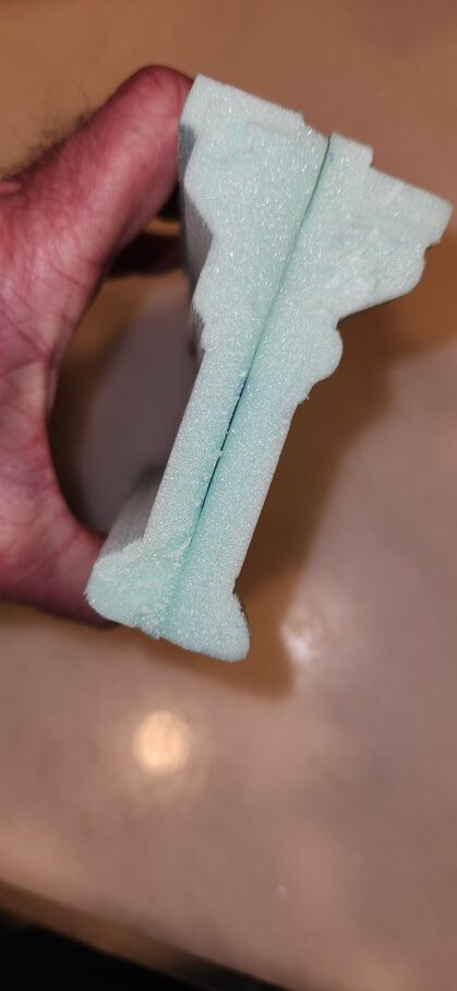

Tonight I added a second pass with 1/8" ballnose upcut and a third pass with 1/16" upcut. I could likely eliminate the 1/8" bit pass altogether. It really didn’t do a whole lot other than dig out the two valleys better. But then again, it can do it twice as fast as a 1/16", I guess.
I tried using my 30-degree V bit for the final toolpath, but Fusion was taking forever to generate it with the parameters I had set. If I could just use that to sharpen the valleys, that’s all I’d really care about. In the end, I decided that a 1/16" valley floor was good enough.

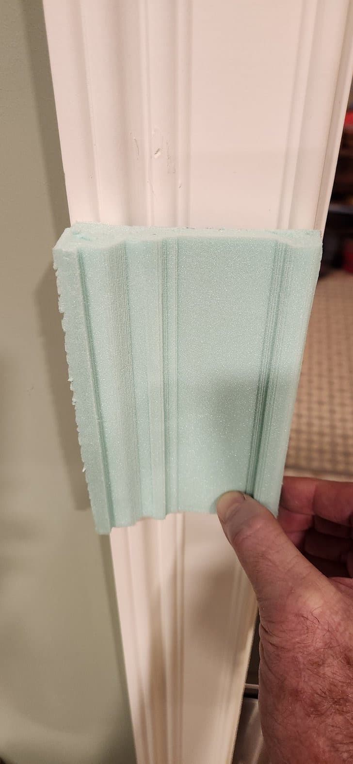

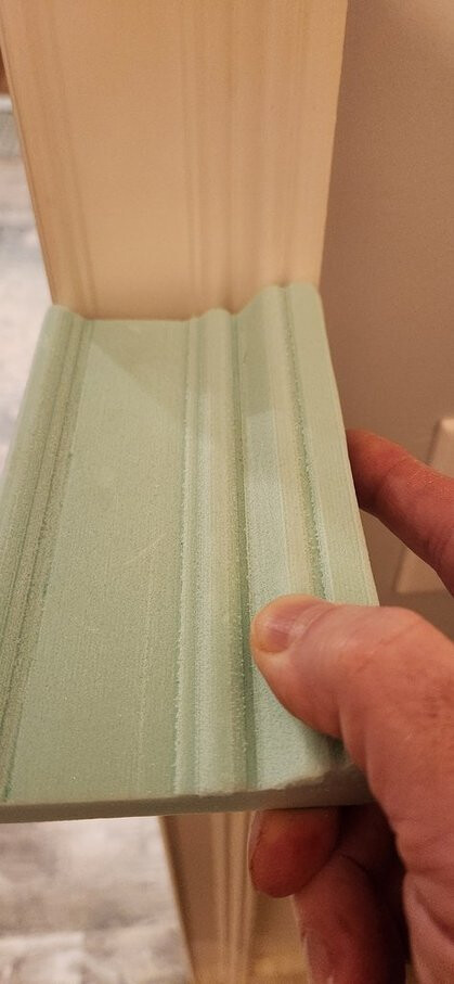

I’ve noticed that the RB3 casing in our house is a slightly different profile from the one I copied, but they’re very close anyway. As long as I’m not trying to butt or miter the two together, it would never be an issue.
(In the photos, remember that the outer edges were trimmed by hand off of the larger styrofoam sheet… ignore those irregularities!)
1/4" roughing only vs. final cut
Comparison with our existing molding
