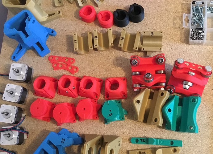

Making good progress on prints and electronics all motors working ok with the DRV8825 drivers in the initial 3 driver setup currently still on the Arduino Mega and Ramps 1.4 board - as the A4988 smoking issue doesn’t seem to have affected the other components.
Have made up some dupoint extension/splitter cables for the X and Y steppers - not sure how long to make the cables for my initial 300x300 build space as I didn’t spot cable lengths on the calculator. So may have to trim or extend them later. Initial lengths I have created are one set of 1020mm+1540mm, plus another set of 1350+2060mm (not sure whether X or Y will need the longest). The Z axis currently has only 1000mm at the moment so I presume I will have to create an extension for that too.

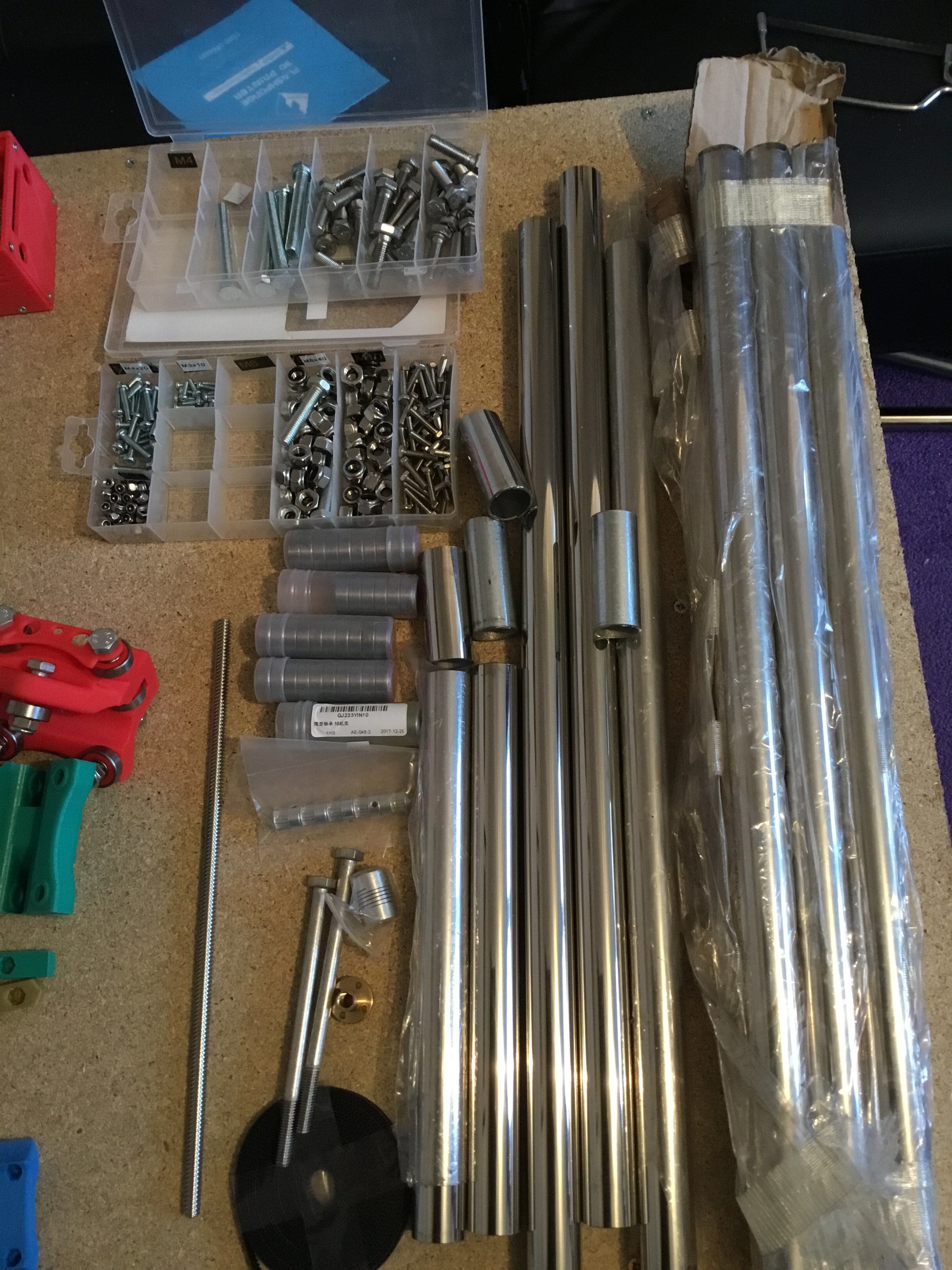

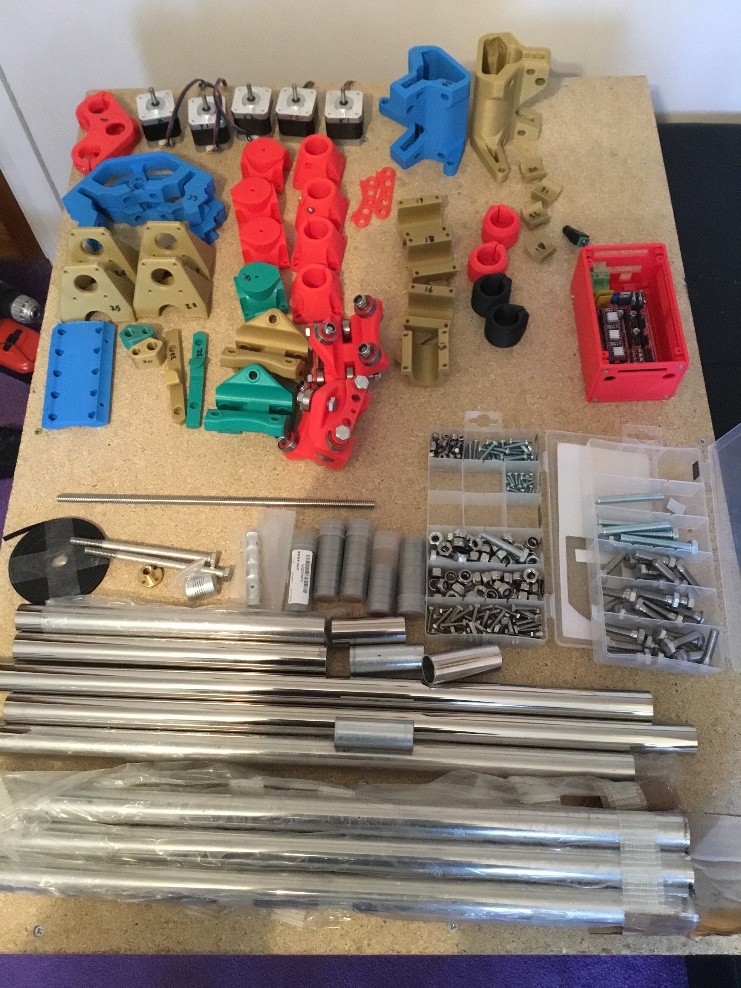

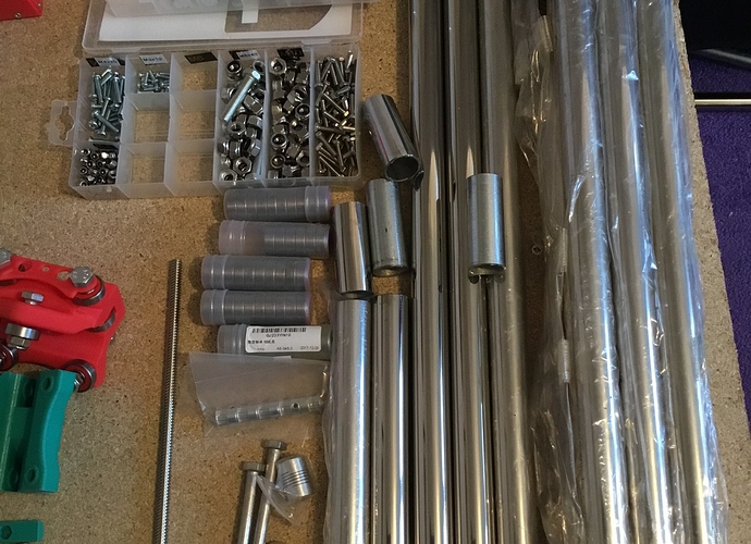

The cut pipes have arrived today from Metal Mania. Really impressed by the quality - seem to be within 0.1 mm of 25.4mm all around and cut lengths are perfect. The good/bad news is that the metal is much harder than the Screwfix conduit - so for the legs which I didn’t ask them to cut have found it really difficult cutting them (on reflection I should probably have paid the extra £15 to get them to cut all of parts). Initially tried the pipe cutter but that seem to go blunt before one cut. So tried 3d printing a measure Mitre and hacksawing them - but couldn’t really get very a straight line and have some nice blisters too. So might have to try and use an angle grinder. Or may just settle for the Screwfix 24.5 pipes for the legs as I guess the width and consistency of the very short leg pipes isn’t anywhere near as critical for the axis and they are much easier to cut.

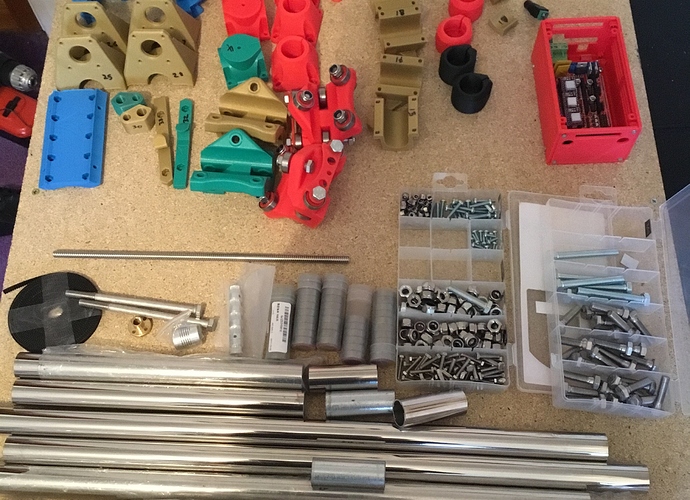

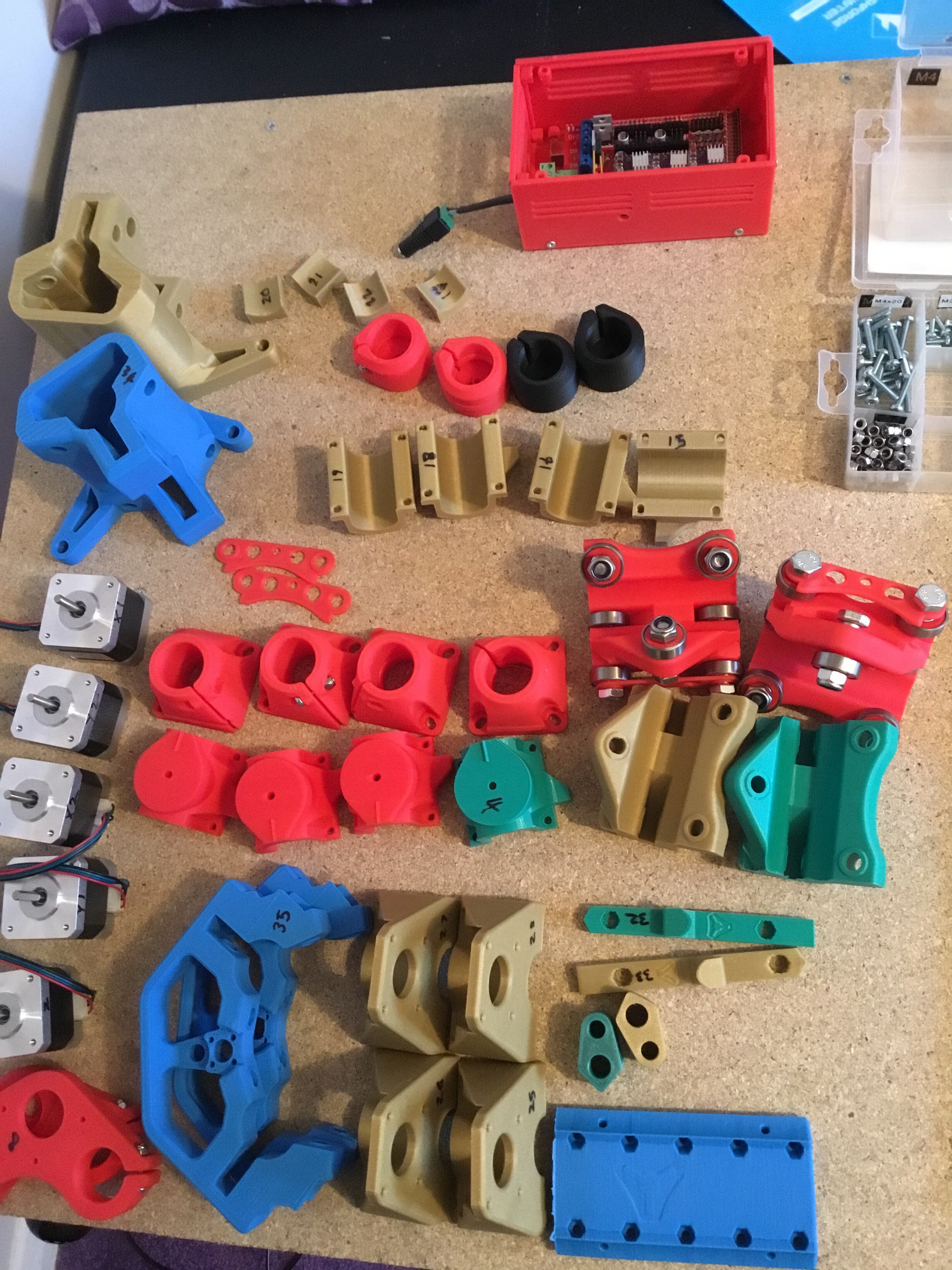

All parts now delivered - so all I need now is to do about another 30 hrs 3d printing. Even though the PRUSA MK3 seems almost faultless I don’t yet have the confidence to leave it going overnight or while I am out - so suspect this is going to take a fair few more days. I also have a Flashforge Finder that is gathering dust at the moment - so might start that printing too in parallel tomorrow to speed things along a bit.
Really enjoying the build process so far and can’t wait for the initial CNC testing.
Printing all done, table made, so the fun is about to start.

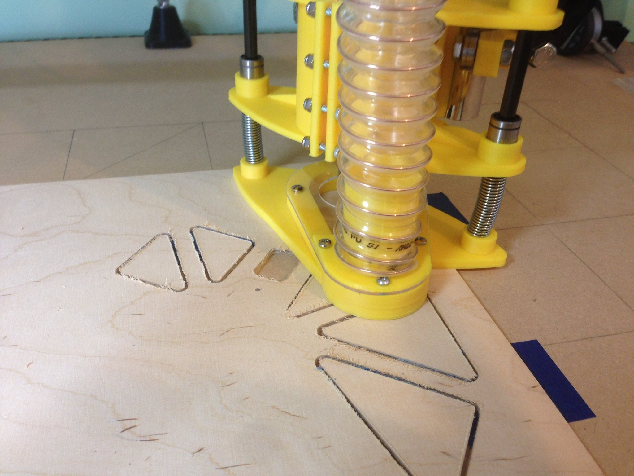

i designed my own suction foot as these CNC routers can be extremely messy.

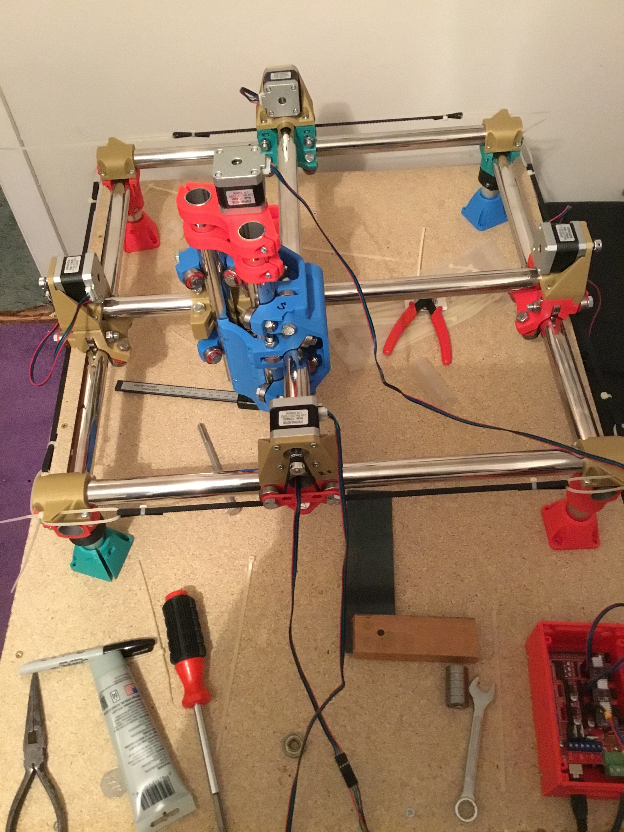

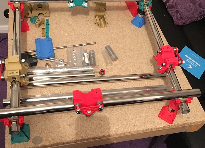

Making progress. The parts seem to fit together ok - such a fantastic design.

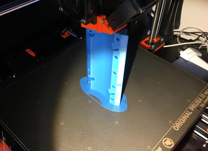

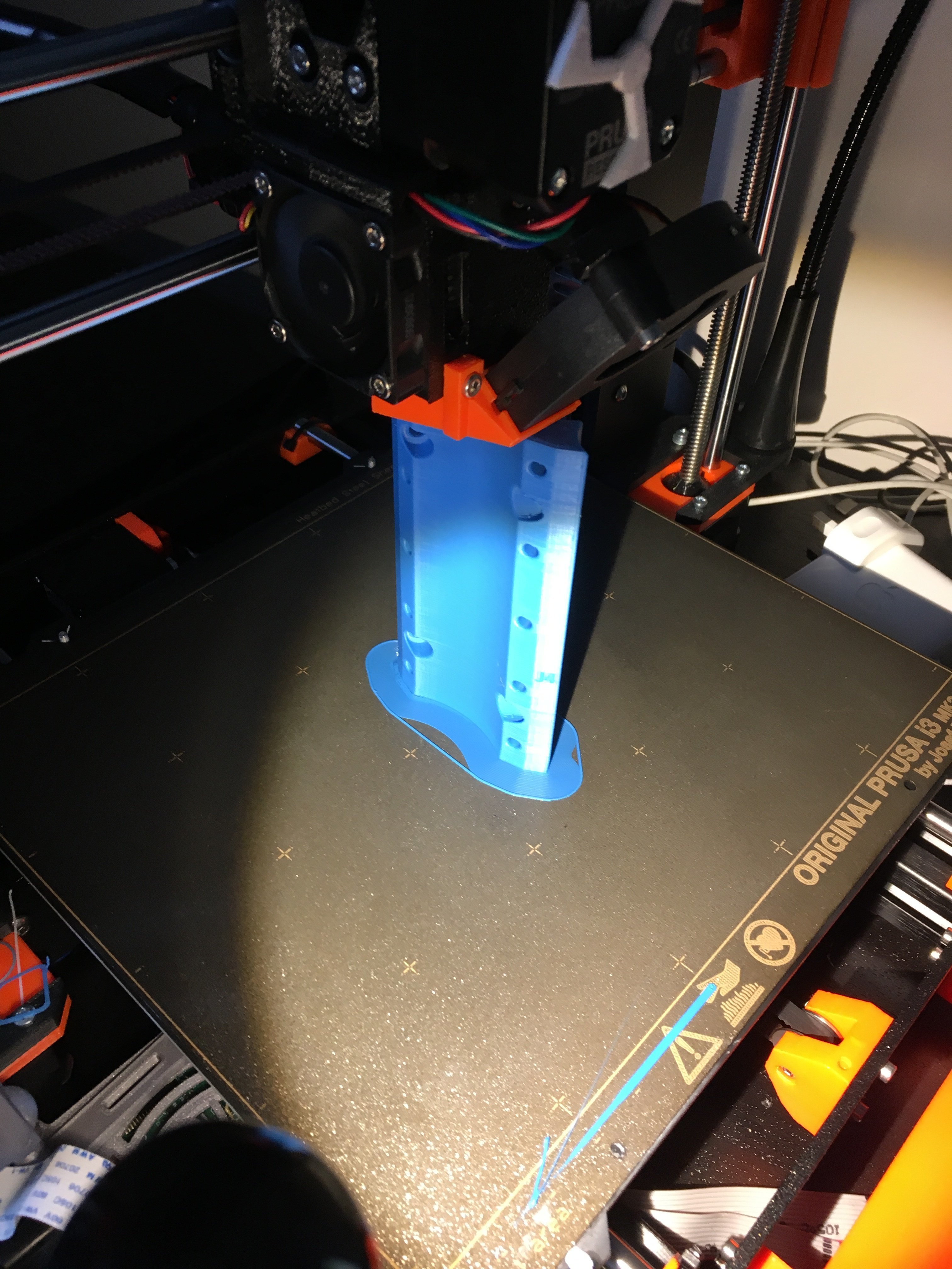

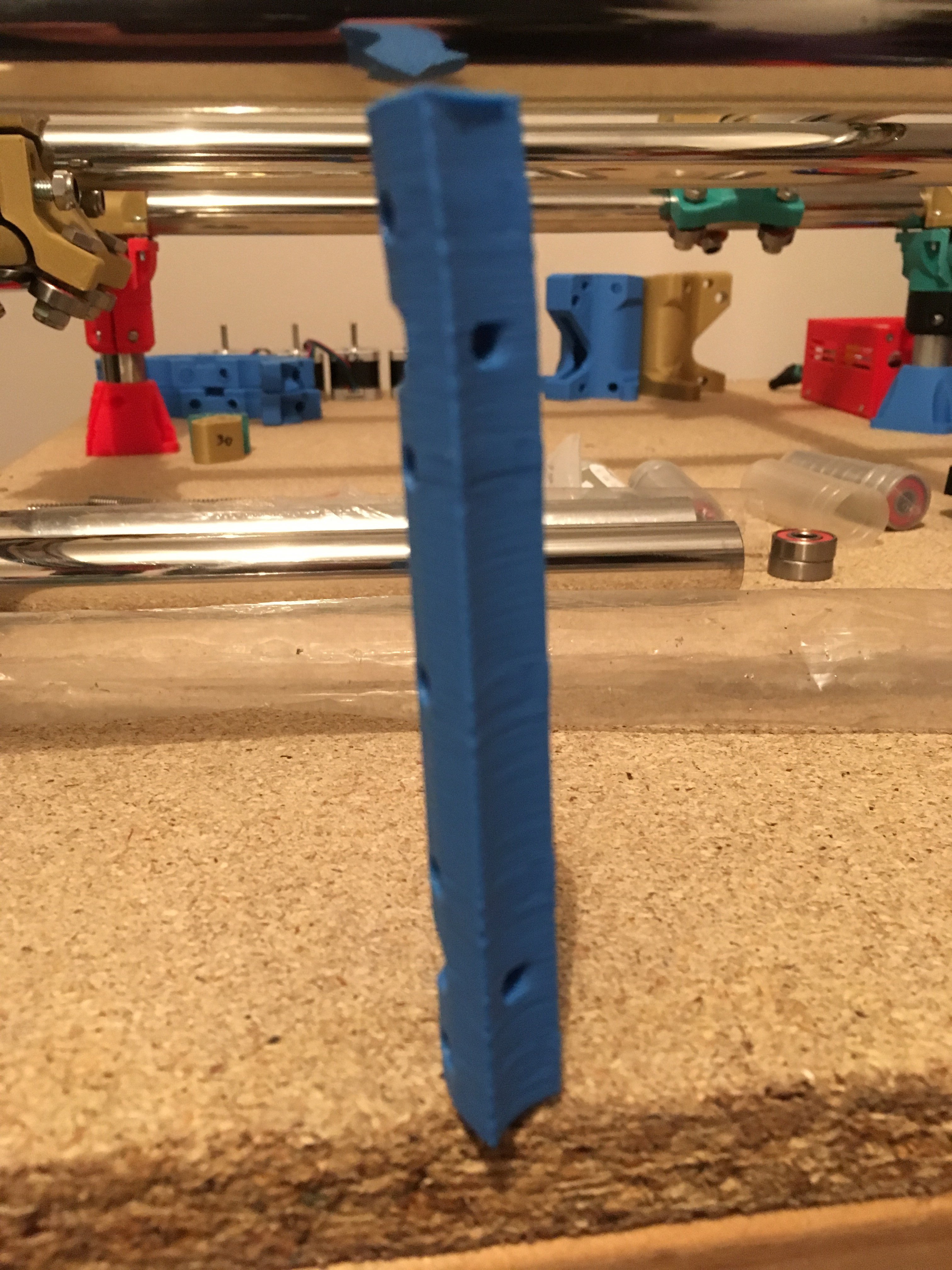

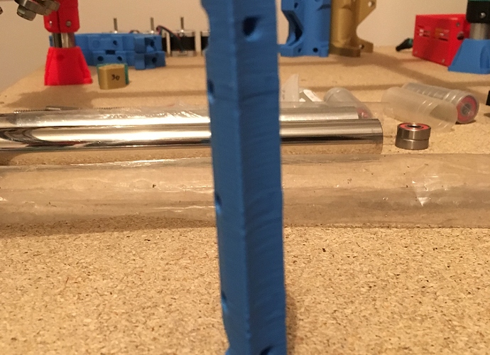

The biggest problem is that I can’t get the tool mount to print completely straight (slightly bent at the bottom) - tried twice on the prusa - the second time much slower on smaller later height - but same result - not sure what’s making it lean over. Will try putting it together and see if it affects things - if so will try reprinting on the Flashforge which only moves the bed in the z direction to see if that helps - or maybe redesign it so it can be printed flat without loads of supports.
I like the sound of your suction foot - I was thinking something like this would work well

yeah, the wiring was one thing is struggled with to begin with but then I drew a simple diagram and it was far easier. If you would like, I could print the tool mount for you, if I start it over might it would be ready to post AM.

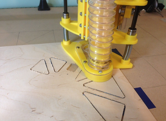

my suction shoe was a mishmash of some off thingyverse, I tried a few off thingyverse but none worked.
This is is my design and can contest it works superbly with zero mess
[attachment file=76817]
Suction shoe looks excellent - will have to sort out an appropriate vacuum and print something similar myself. Did you cut the transparent material on the MPCNC?
Thanks for the offer of printing out the mount - I will have another couple of goes tomorrow - and if they both fail I may well come back to you to take it up.
Ofcourse, yes the clear acrylic was cut using the MPCNC. I have just started a new project and this time a 4m RC Glider. been digitising the plans this weekend ready for cutting.
Again on the MPCNC, which was the main reason I made one…

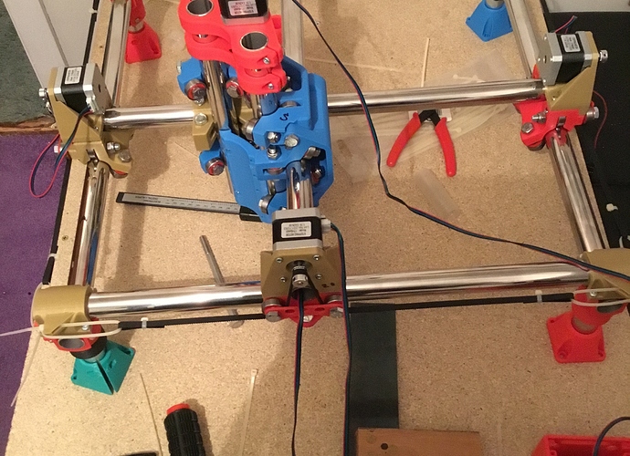

It moves! Now to work out how to use it!

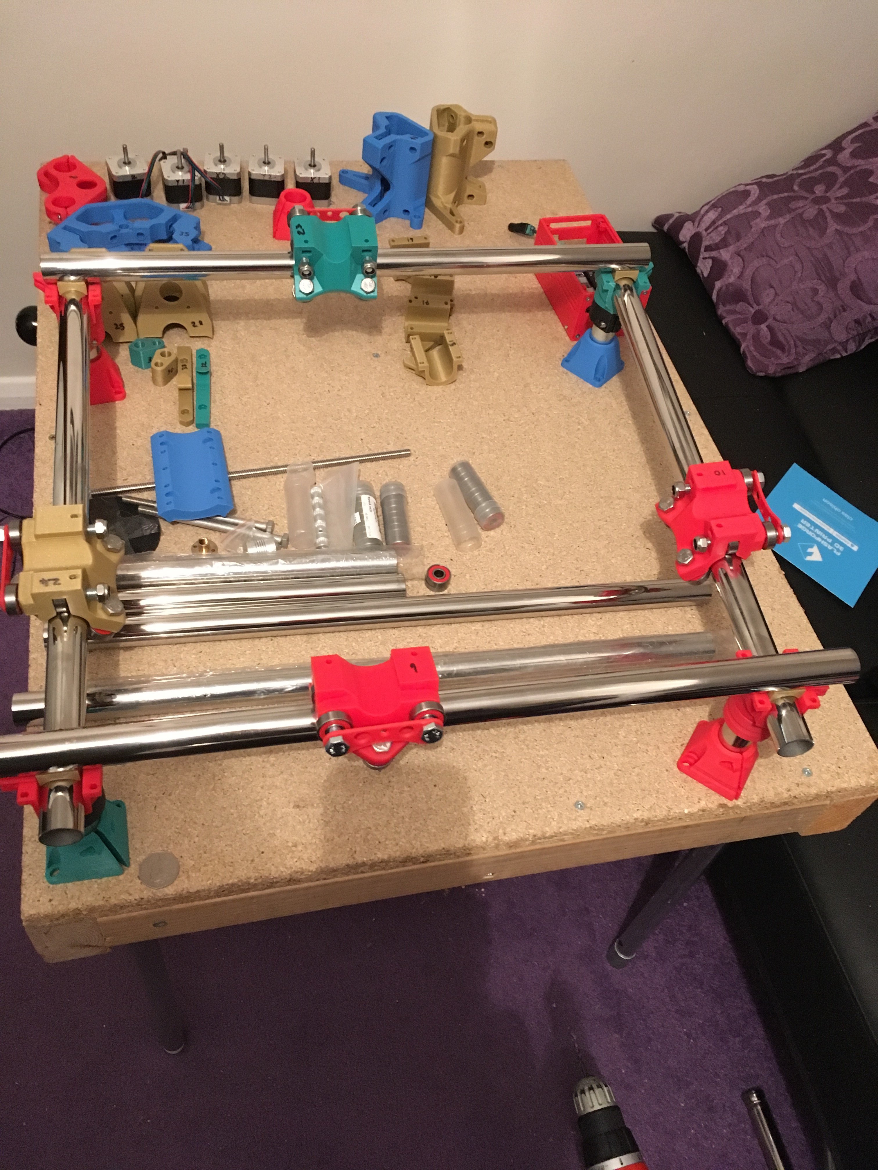

Really impressed at how well the centre part all goes together - had to take it apart a couple of times to correct bolt directions etc.

ps/ managed to print the tool bracket better by rotating it 90 degrees on the x axis -

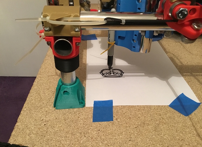

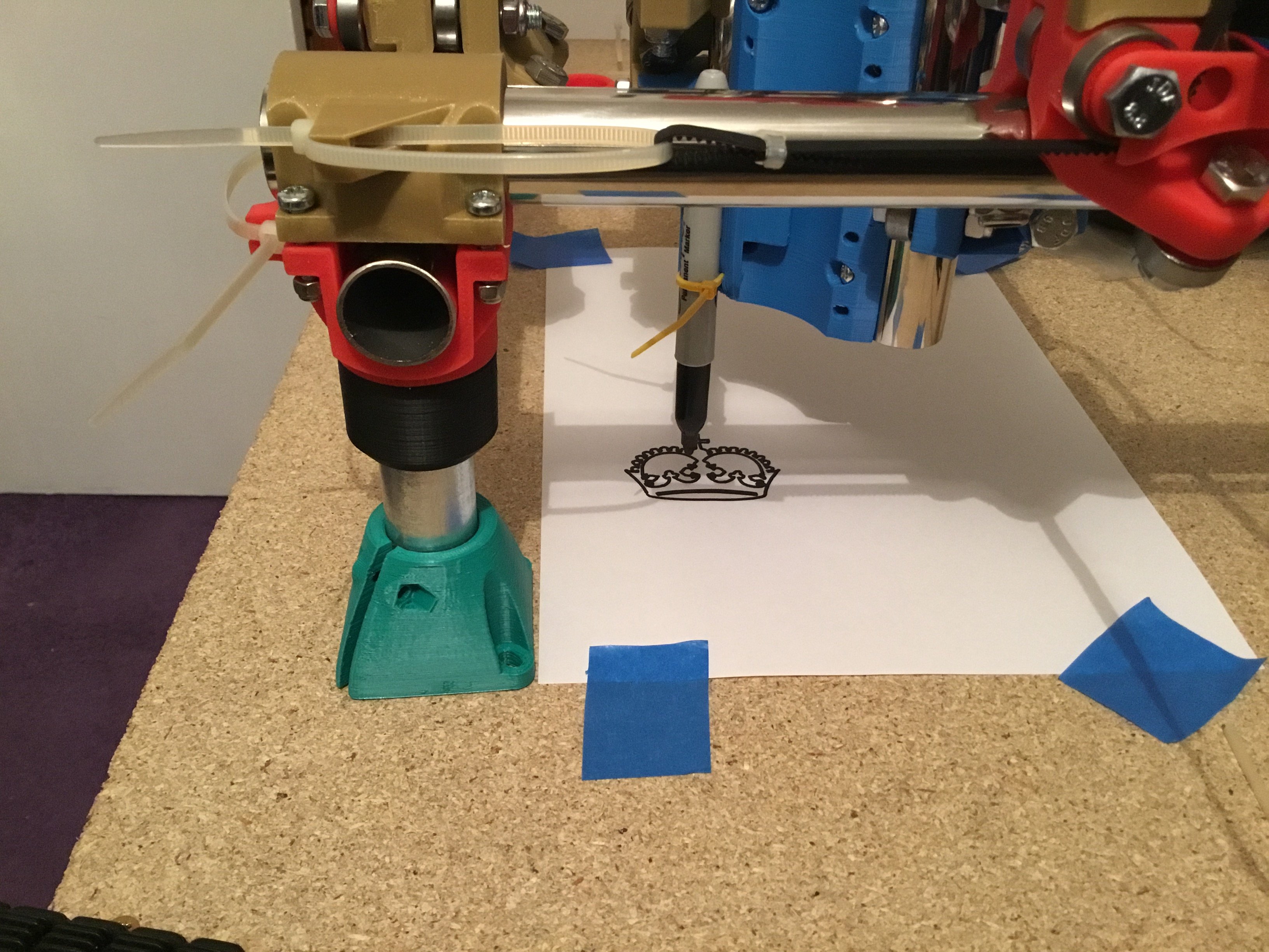

First drawing worked ok - next stage I guess is testing the scale and calibration.[attachment file=77027]
Lots to learn. What is your emergency stop button connected to - the reset on the Arduino?

I Wired the emergency STOP inline with the powerswitch. Trust me, during the
learning phase it as been a god send. Saved the machine on several times through wrongful
programming on my part.
I also wired in the Z Stop for zeroing the bit tip.
When you start cutting, think about having a sacraficial board, another fine addition
As for calibrations, if you used the suggested hardware and have the correct firmware loaded, you should need no adjustmenst. I did the 100mm x 100mm movement test and it was spot on.
