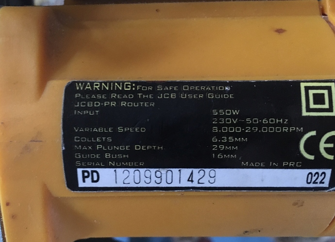

I think your JCB router could be a bit on the heavy side if it’s the 1/2" one.

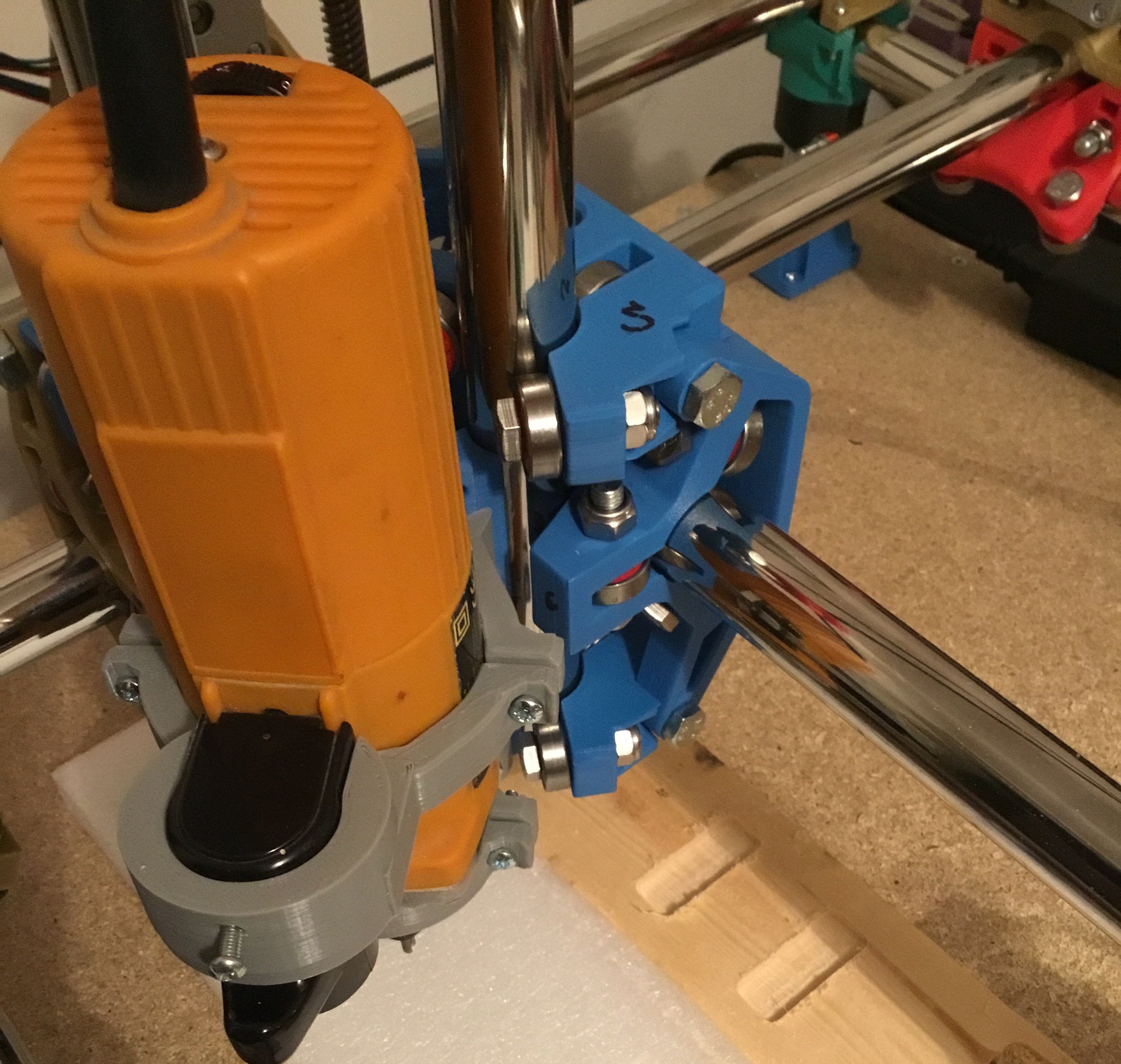

I am hoping to get my LCD delivered tomorrow so will try your methods out, plus also try and wire up a Z endstop plus either a relay or tplink wireless control of the router.

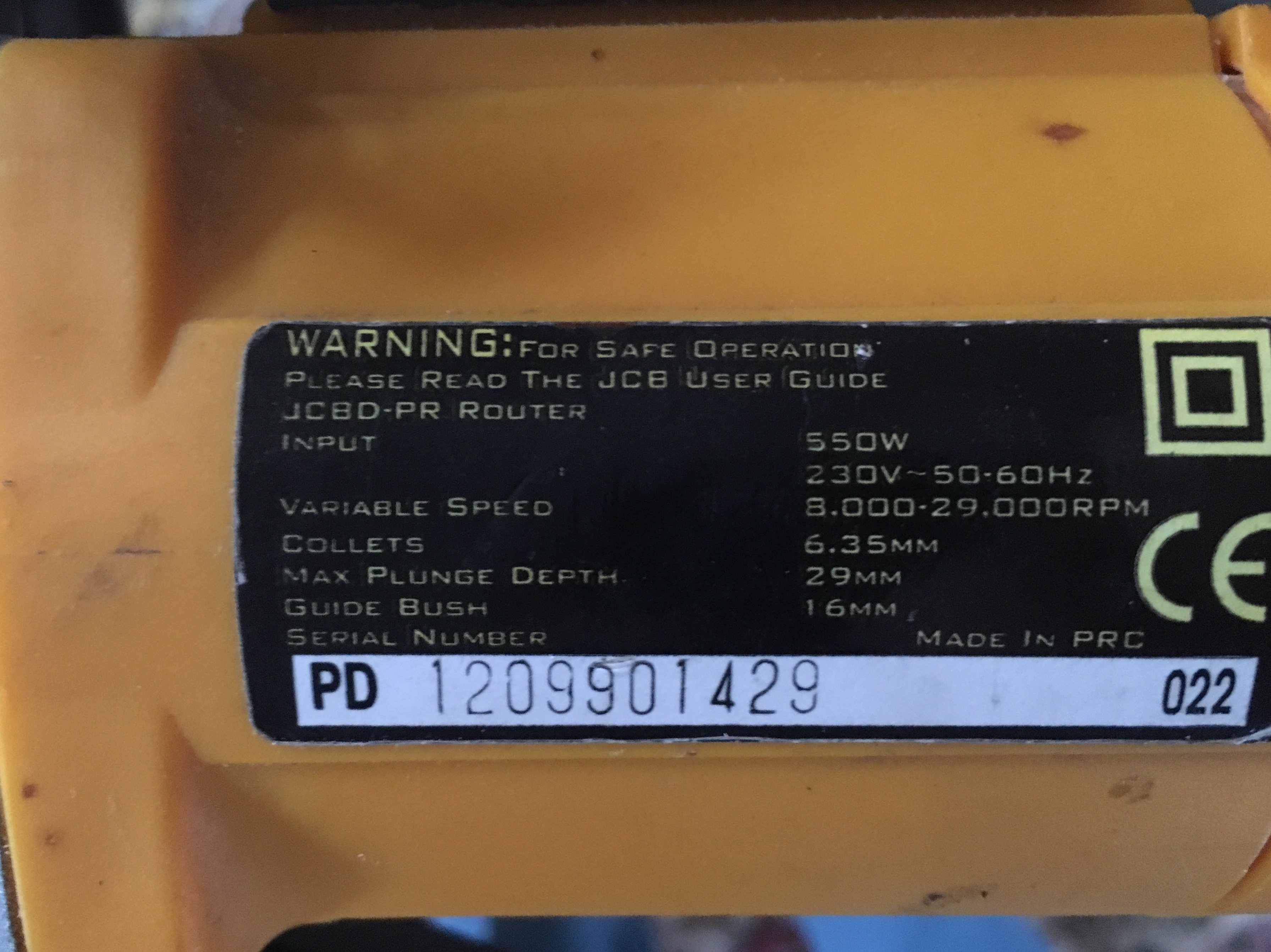

Bill - this is the Router I have borrowed for my initial tests- it seems to move around ok - but is extremely noisy - so will have to consider either an enclosure, a quieter alternative plus maybe ear protectors as my next step!

Ah, not the router I was thinking of, that should be OK.
You can “Home” from repetier but not your Z without a S/W.
I have my Z move to 65mm at the end of the gcode, my max Z movement is 70, I have a S/W at the top of the Z.
Bill.

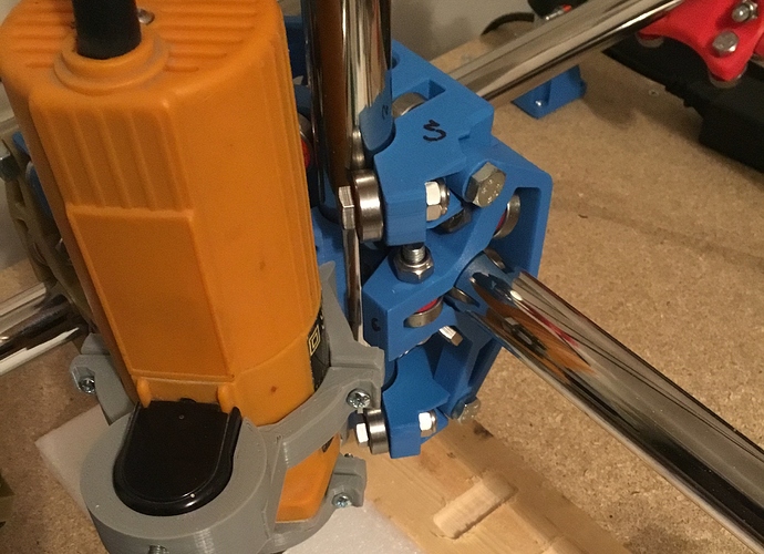

Z clicking.
Apart from what Ryan has said.
Check that the coupling is tight.
Does it do it with the router removed.
Loosed the leadscrew nut attachment screws, run it up and down.
When it is at the top slightly tighten just two of the screws, if still making a noise loosed those two screws and tighten the other two.
If it is still clicking take the stepper off and move it up and down by hand, any tight spots.
Check all bearings are moving on the Z assembly.
It may clear itself in time.
That should do for starters.
Bill.

Z axis clicking is usually found to be an interferrence between the tool mount and the Z| axis, I came across this while designing my vacuum shoe. To test, move the Z axis using RH until you hear the click, then look closely for any interference. it takes a while but hopefully a sucessful exercise

Thanks both will try those things. It sounds like it is coming from lower than the coupling - but it did only come with 2 grub screws so I guess it could be that - another one on order.
Will run some up/down speed tests to recreate the problem then try out the various things suggested.

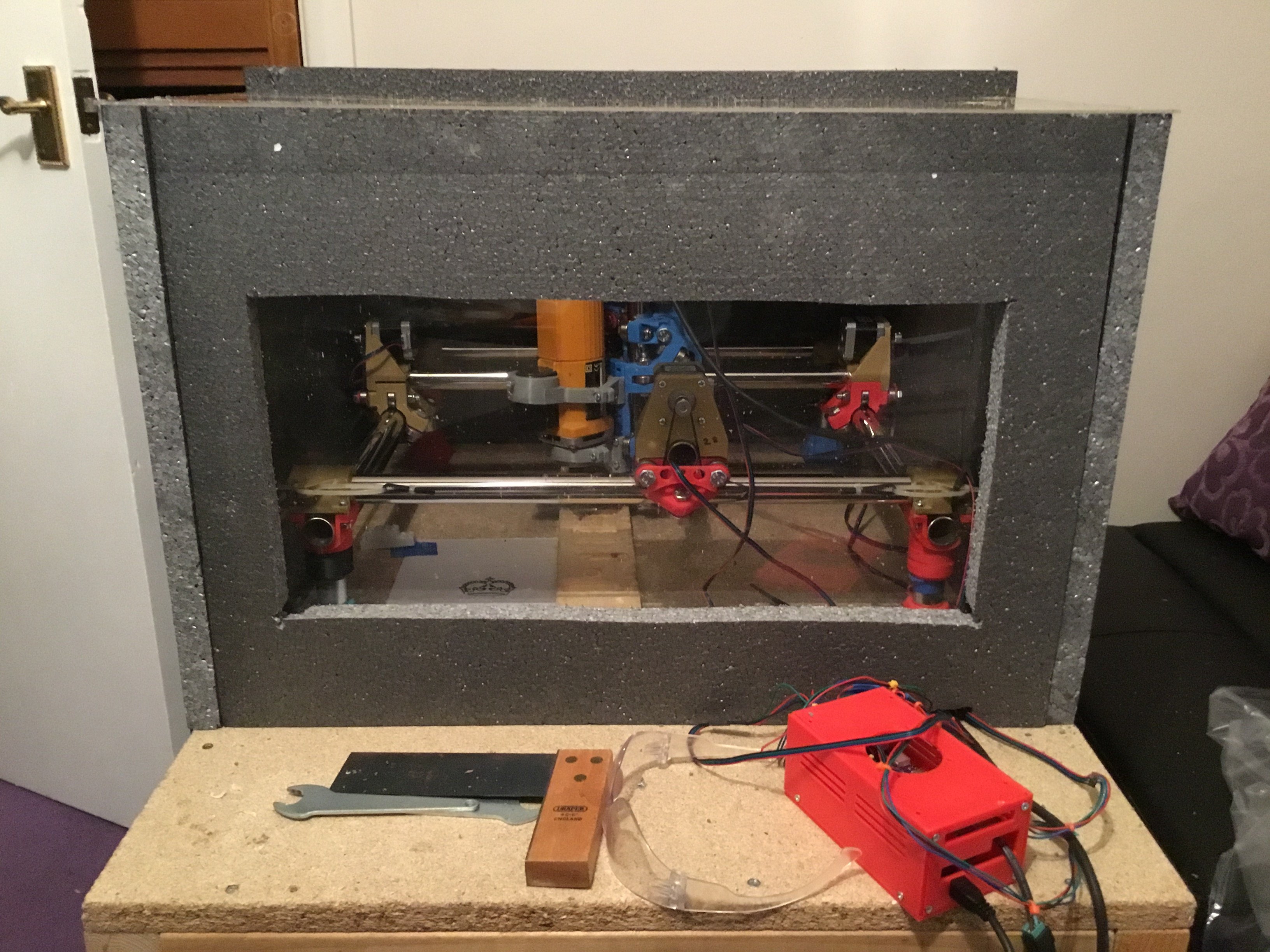

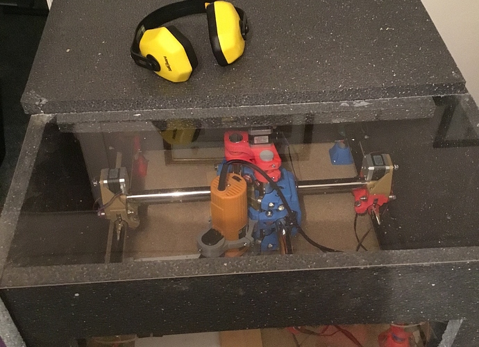

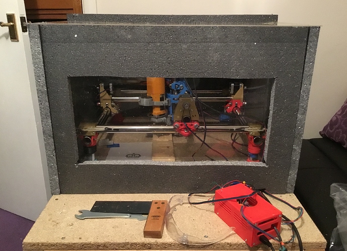

Noise control stage 1. Some improvement - especially in other parts of the house. More layers required to really cut down on the noise. Also a good interim dust control problem until I sort out some vacuum extraction.

Next problem is that I just got my first Communication timeout - printer reset detected. So will try moving the spindle cable away from the Arduino and if that failes will try the MKS board next or try shielding the stepper cables.

'Computer using Repetier Host. I moved the cable and did a couple of small runs and didn’t get the problem -so possibly fixed.
