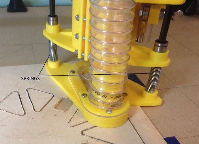

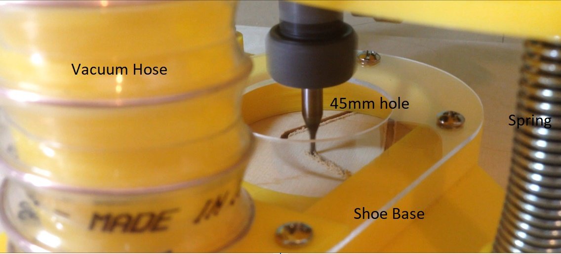

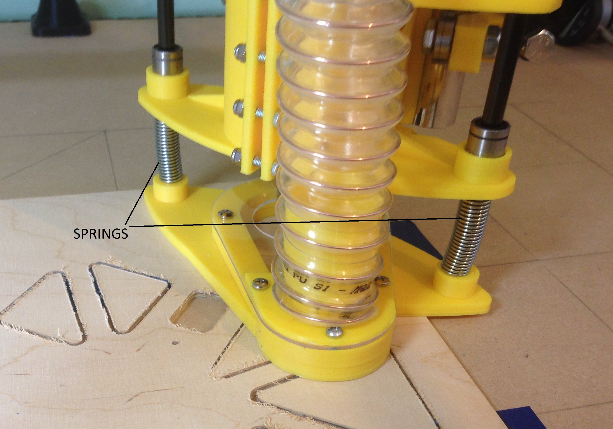

My dust shoes is very effective
[attachment file=78001]
I hope it is self explanatory, The main vacuum hose connects to a dyson. the air from the Makita Clone is not diverted. The 45mm hole below the spindle is that size to produce a venturi effect and also to reduce the amount of suction between the shoe and work material. The spring as very light tension and just holds the shoe base down with minimum force.
[attachment file=78005]
With the dyson running there is zero dust and debris escape. It moves around very nicely and stays perefctly attached to the work material…

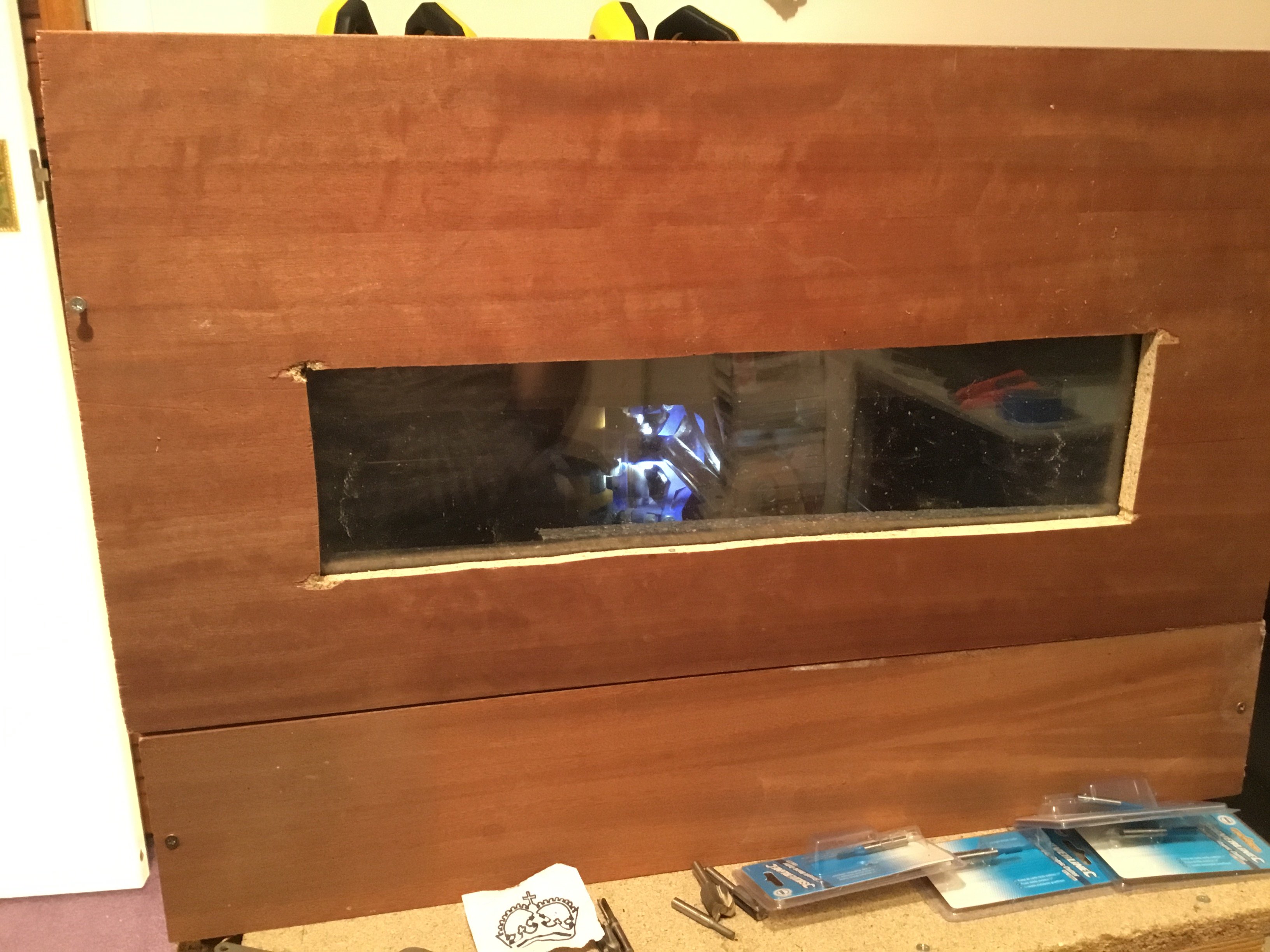

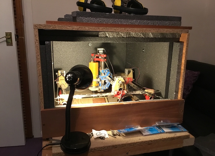

Spent most of the day today adding some extra layers to my cabinet - but it is still quite noisy and it makes the whole unit very big - so may have to rethink - and scrap the cabinet and just live with the noise, which ear protectors do a good job at reducing for me - just hope the sound doesn’t travel too far.

Think I will have a try at a dust collector like Stuart’s next.

I do love your dust shoe though. Like all your stuff, the print quality looks top notch too, so nice work there too!
Are the springs useful ?
You use bearings along the rods so the gravity should push it down, and when the Dyson runs, it should press it against the material, right ?
Hi
No it is designed to produce the minimal downforce due to suction.

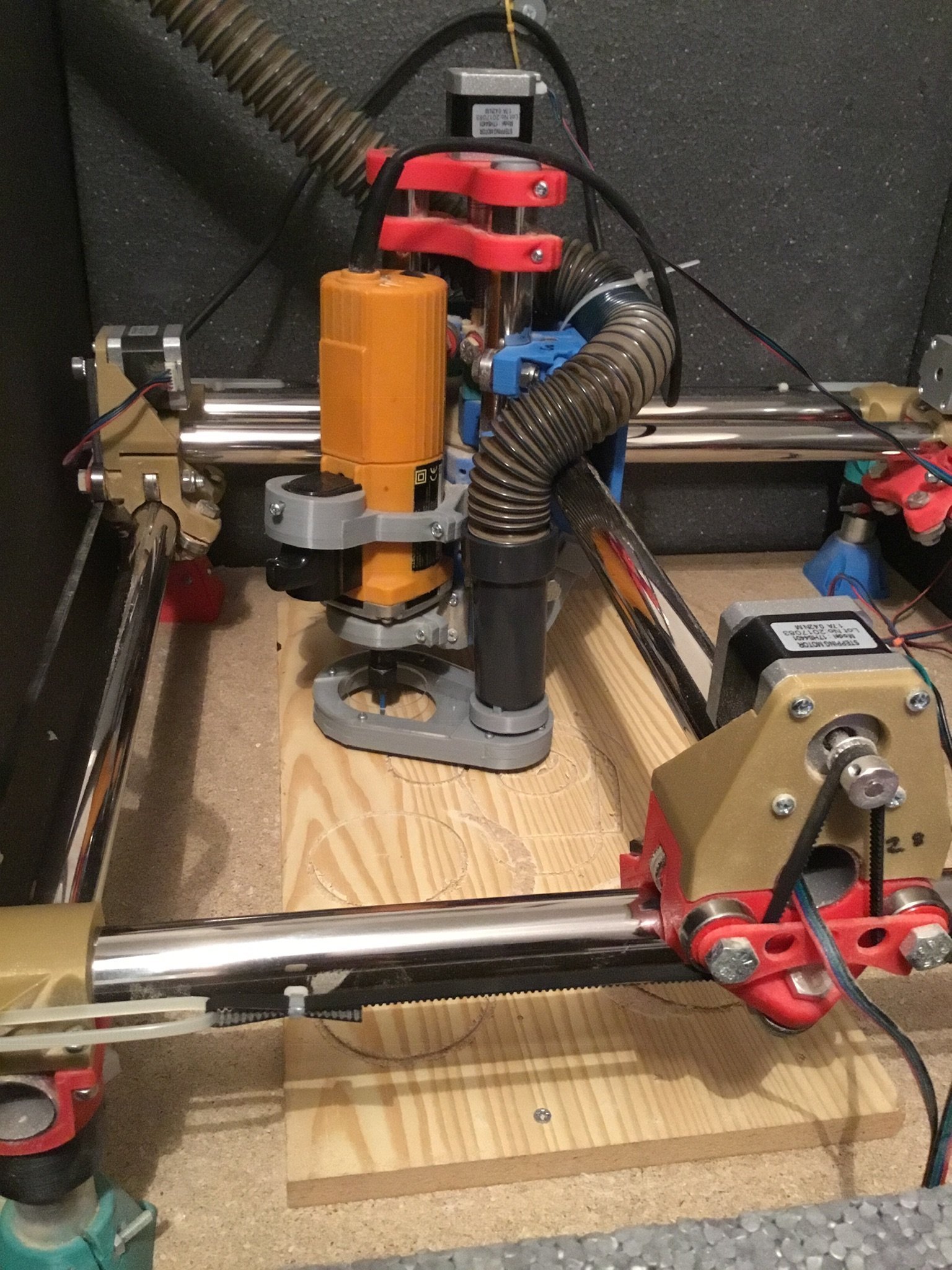

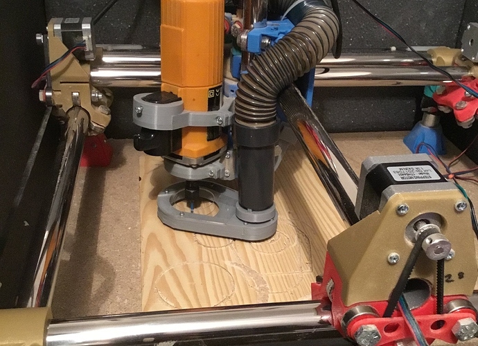

Inspired by Stuart’s dust collector made my own modified version attached to the center brackets.
Works well in initial tests - absolutely no dust left behind from thin ply. The only problem is that the vacuum cleaner is even more noisy than the router!

DaveW Sir
I like that very much and your tubes look awesome.
