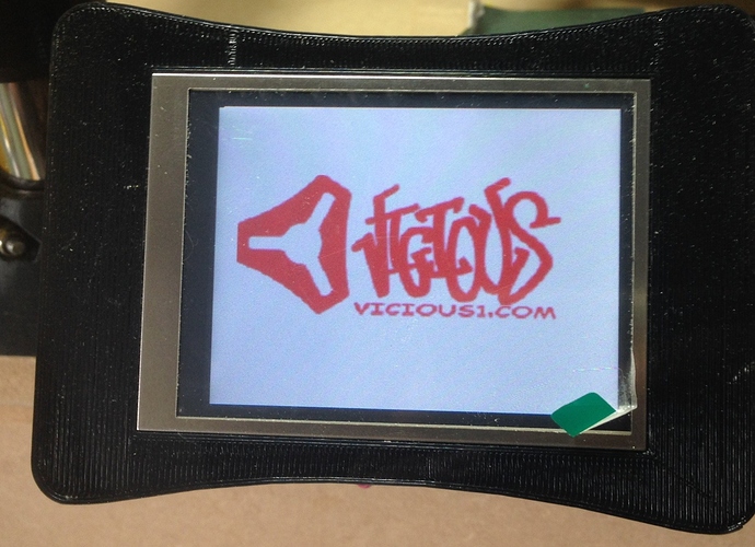

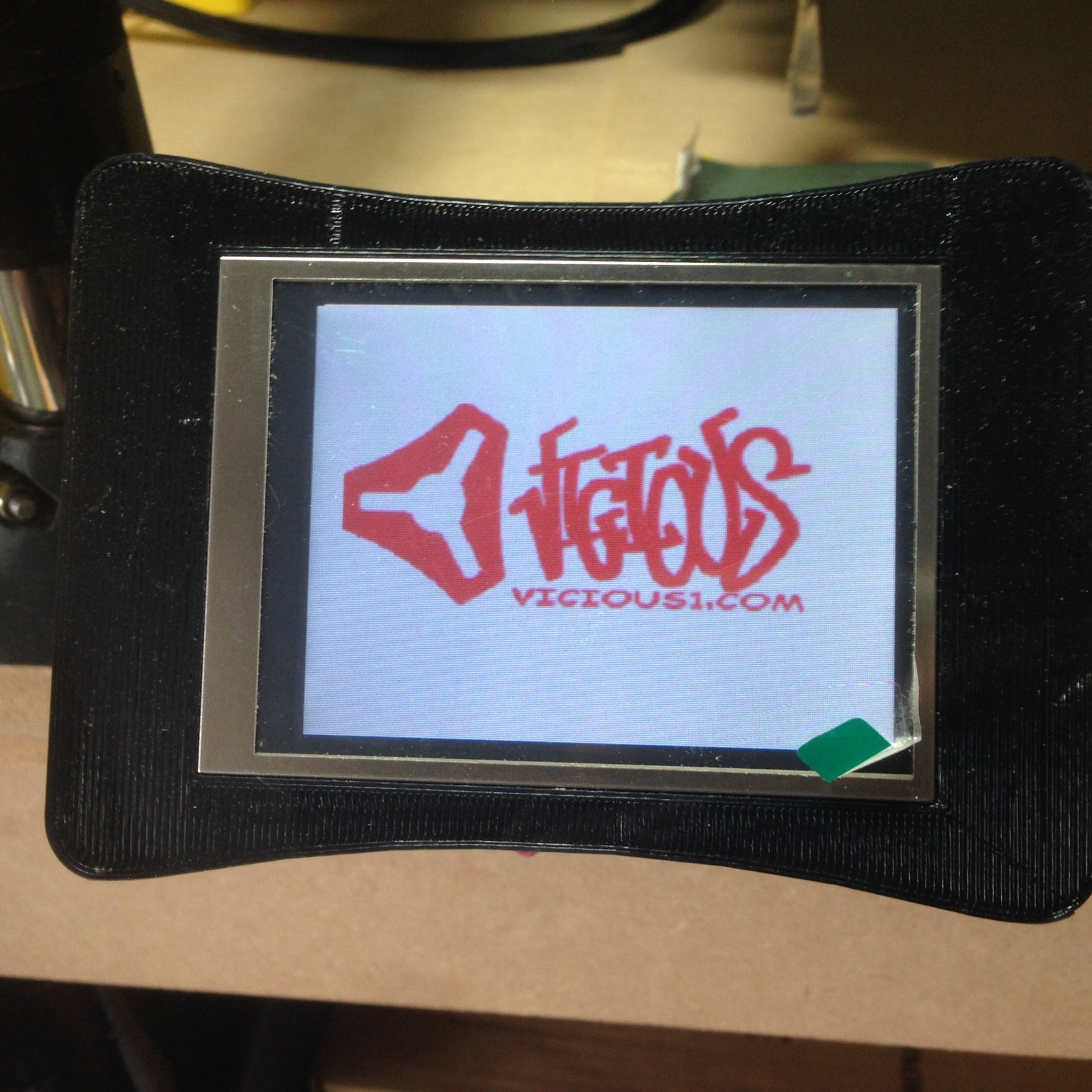

It maybe the first with a Flat Screwdriver as a working tool, but it sure does insert screws accurately ???
Here is a closeup of the Splash Screen.
[attachment file=66792]
Regards

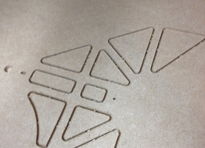

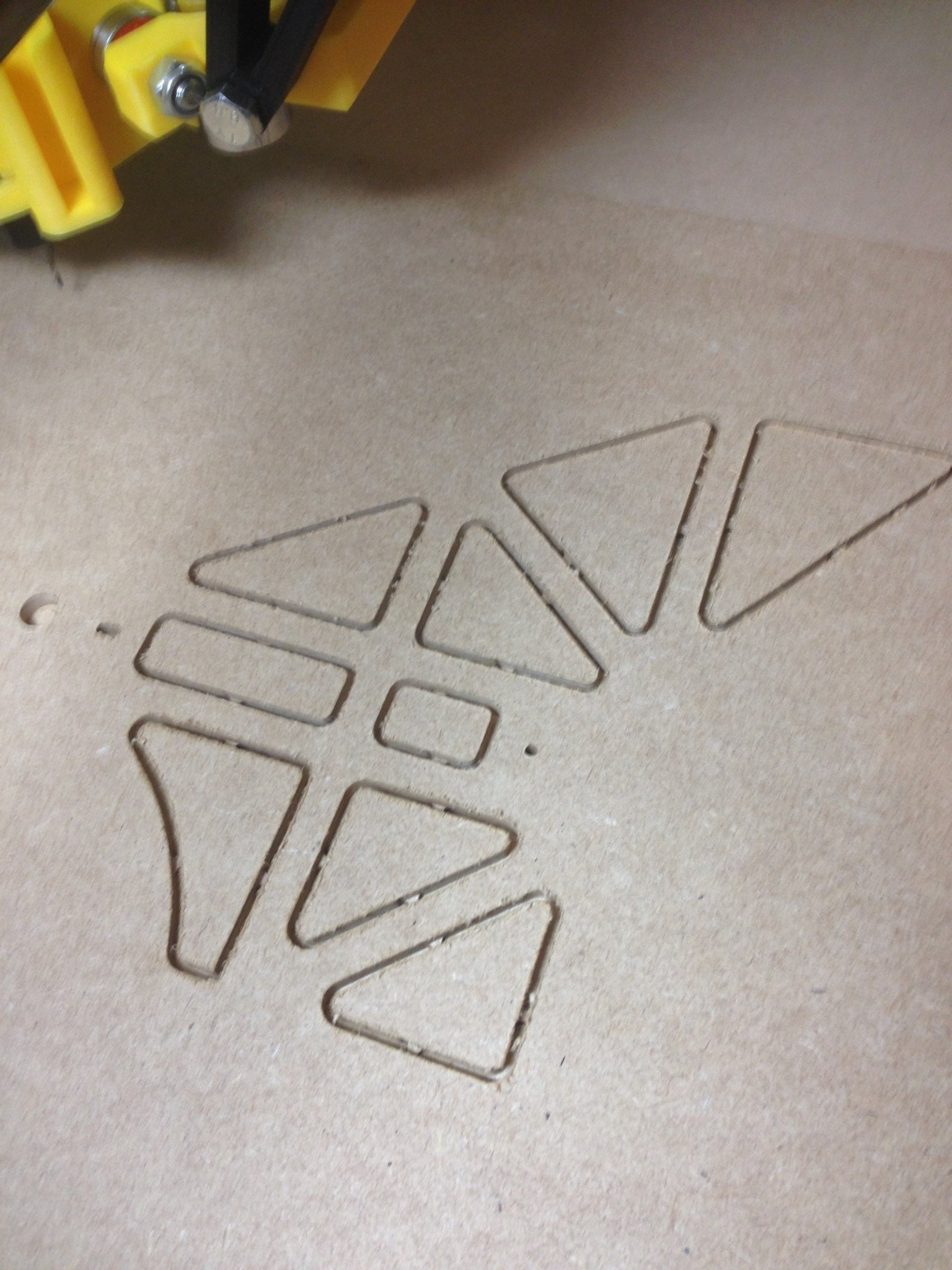

Today I did some finishing touches and attempted to cut a first part. Well it didn’t go exactly as I had hoped, it cut everything as I had programmed but didn’t cut the outline at all LOL
[attachment file=67327]
However for the cuts it made I’m very pleased.
I just need need to do some thinking to aid keeping the mess to a minimum. The Vac attachment didn’t work too well, this could be because I used a basic Vaccum and think I need to give this area some thought.
on a whole though, I’m very pleased

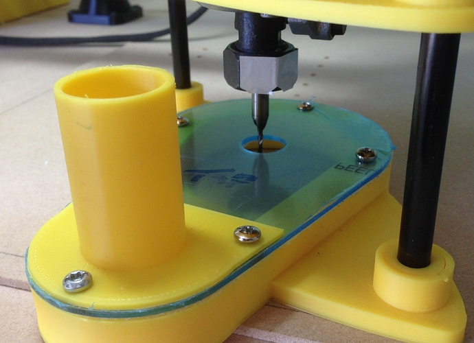

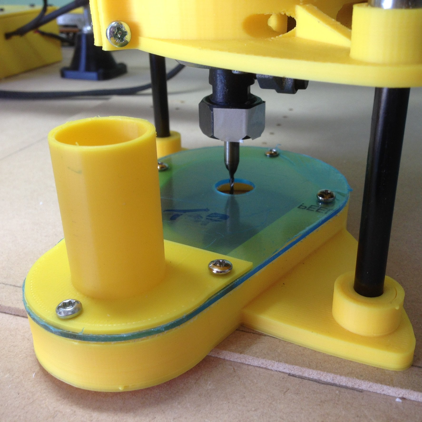

I thought I had downloaded a “Makita” mount to stop the chips being flung everywhere. However after 28hours of printing it turned out to be one for a Version 1 of the MPCNC. So not to be deterred I drew myself another using a mishmash of a few.
Very happy with the result
[attachment file=69578]
you will notice some clear acrylic with pale blue protective film attached. The acrylic was cut using the MPCNC after being drawn on DesignSpark Mechanical… Was an easy fit as the CNC cut all the holes very precisely.
i have today ordered some super flexible 38mm hose. When this as arrived and as been installed I think it’s will definitely be time for more serious routering

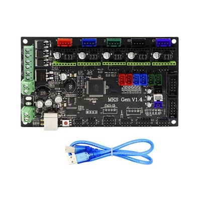

Hi Dave
Sorry to hear about the magic smoke.
For electronics I went with an MKS 1.4 Board as you don’t need any extra boards, it as power included, got it off eBay from China for £19 I think including the stepper motors but went for the upgraded DRV8825 in the end.
Similar to this
regards
Thanks for the info - have ordered from Amazon some 8825s (£9.99), plus a MKS1.4 Board (£18.99) and a 2400 LCD (£9.99) as suggested.
The good news is that I have subsequently found out that A4988’s and DRV8825’s have the potentiometer on the opposite sides and I had used a diagram showing 8825s - so had inserted them the wrong way around. The 2 remaining A4988’s that I hadn’t yet plugged in seem to work ok now without any smoke using a test sketch- so hopefully I haven’t broken anything else.
