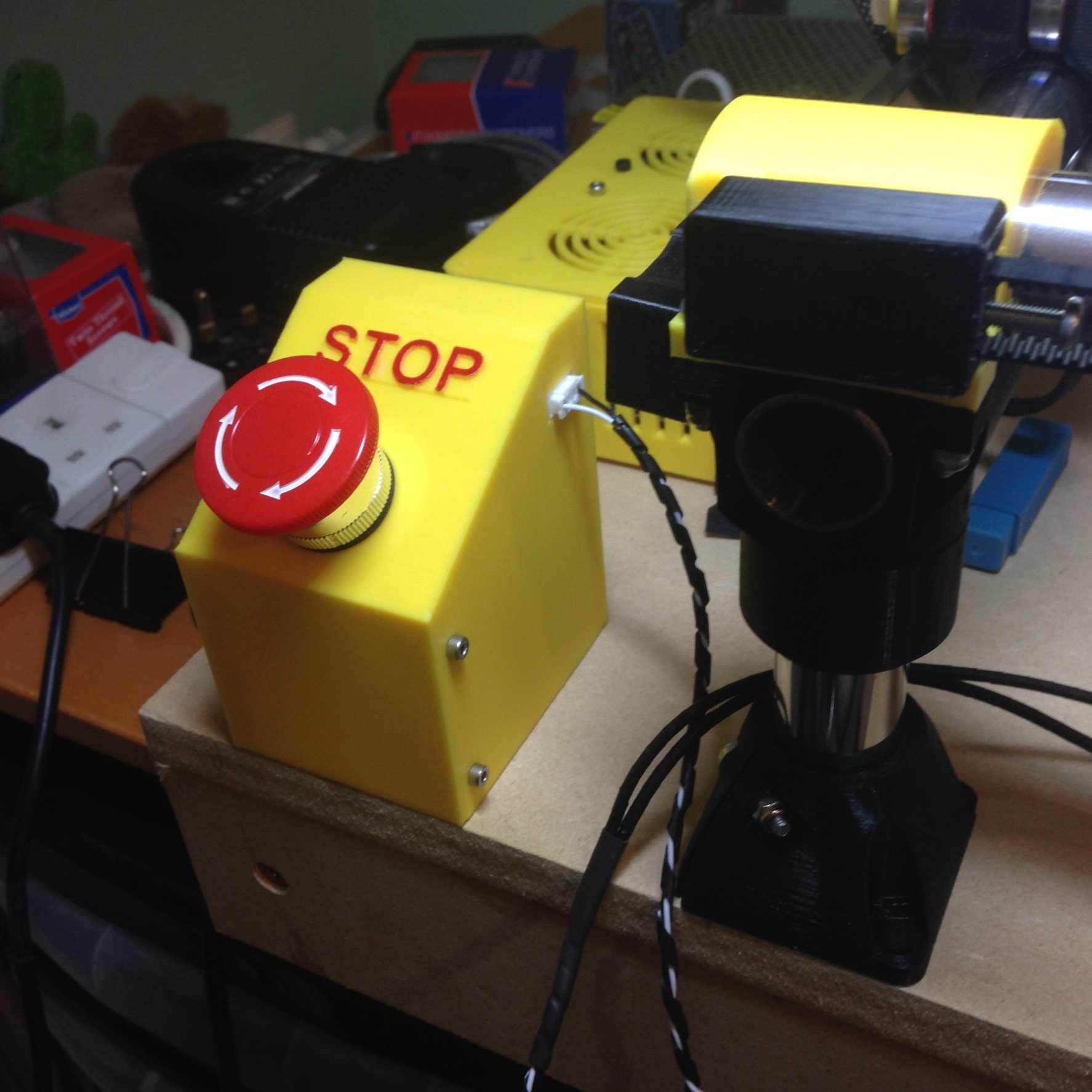

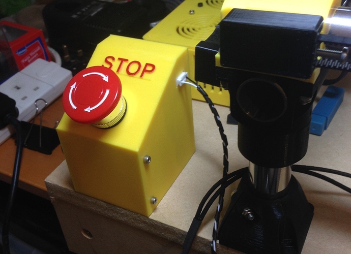

Today I made the Emergency STOP Button housing
[attachment file=66109]

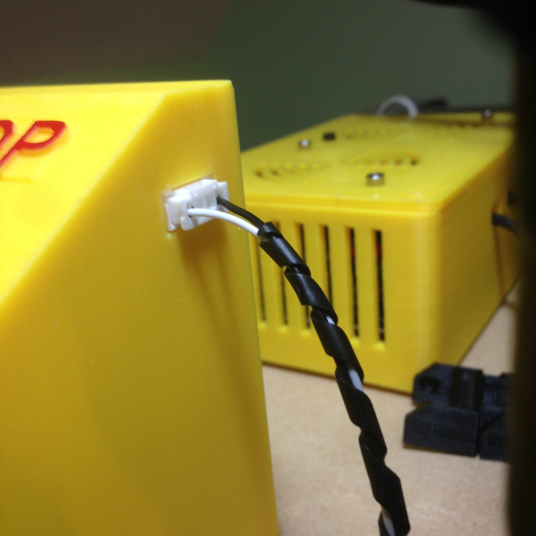

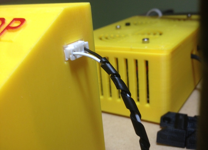

you will notice I have added a connector to the top right side
[attachment file=66112]
This is were the Z zeroing wire connects and can be easily disconnected.

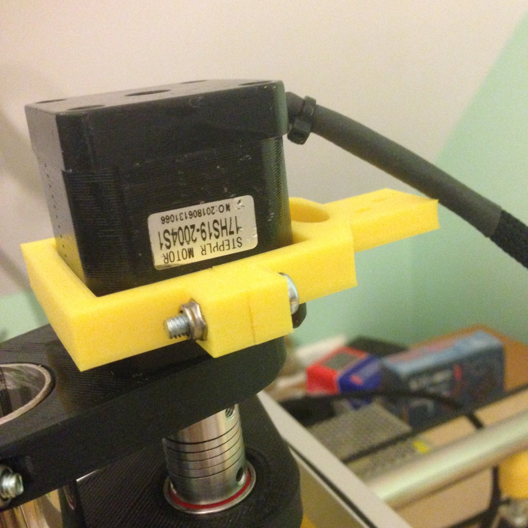

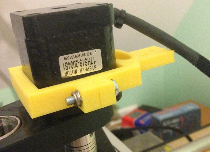

I also printed and installed the Z axis Drag Chain Mount.
[attachment file=66115]
