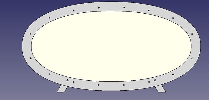

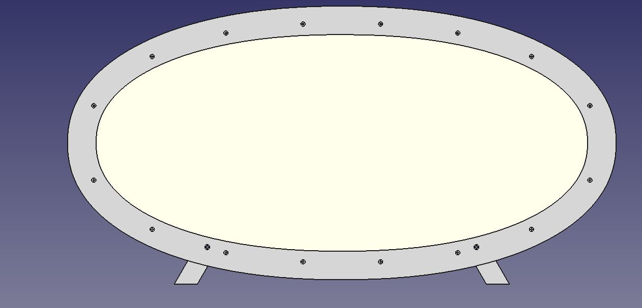

I’m trying to create parameterized sketches in Fusion (Personal version) of various size/shaped super-ellipses (Lame curves).
The equations in question are:
The-parametric-equation-of-a-superellipse
where t(min) = 0 and t(max) = 2*pi, a is the major axis (overall X length/2) and b is the minor axis (overall Y length/2).
I want to create a project where I can use user defined variables to define a, b, n, t(min), t(max, and interval/# of data points to create different shapes and sizes of the super-ellipse curves for various components
Like this:
I was able to do all of this in FreeCAD using an available plug-in/script, but I finally gave up on FreeCAD and migrated to Fusion (Personal).

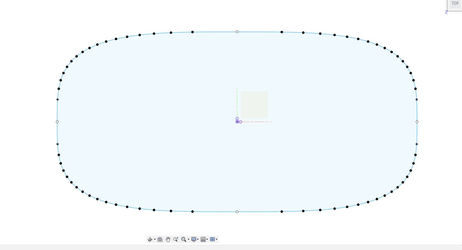

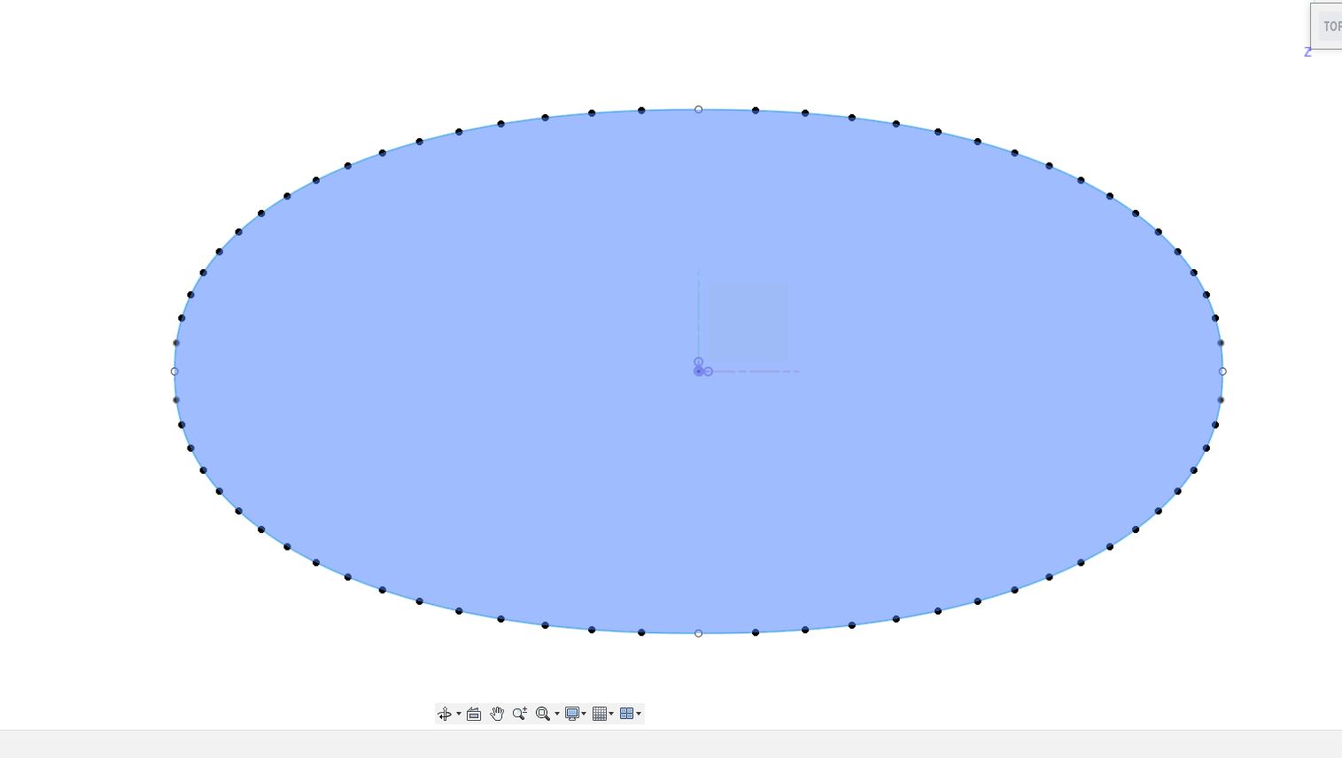

Well I made some progress. Using a template from a user on the Autodesk forum as a starting point, I was able to create a sketch from t_00 through t_90 (with 5 degree increments) using the super-ellipse formulas for x and y. I then used the Mirror function to populate the other three quadrants.
I can modify the n parameter to create different shaped curves, and I can modify the a and b parameters to create different sizes of the curve.
n=2.2
n=3.5
This method, however, is fairly tedious, repetitive, and labor intensive. Each point, x and y position must be manually created in the parameters database, and then those positions must be individually assigned to each point using the sketch dimension tool.
