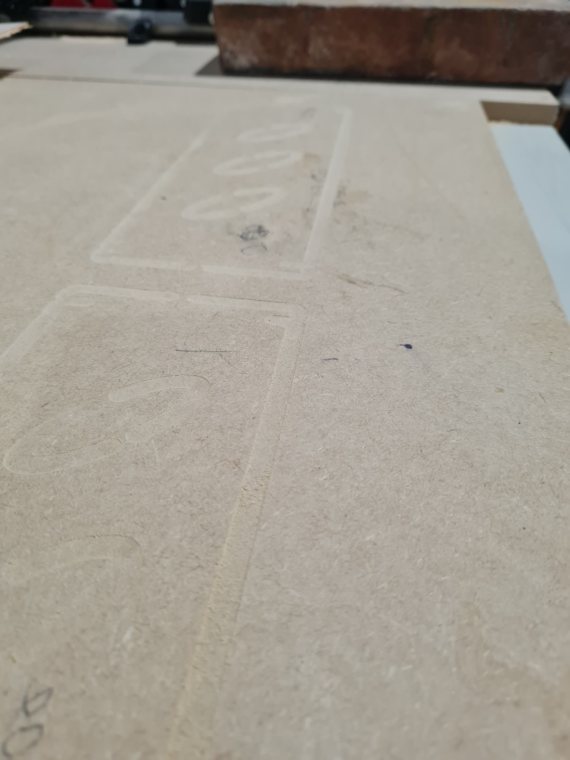

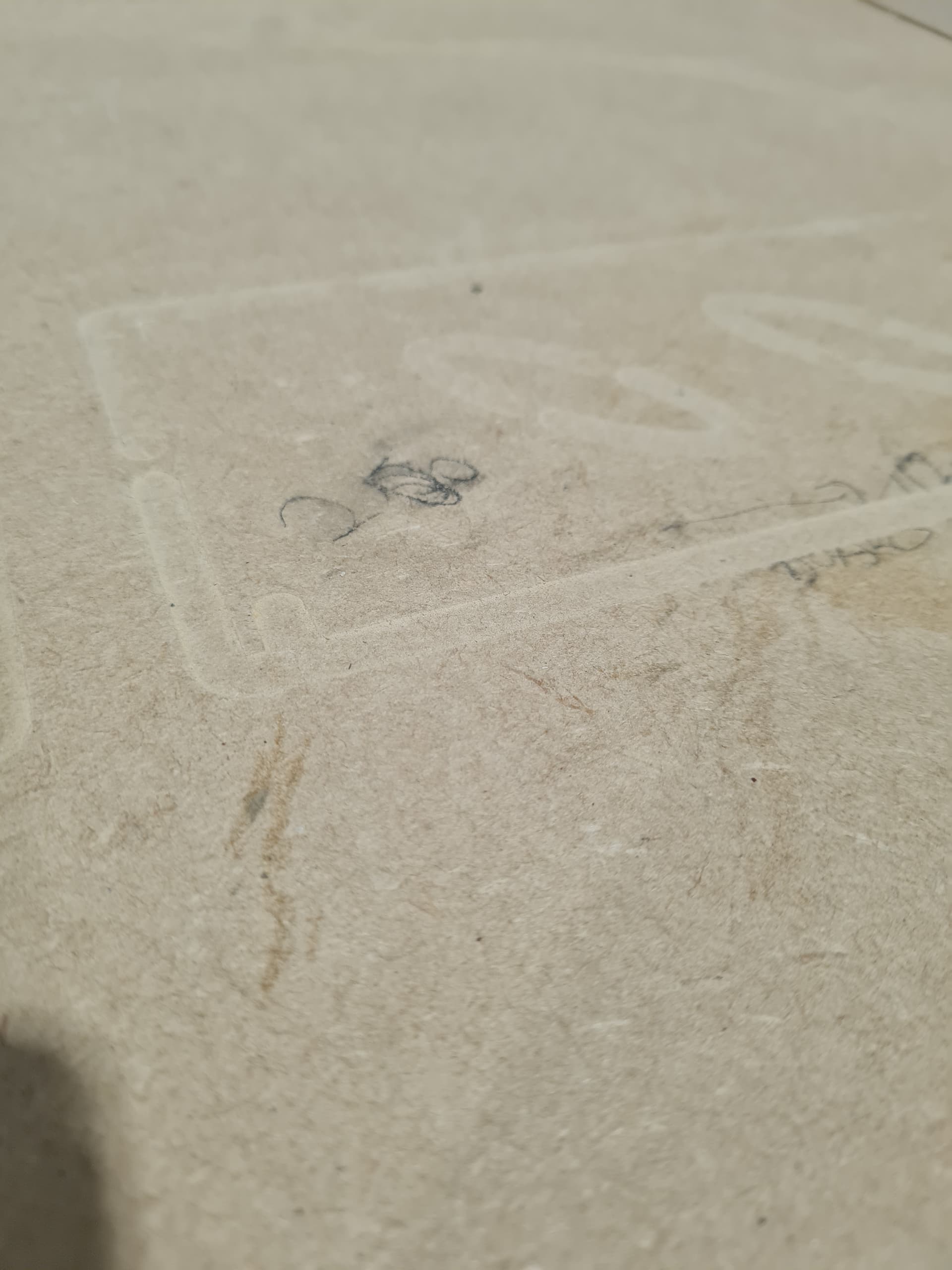

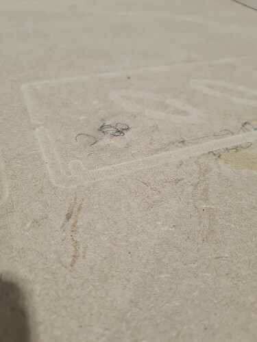

Here are some photos after i cut the series of gantry boards
And a bit closer
And even closer
I am going to say that is about 1mm, i also noticed that the screws i used to hold the sheet down have lifted the MDF slightly.
Either way thatnis pretty flat for a first use with no flattening etc. Which makes the door idea for a small cnc a great idea…

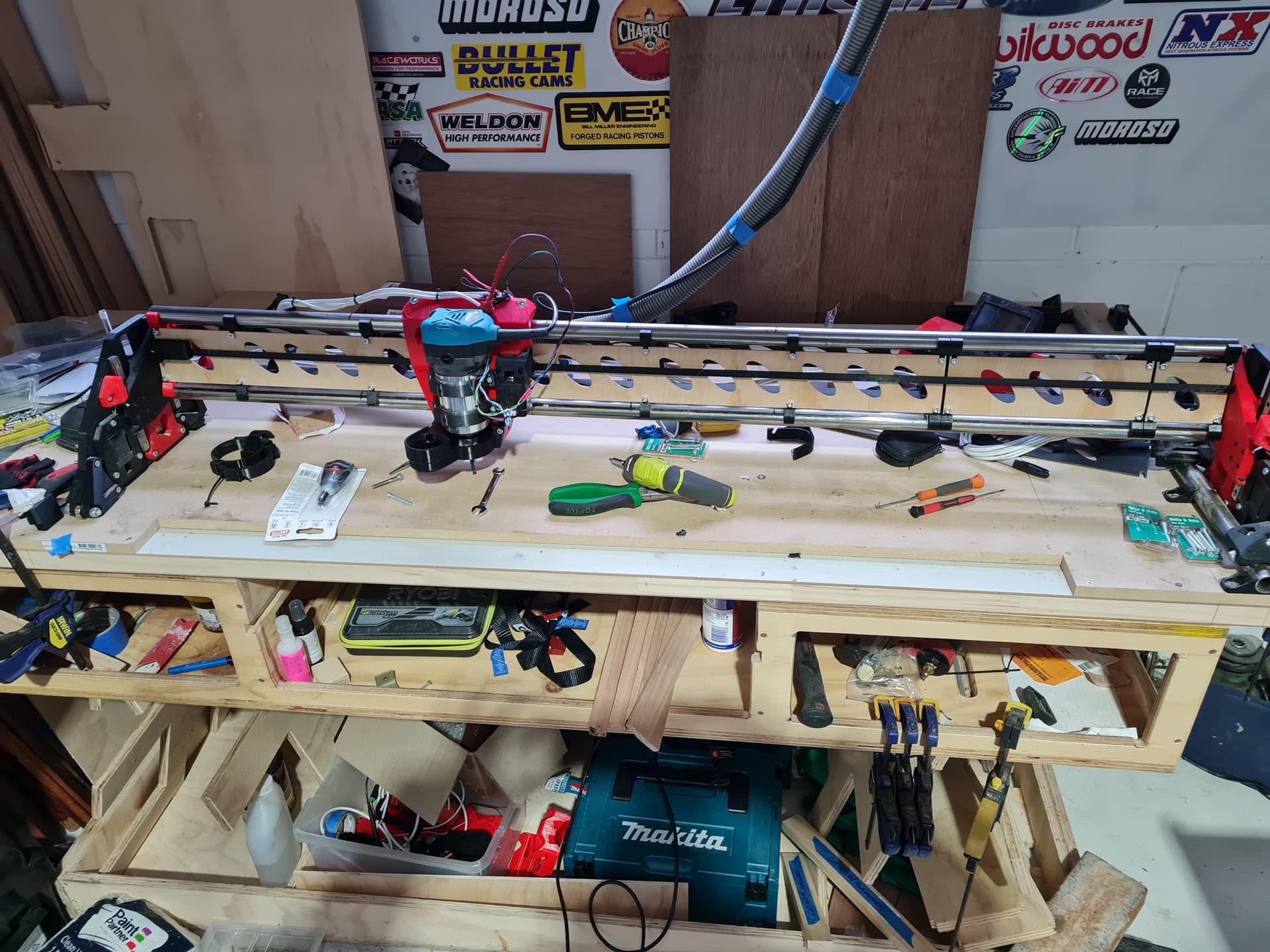

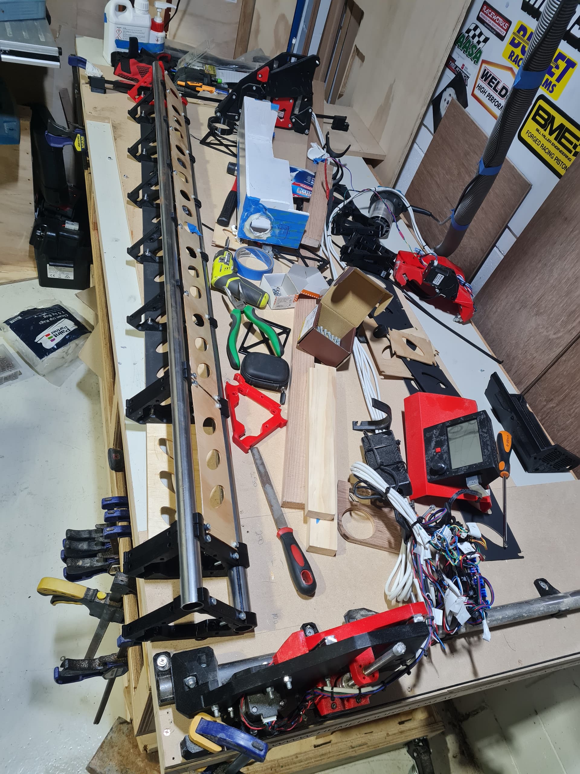

Well,
I have finnaly finsihed the gantry stuffening boards and pulled apart the LR3
Turns out i have a few broken spacers, but luckly i had printed a few extras. Also need to get some longer 5mm bolts to join the supports
(Due to not having enough width to cut the board in the one bit)
And of course, i put the back one on first, so i could not put the botton one on. Lol,
So didnt get it finsihed, but i am inpressed on how stiff those boards make the gantry.
Life is getting in the way of my playing again.
But I did get a few hours to finish fitting the boards to the gantry and get the LR3 ready- ish to cut again.

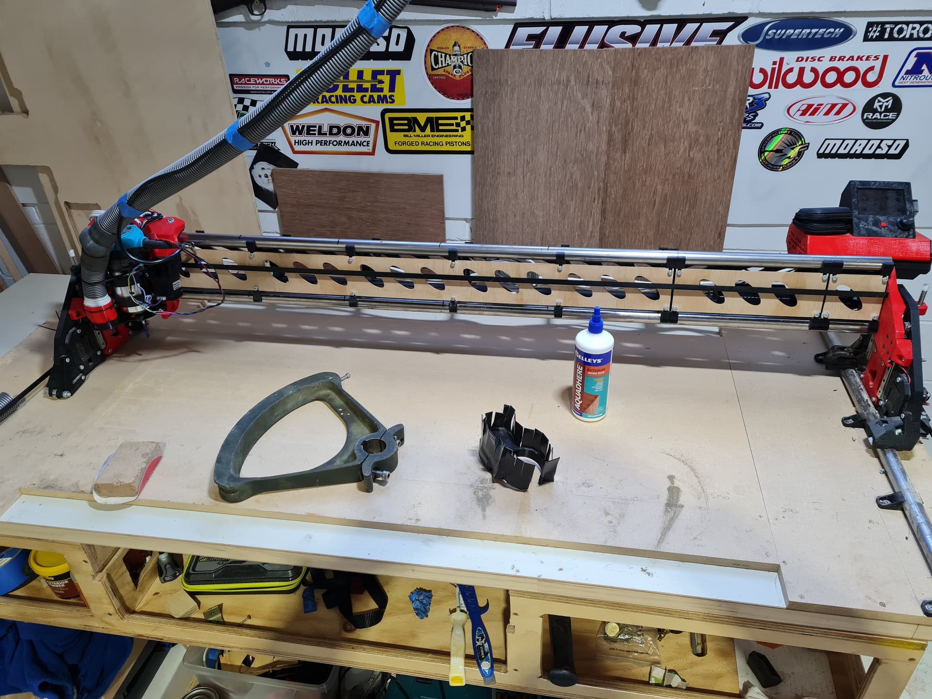

Ok, again life, study, boat projects and its seems EVERYBODY want some of my time, so i have not been able to get much progress on the LR3.
But with the public Holiday in Aus, i was finally able to get back and finish up the LR3.

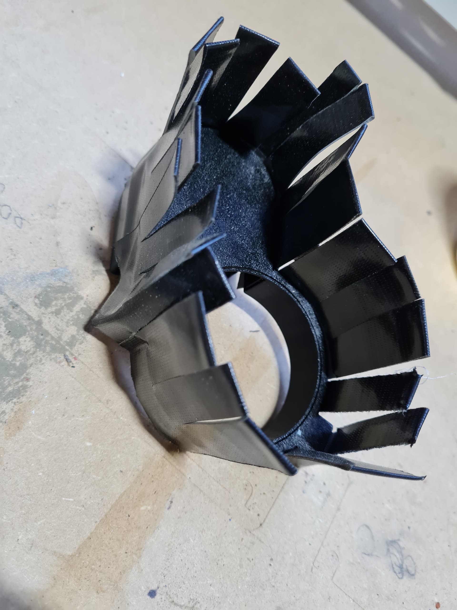

So i got the last little bits cleaned up, bolts in, wires cable tied and even had a brain fart and figured out a cheap and hopefully effective dust skirt.
I am using some Cloth Tape “gorilla grip external” tape folded over and stuck to the outside of the removable dust shoe. i then slit it several time and made the little fingers. they are stiff and if the router grabs one, hopefully they will just get chewed off. (not ripped off.) I am using the Magnet mode for the dust shoe.
I also fixed the vac system, re running the vac tube a little and trimming the length etc. Oh and i added one of my 3d printed ball joints. this is probably the first serious part i printed years ago and its still going. It works pretty well to relieve the stress of the tube not turning etc. Ok, it leaks a bit but i does “suck down” and closes up, but it def not perfect.

Jobs still to do:
square the LR3, need to read up on that.
surface the spoil board
Some sort of hold down system

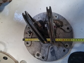

These big sheaves (pulleys for you land lubbers)
Need to be inside that block of wood. (basically that lighter circle in the picture is the size of the base of the Sheave plate. The Sheaves redirect the steering cables) so the block is like this
So it will be cut out of either Teak or Tasmanian Oak 18mm thick finger joined table tops.
(then slathered in penetrating epoxy and then varnish of some sort, maybe Epiphanes)

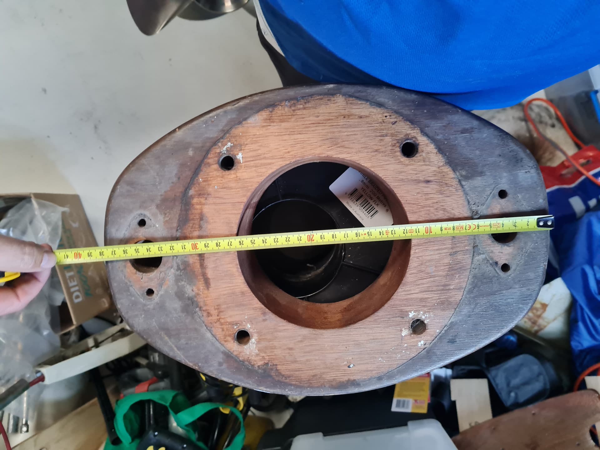

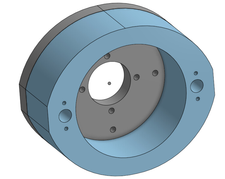

This one i am still note sure about, the LR3 could do it as its just bronze, Tassie oak is probably harder than it, For those that have not seen the other question on how you you would machines this, i need to enlarge the hole from 38mm to 45. But its a one off component that would be very hard to replace.
The local loan shark would get a lot of business from me to pay a machinist around AU$500 to line bore it.

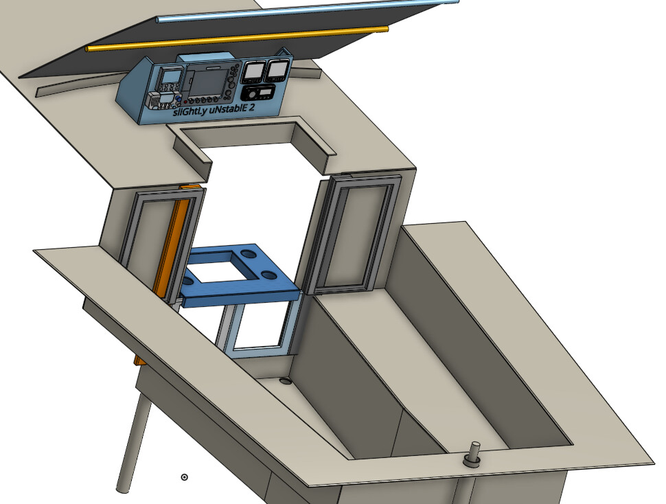

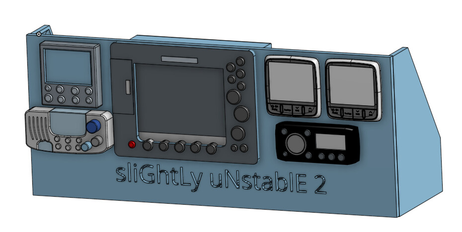

Edit: forgot that i have to make a new box to hold all the boat chartplotter and various readouts.
Was going to look like this:
and sit here
Yes i modled the cockpit of the boat, and yes it to scale.
Also yes the boats name is “slightly unstable 2”
But with the pedestal that has changed and its going on the pedestal.

I think I might have stayed well clear of that thread - but have you considered the old “small holesaw bolted inside a big holesaw” trick?
I’ve done it a thousand times in solid fibreglass and timber making bigger holes for cutlass bearings and skin fittings - you use the 38mm saw shimmed down on the thread as a guide for the big one. Of course you’d have to set it up well and truly plumb in a drill press. I’m not saying I’d try it mind, but if you do please report back. :smiley:

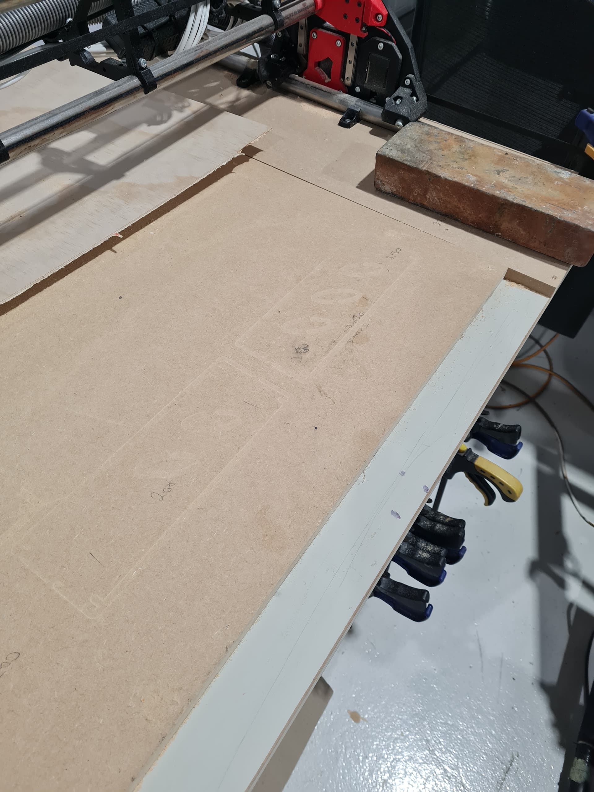

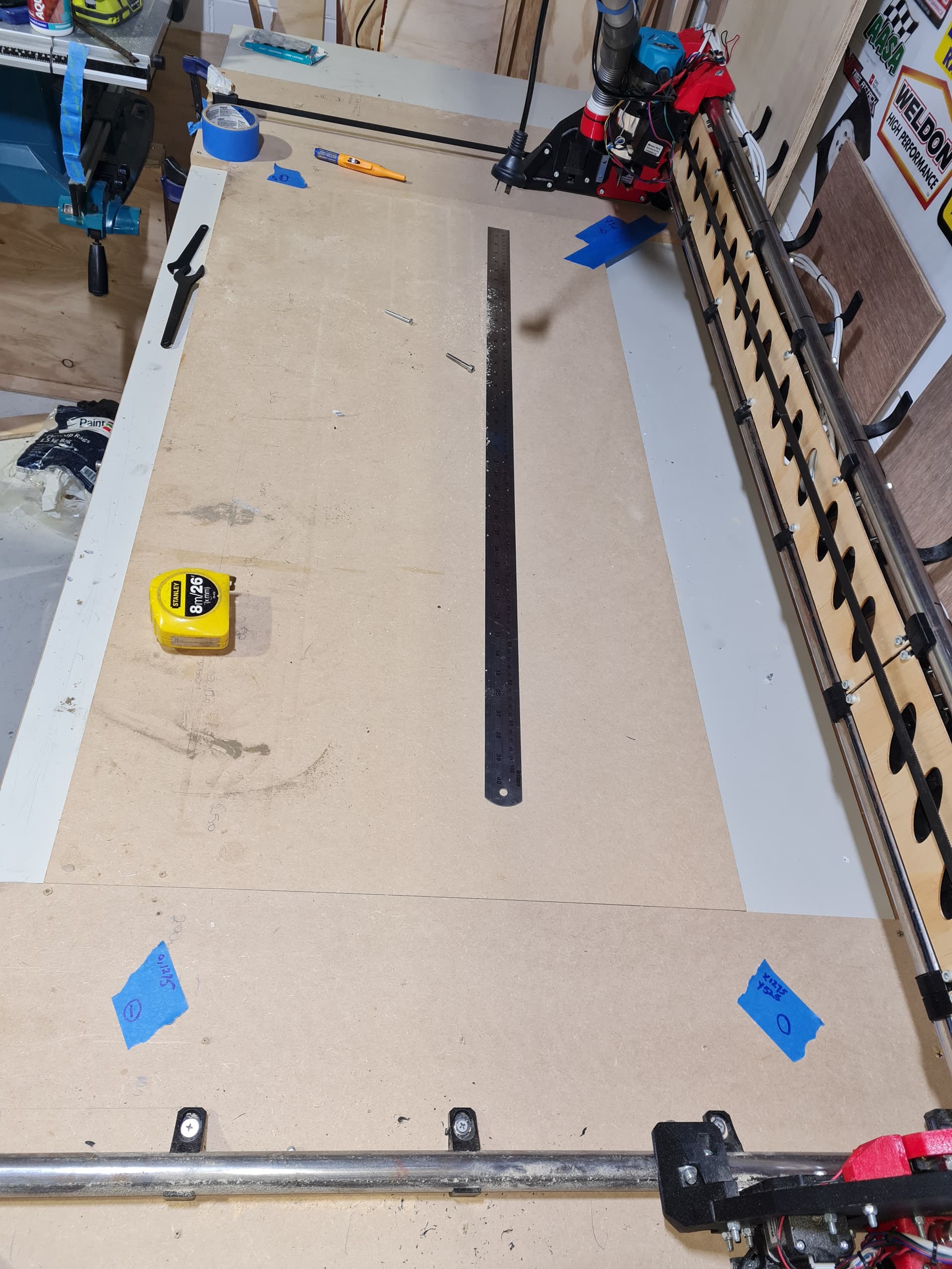

Ok, squaring.
I zipped past the workshop on the way home and marked the four points
And then measuring between them diagonally one is 1481 and the other measures 1478 (mm not lol, freedom munted units, bwhahahahahah)
So 3mm, i have not read that section on the guide yet, is that ok?

I think you can get it closer, just use M666 to dial that in. If you have a V bit that is a great way to pop some holes in some tape to realy realy dial it in easily. I made a little video about it a while back.
Yeah, thats actually how i did it!.
I think i watched a video, while i was supposed to be working, lol.
some tape on the waste board and then drive the Z down until marks the tape, the up and the same for all the rest.
So to be clear, that is 3mm before I adjust the with the M666 thingy, that i purely off the end stops.
I will have to read the section on this to see how to do that m666

Ok,
I read that part of the documentation, and i just need to clarfiy
How do you know to put what values where, so if
(you are standing in front of the machine with the gantry in front of you)
if 1481 is from 0,0 (bottom left) to top right
and
1479 is from bottom right to top left
Do you half it and add 1.5mm to say the RHS (y1) stepper using m666 and add -1.5 to Y?
That should be close. If M666 Y-1.5 doesn’t work, then it is Y1.5. I can’t remember which way it goes.

Anyways, for a little bit of down time, i ran the squaring test and dicked around with that for a couple hours, along with a little bit of prep for a mod to my door table for some storage for thr cnc.
(Keep in mind my limited space)
So manage to get the squareness to about 0.5mm not sure what that is in imperial.
