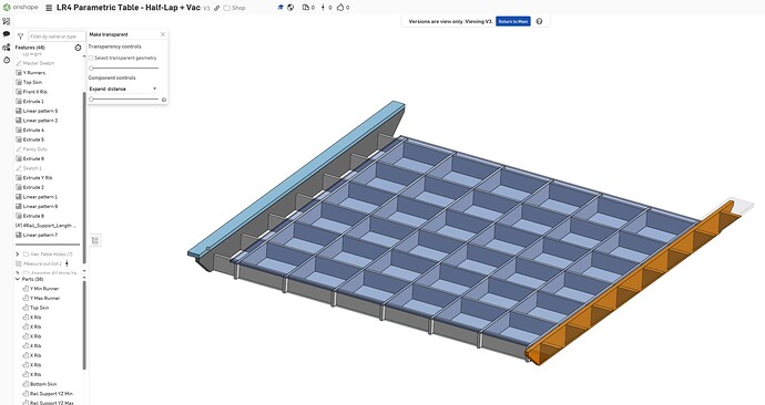

I have been mucking around with the Parametric Table(s) for my own preference on how to build a torsion box/table with what I have in my shop.
I wanted to use half-lap joinery for the torsion ribs, instead of all those screws and little pieces, and I have the capacity to cut my own parts, so don’t have to resort to MDF moldings. My gut says slicing up a 4x8 sheet of 9mm or 12mm MDF will be cheaper.
My plan is to rip all of those ribs, edges, rails, etc on my Sawstop, and then set up my router to cut the half-laps. Then slot them together, square, glue, screw, whatever to make the torsion box.
I’m also pondering implications of the Top Skin and the Spoilboard being two different things.
If you have the capacity, maybe this Onshape design will work for you.
I’m a bullet point kinda guy, so:
  • This is my first use of OnShape. Have mercy.
  • I did not modify the leg designs. I am strictly futzing around with the top. The old Leg stuff has been moved to a folder.
  • I am going to be experimenting with using vacuum power to hold the work down. Basically the idea will be to slap my material down, and rely on my dust collector to collect dust AND provide vacuum pressure (It’s a big 'un). So, there’s a folder for all those features. Just move the project pointer past that folder if you want to play with that. I’ll update with news of how it’s going.
  • Cleaned up the variable table and added new appropriate values for my changes. Removed vars that were obsolete. Added some for a few magic numbers I found.
  • Added the ability to add extra clearance/height to the rails, to allow for full use of Z axis range, or allow attachments that need to dip down lower.
  • Switched the drawing to metric. I find it easier to set my tools up for metric.
  • Changed the rail supports to use gussets.
Also considering using thin aluminum bar mortised into the rails for the “drive” lane to eliminate wear. Though I don’t know how much of an issue that would be. I wouldn’t be me if I didn’t overthink it.
Also wondering if there are issues with dust and debris interfering with the bearings. Air assist or vacuum/brush attachments?
I’m open to feedback, suggestions, comments, ideas. Though I can’t promise if/when I’ll get a chance to act on anything.
I’m sharing a link to my “V3” of this. If anyone knows how to keep one link that just goes to the latest version, I’m all ears. Otherwise I guess updates will mean new links to new versions.

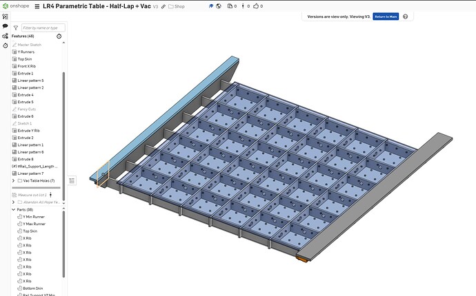

Here’s a snap of the vacuum version. This would require adding a port to attach the vac SOMEWHERE within the bounds of the torsion box (not modeled).

On that design that spoilboard needs a lot of sealing, specially on the edges and the inside, not to mention sealing around the structure and the under skin

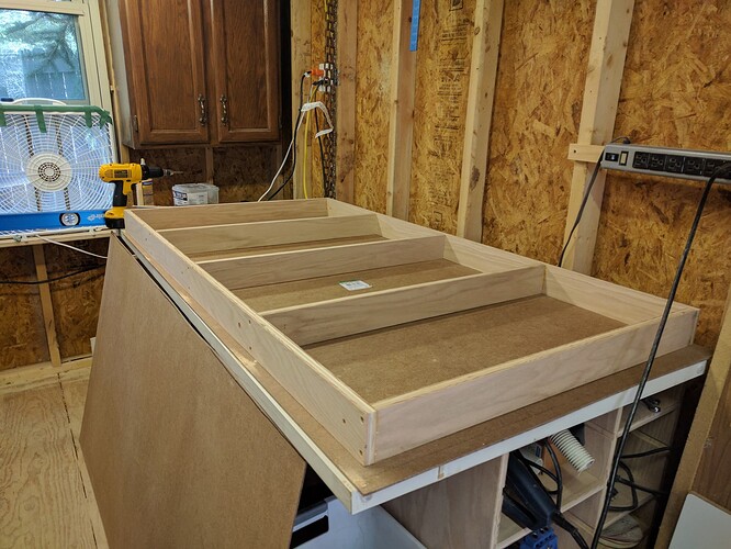

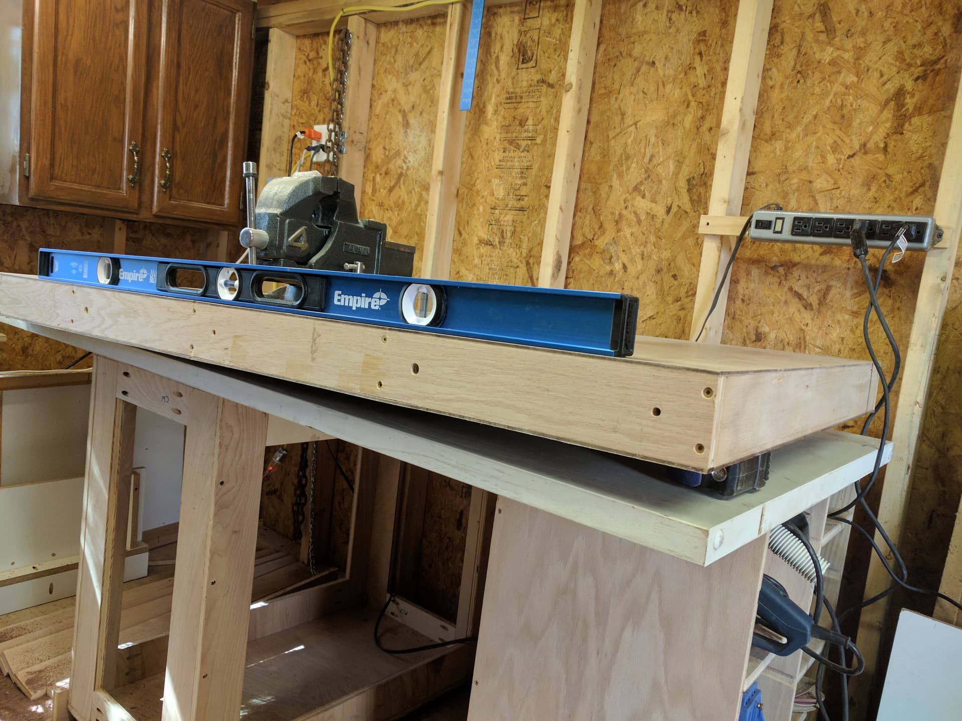

I also think this torsion box, along with most designs, have way more ribs than necessary. 15"-30" would be my starting point. Honestly. Check out this table top from new yankee workshop (about 7 mins in you can see the top):
I built a similarly dimensioned table (photos here).
One of those pictures has a 50lb vise in the middle, one end held up with a tape measure and the top is still dead flat to my straight edge.
This was from my LR1 build. The ribs were 32" long and 15" apart. They were closer in the X direction (not being flat in Y is less of an issue).
3/4" stock ribs and 1/8" top and bottom skin are very strong. Add another 3/4" spoil board so nothing punctures the top and you’re good to go.

I intend for mine to be fully sealed except for surface, and sectioned off to 4 chambers.

In my opinion it needs at least four entry points for the vac or it won’t get the air out well enough. There is also a lot of air that needs to get sucked out, dunno if that works.

On that design that spoilboard needs a lot of sealing, specially on the edges and the inside, not to mention sealing around the structure and the under skin.
The sealing comes for free as it’s intended to be glued together.
Yes, if this was still the screwed butt joints, you’d go crazy caulking. But using adhesives for assembly covers that step intrinsically.
Air pressure equalization between cells should be near instantaneous. The cell to cell hole size is configurable if there’s any concern.
My vac system does like 2000cfm. Shouldn’t take long. :grin:

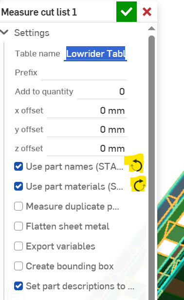

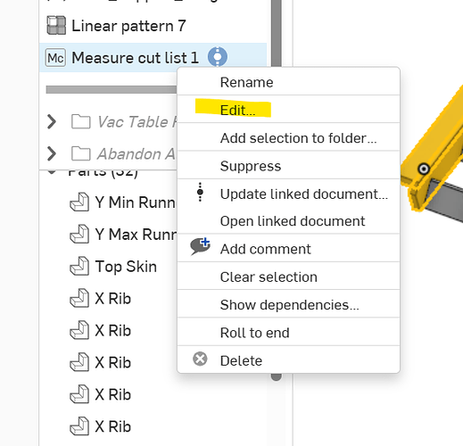

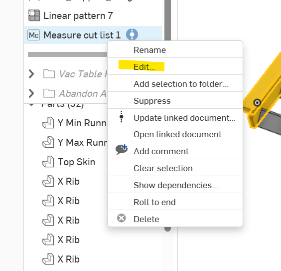

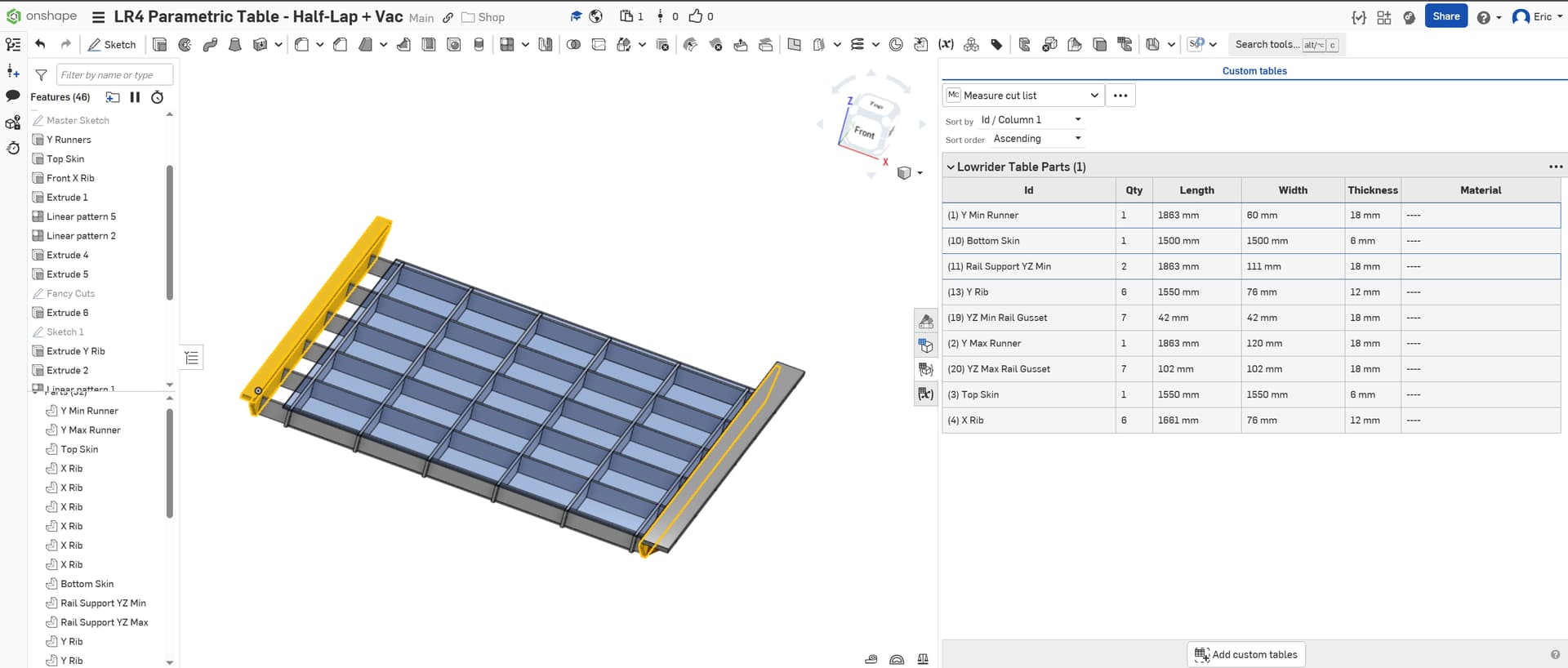

I set up the cut list table in my design.
It should stay in sync on measurements automagically, BUT if you rename a part, you’ll have to manually regen the table to get the names to update.
TO DO THIS:
Edit the cutlist…
Then click the circular arrows…
You should see the labels updated.
LR4 Parametric Table - Half-Lap + Vac Onshape

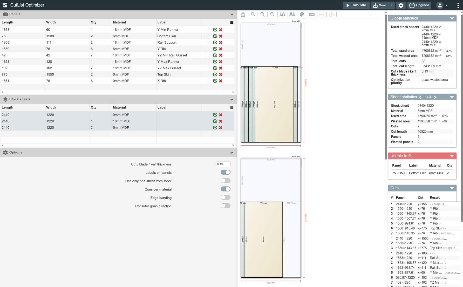

Side note, if you don’t know about https://www.cutlistoptimizer.com, it’ll make your life so easy and reduce material waste when cutting a bunch of parts from sheet goods (like torsion box rails!)
Put your available (or soon to be purchased) stock sheet info (Full or cutoffs) into the STOCK SHEETS table, and then your required cut info into the PANELS table. Click CALCULATE, and TADA!
It’ll let you account for edges, kerfs, and even grain orientation.
It’ll also generate a printable report/image you can take to the garage with you.
Note that my report says it couldn’t fit my bottom skin pieces because I didn’t give it enough stock. Since my skins accommodate 5’x5’ birch ply, I’ll have to muck around with segmented skins so I can cut them from 4x8 mdf/hardboard stock.
Hope this helps. I found it saves tons of time and waste when you’re building stuff like this with no CNC:

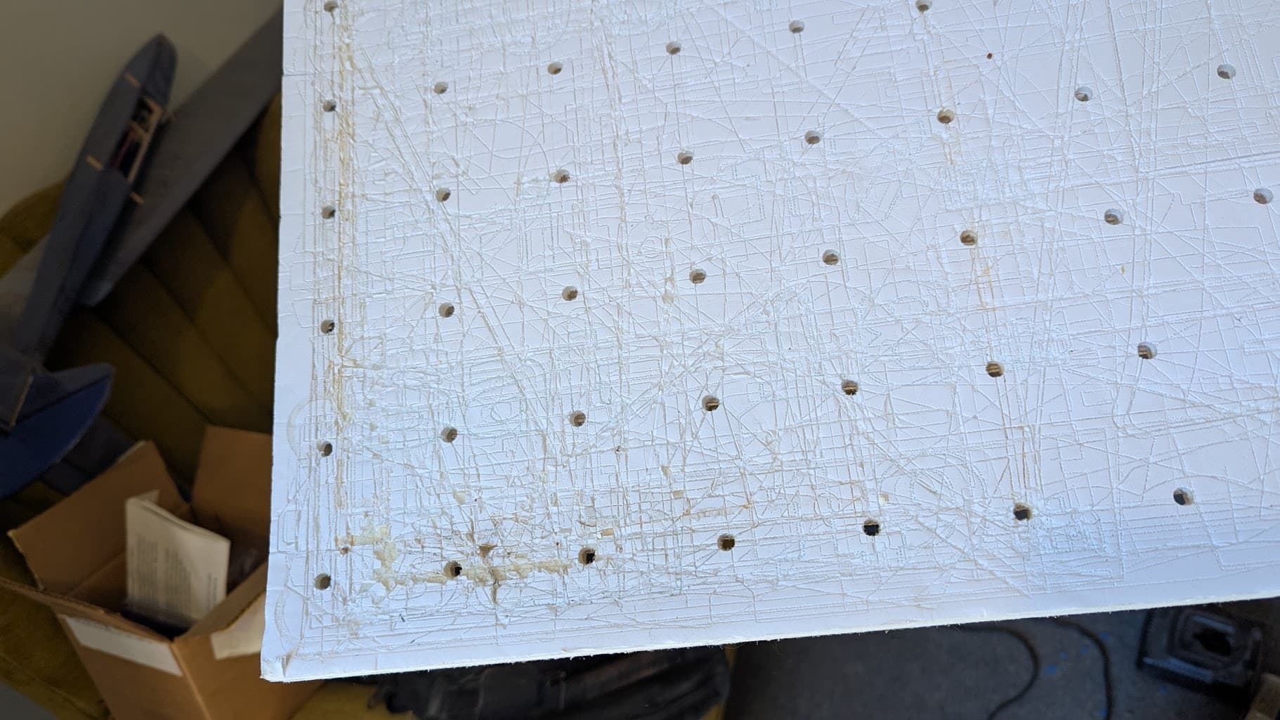

I had big plans for a vacuum table on my old MPCNC…then got talked into just doing a quick test with some sheets of foam from the dollar tree.
I wound up using 3 sheets of foam - one with a series of horizontal slots, one with a series of vertical slots, and one with a grid of holes over the intersections of the slots. Added a 3D printed plenum on the side and hooked up the smallest cheapest shopvac I found at walmart for $20.
Almost wasn’t worth drawing it up in onshape at the time but I did:
I just cut slits for the plenum with an xacto. I forget who designed the plenum but I see I had it in onShape as well: Onshape
Actually…just found in the description on the terrible video I did about the vac table that it was @moebeast who did the plenum which is here: Foam Ripper by moebeast - Thingiverse
Video is here - terribly edited (I hate editing video so leave in way more than I should) https://www.youtube.com/watch?v=tyKDV7OIQQs
I had originally planned on only using it for cutting foam and it worked great for that. But I found it also worked great for conventional milling as a “Vacuum pad” more than a “Vacuum table” Since the bottom slots were open to the table it would just suck itself down and hold position. I’d just put my work on top and then toss some sheets of paper over the holes that were still exposed.
I need to make a new one…tossed that one out in March when I started my LR4 because it was really wearing out:
So…point of this long ramble. I started out planning on building a big complex vacuum system into my table. Wound up making a quick proof of concept that cost me $3 and about an hour of effort (would be $3.75 now thanks to DT raising their prices) and found it worked so much better than I expected that I decided the big complex plans weren’t really necessary.
Oh - and just to be really annoying. I’ll finish by somewhat contradicting myself. MDF will leak vacuum like crazy…particle board will too…but…surprisingly not as bad as MDF. My table top I used this on was particle board and it never had any issues holding itself down. Though I did find using it to hold MDF was a lost cause unless you seal the MDF.

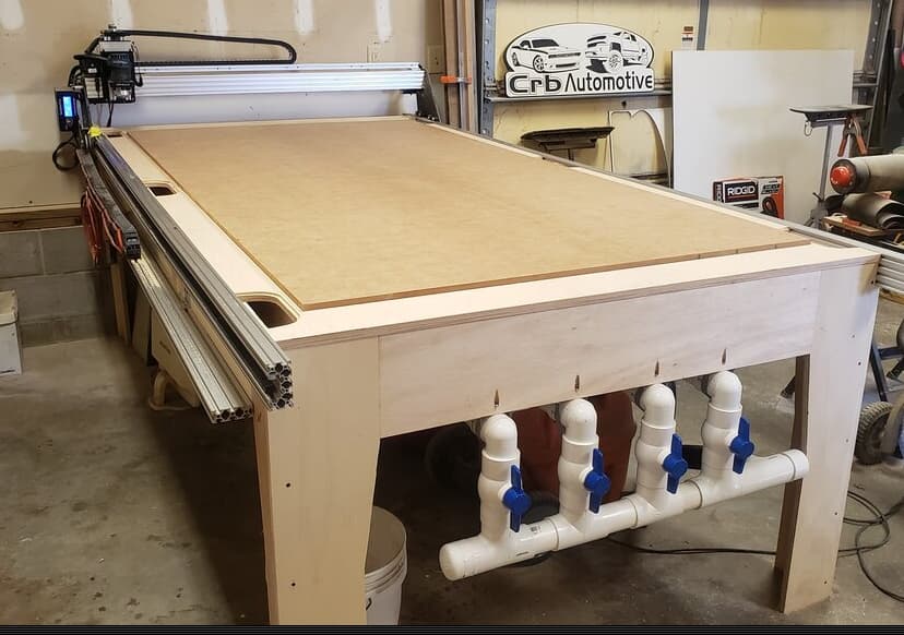

I toyed with the idea of valves or gates or sliders. Even something like this:
That’s gonna be a no from me, dawg.
At the cheapest, I can toss some tagboard down on the uncovered holes.
I am working on a CAD design for a 3D printed valve that goes in the holes that will open when the stock is placed on it. That way, only the covered holes will open. :crossed_fingers:
