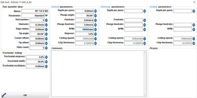

Iāve spent the last 2 hrs. trying to get the settings right for this V bit in aluminum. I donāt have the right one on hand. I need to get me one that has a blunt tip instead of the point. I have the numbers coming out good but the rest just looks like
Iām done messing with it for today but tomorrow Iām going to run it with just the V bit doing the numbers and use one of the 1/16th end mills from your store to just do a shallow pocket on the rest. Then Iām just drilling the holes not the slots for the bolts. First run screwed up this first section I tried so Iāve just been re running on it until i get the settings right. Then Iāll cut that spot out as one of the other 2 struts and use it on the bottom where no one will ever see it LOL. Did get a much better price on this Aluminum than the last piece I bought but its not quite 2āx4ā. I needed 43" for the struts and it measures at 45" lol. But for $50 that makes the 1/4" aluminum struts cheaper than 1/4" acrylic so thatās even better! Wish me luck tomorrow LOL. Hopefully ill have a good video to post of it cutting. Should be around a 2 hr time lapse LOL.
Yeah, I have not gotten that real good either. I tried a lot of things. I can chamfer perfectly, but not just V carve. If you can pocket at all first with an endmill, then finish with a vbit it would be fine.

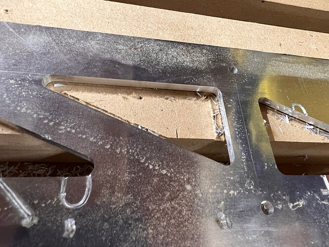

Front strut done. Hopefully the screws will clear. If not ill get flat head ones and countersink them on the drill press. Came out well overall. Had one problem spot Iām not real sure why it happenedā¦

Here are the bit settings I used. I did have to slow the speed on the screen to 50% for the V Bit though and the V bit is actually 2 flute. All I had on hand.

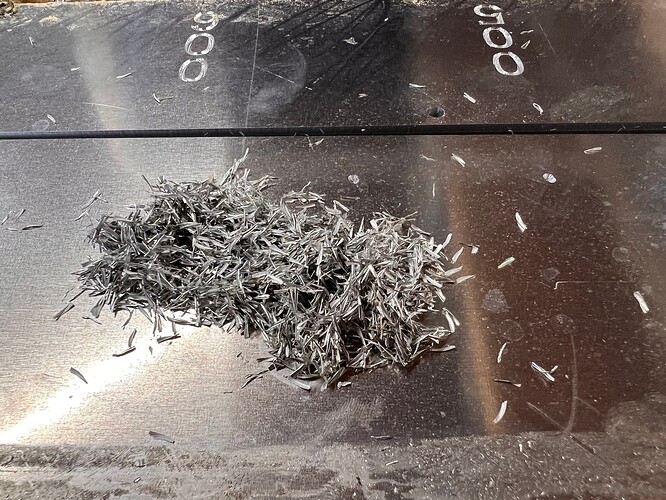

And a pic of the chips from the 1/8" doing the final part cut. I think it handled it very well and looks like a decent chip size for my inexperienced eyes.
Yes.
That cut looks pretty good! In the future you might want to choke up on that 1/16" a bit more. I canāt believe how fast you had it going through metal.

I went though before starting this second one and reset everything. My air was higher than i realized at 40psi. Reset to 25psi. Moved over to a clean section of plate and set the IPA to just barely a mist. So fine that when I started cutting I couldnāt tell if it was actually putting any out or not. But I touched the plate after it moved and it was cold as can be so I know its working. Also on my inside holes I set a .2 straight clean up pass on this one so we will see if that makes any difference in finish. On the first one when I look real close I can see the lines from the trochoidal milling on the inside pockets. donāt see them on the outside part though so no clean up pass there.
Edit⦠On second thought. Now that I see it I donāt think the clean up pass is needed these cuts are CLEANā¦

That one is looking CLEAN!!!
looking CLEAN!!!
I agree! Trying to decide if I should let it do the cleanup pass or skip it. I had to set it as a different bit to have it do a straight pass instead of Trochoidal so I have the option to stop it when it comes up to the bit change.
