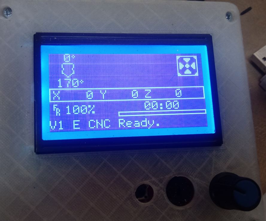

Hi All,
As you can guess from the attached image, I’m using RAMPS 1.4 with corresponding screen. That screen is awful. The menu is super-sluggish, I am simply afraid to hit the wrong file to “print” because the joystick not always moves menu item up/down and sometimes doesn’t show chosen item properly.

The RAMPs has a USB port on it. You can always plug in a computer, like a small/cheap raspberry pi, and get all the UI you could want. Jeffeb3 put together the v1pi raspberry pi image for a quick and easy setup for mpcnc. With a computer (pi) you can use a full keyboard/mouse, or a touchscreen. (I’m not actually sure if pi specifically has touchscreen support, need to look into that). You can even figure out how to attach a play station controller to control the machine.

Sounds to me like your LCD refresh rate is set to low in the firmware. I saw the same problem once on my machine. It was solved with firmware. I suggest you just reflash with one of Ryan’s firmware copies. It will probably solve the problem.

To elaborate a little more on my experience. I have a Lulzbot Taz 5 at work. It runs the exact same LCD display but the control board is a Rambo 1.4 I believe. Great quality machine all around. On an early version of the firmware the LCD was great, quick and responsive. Later I re-flashed the firmware during a dual extruder upgrade. That version of the Marlin firmware was 1.1.8. They had set some of those settings wrong. I could look at a list of files to print and it would take nearly 3 seconds between each twist click of the wheel to select the next file. I accidentally printed so many of the wrong files it was stupid. A later Firmware upgrade fixed the problem.
I have seen some settings in the configuration_adv.h (It think) that have to do with LCD refresh speeds etc. It may be those settings but I am not sure.
I have used another SD and it worked faster. I guess it’s because of amount of files on SD (this one had less unnecessary crap on it).
But really, this default LCD is so bad. You have to navigate 2 levels deep just to do X home action. Then do some menu navigation to make Y home. Then 3 levels up and 1 level down to exercise custom script for Z homing. If you want to just move - you have to navigate several levels for EACH axis. It’s SO inconvenient.

As for the menus there are all sorts of things built into marlin’s basic config’s now, light menus, basic menus, prusa menus, custom menus, and even do it yourself menus. If you want speed and fancy try V1Pi, I have no issues with the LCD as is,I just hit play on my file, If I ever wanted more using V1Pi has two different controls built in (options for others) and it is wireless on a touch screen, nothing better.

The new firmware has a confirm built in to the LCD to prevent this, along with stop ( used to hit pause and lose jobs).
