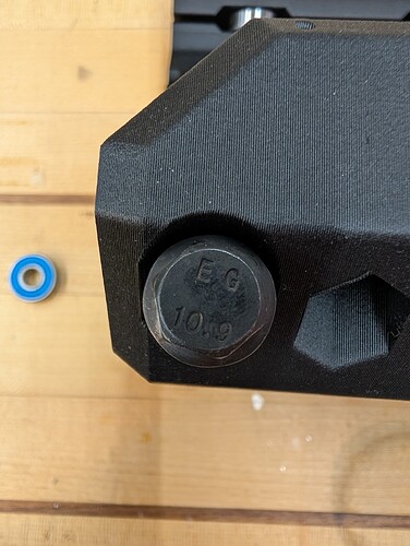

Bit of an issue with the hidden nut today, it slipped while tightening it up, and because it’s hidden had to saw the wheel piece apart to get it out! Gah!
The other side seemed okay when I tested it not blind, but will make sure there’s no play in it next time. Measured the nut to be 7.8, and the spot for the nut looked to be about 7.95.
Hmmmmmm. That is the second time we have heard that.
I will start with changing the instructions to make sure that screw and nut gets pre-threaded beforehand to make sure it is not super tight. If it keeps happening, I can do a re-design.
