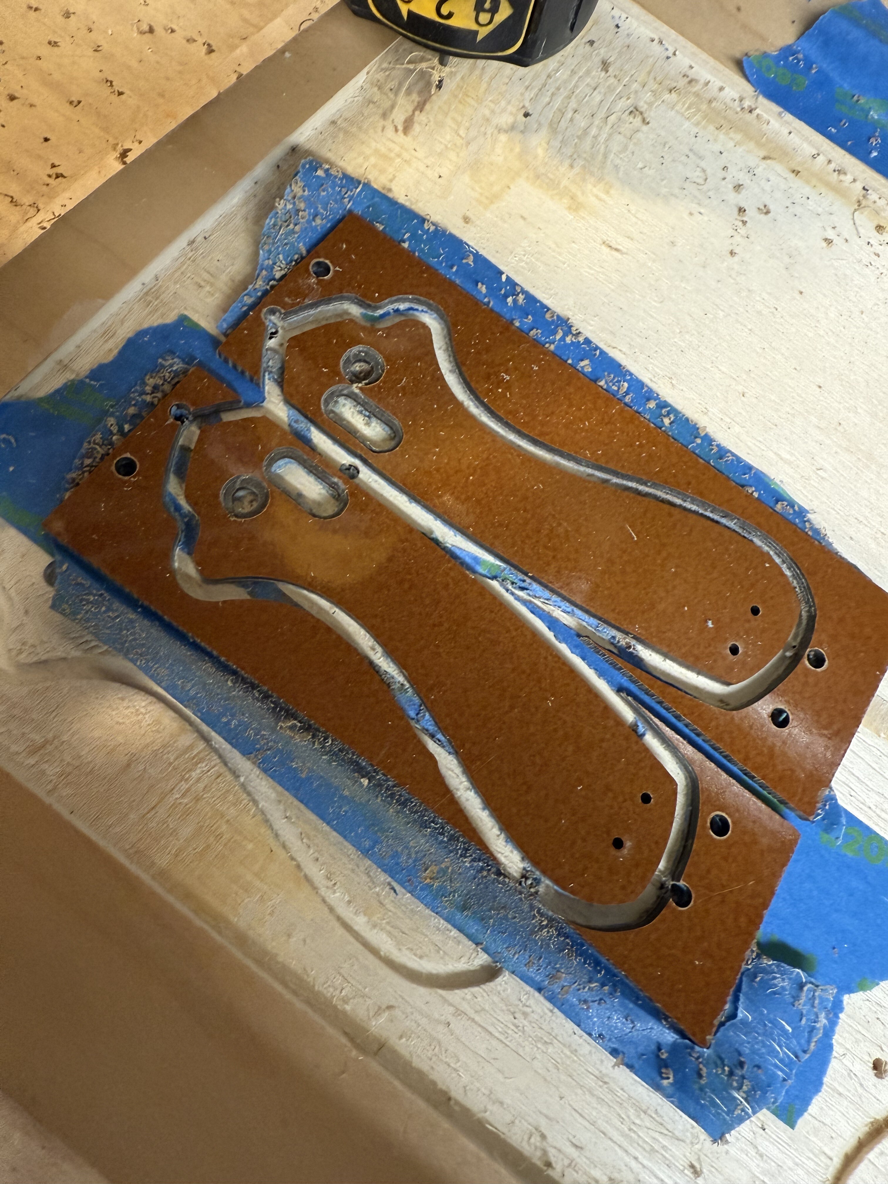

I have been using my burly MPCNC to cut scales for my folding knife, se pic below for an idea, roughly 33c103 mm. before my more recent end stop mod, I would check the squareness with the skew calculator or any other test and I appeared to be accurate within what I could measure with my cheap digital calipers. I redesigned endstops to bolt to the tubing, much like the primo build and just ran my first test. I drilled 4 holes at the corners of a 100 x 100 mm square. sr image below for my measurements from the inside and outsides of each hole.
250312-1pm test square results
I learned in R&D, 1 hr in the library can save 3 days in the lab. you guys are my library. before I mess with any settings, I was hoping to get the experts opinions.
right now I mill the pockets on the underside of the scales and cut the profile. I would love to be able to flip the scales over and mill features into the show face. chamfer the edges, recesses for the screws, ect.
ANY other suggestions for improving performance? should I run this square test three times and compare those results? in the past, I had to oversize the pocket clip screw holes to makeup for some sort of skew, as well as oversizing the exterior and grinding to match the titanium liners.

thanks. I have already been cutting knife scales on this machine, operationally, I am comfortable. as far as tuning, today I repeated the same squares cuts offsetting them from each other. basically, cut a square. home the machine, move to 10,10, zero the x and y and cut again. repeat. my diagonals are either right on or within 0.4 mm of each other. I think it’s time to move on. thanks

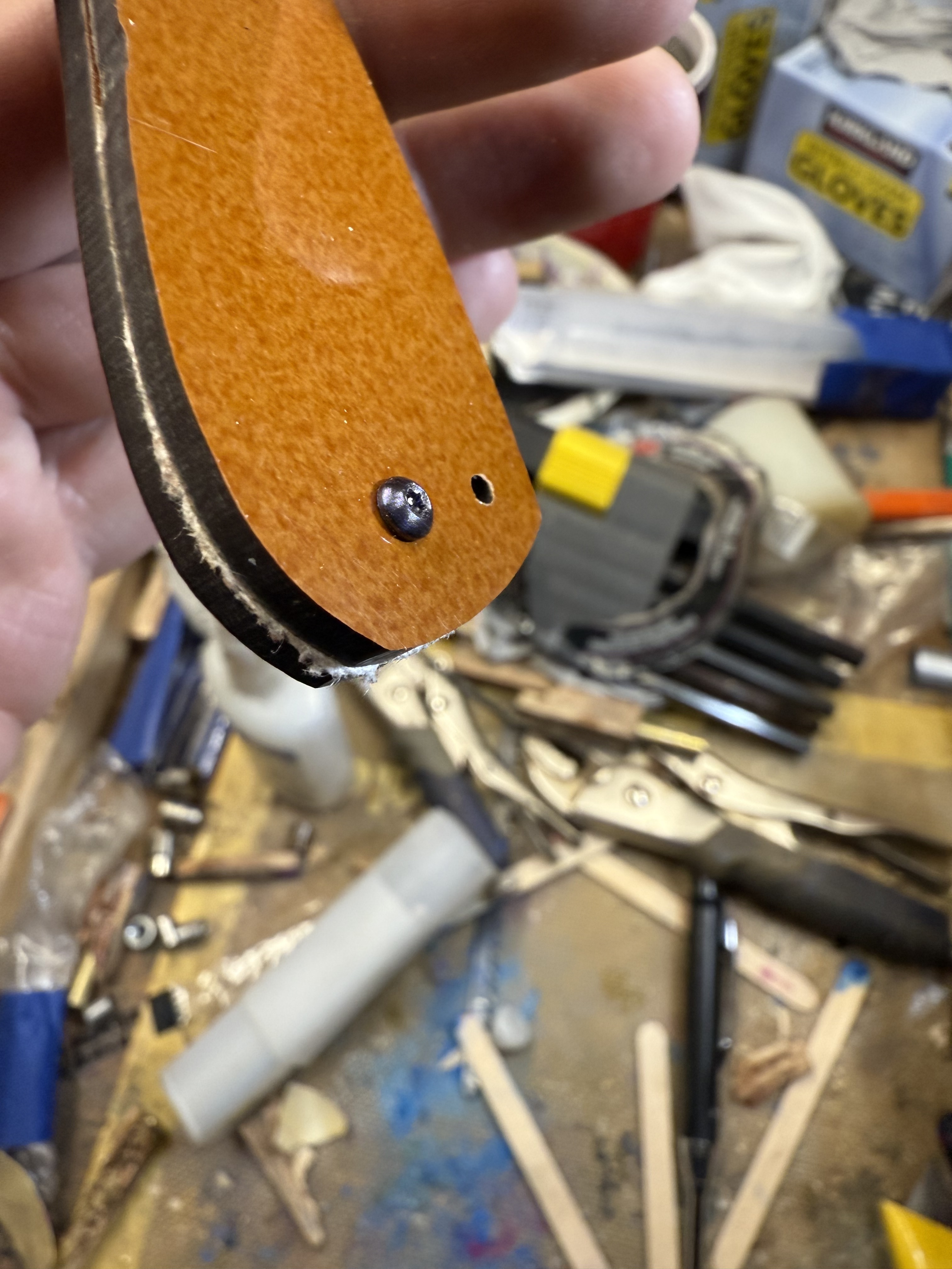

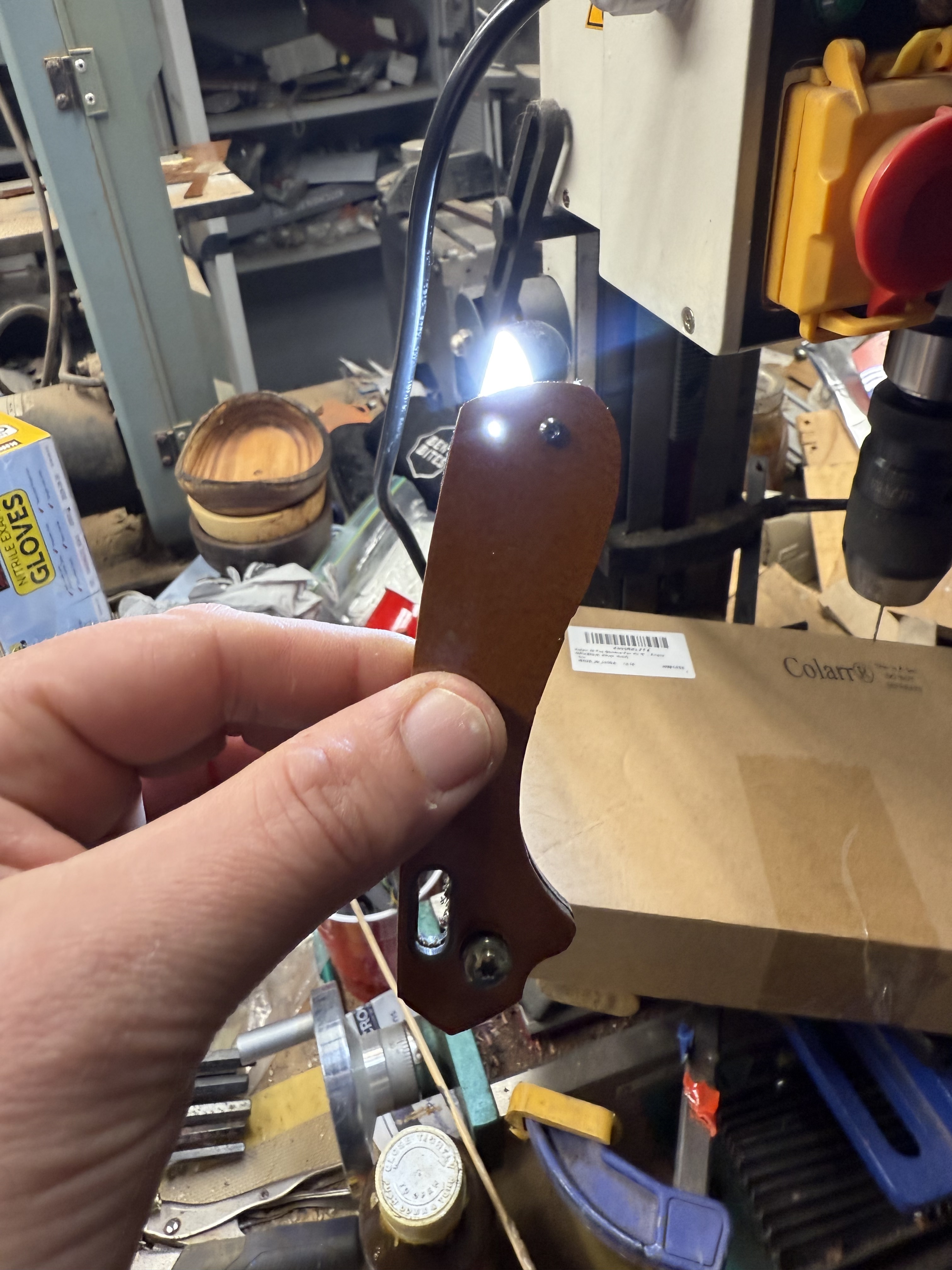

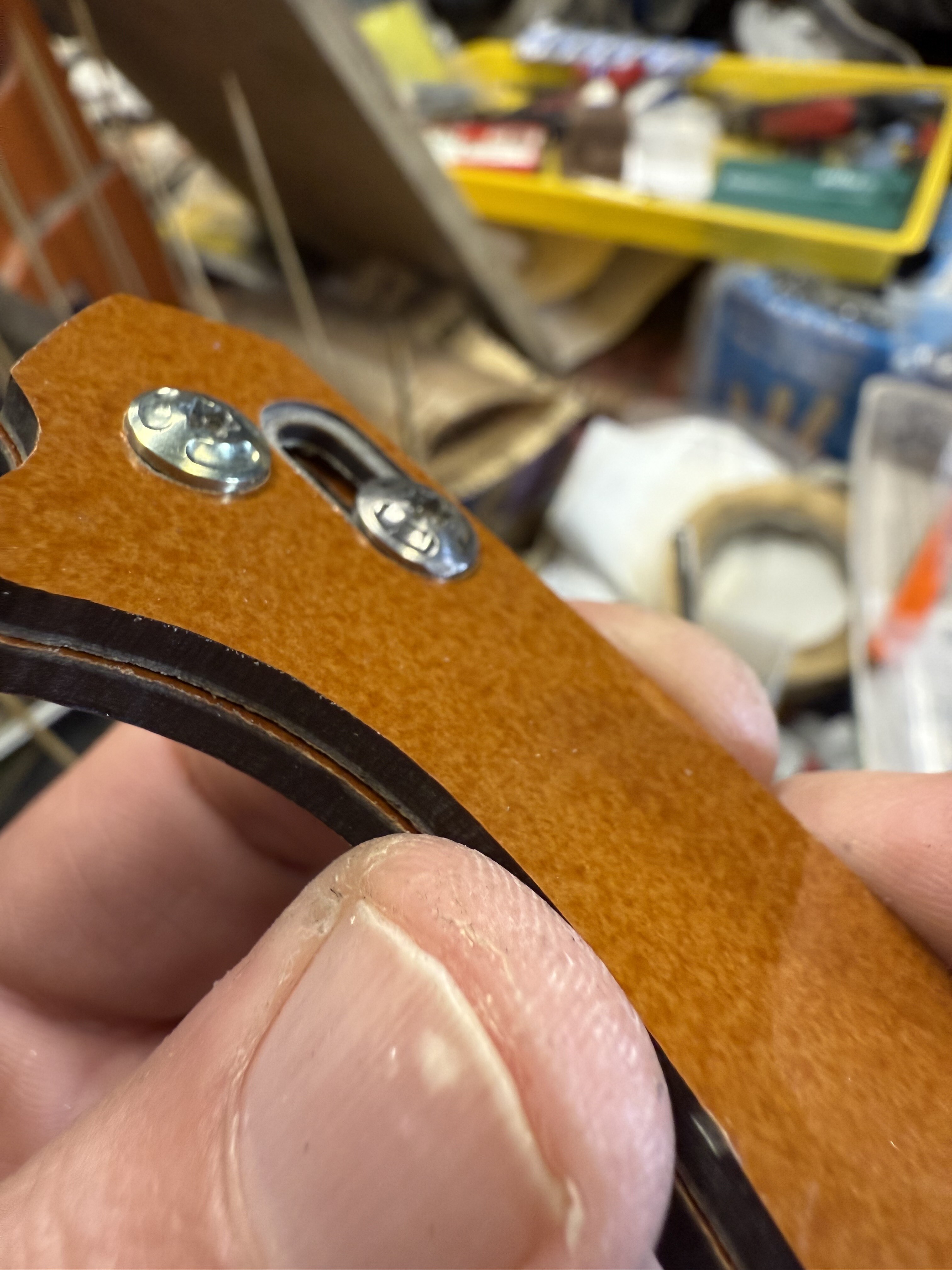

Well, I am finally back after trying the newly squared MPCNC. I was able to mill a pocket and alignment pins in one face, then flip the scales over and mill features I the other size. I was able to align three holes better than I was able to align them before. This is great!
