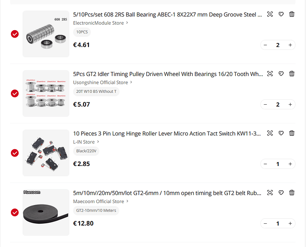

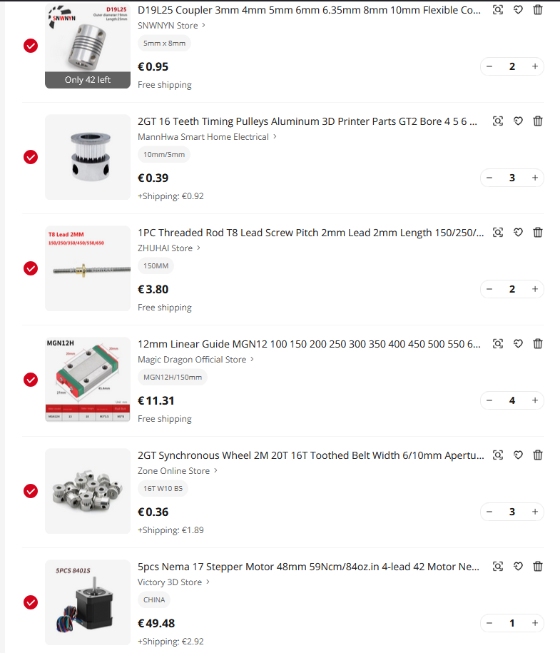

Hi comunity , Im planning on building LR4 , but im in europe and full hw kit shipped from US would cost arm and leg , so only reasonable source is aliexpress, im trying for now at least motion system , im showing you my cart and you tell me if its all right or something missing or wrong , thanks !
Hello Marek, shipping is expensive, yes, but you need to order the aluminium plates and board from Ryan anyway, which, in the end, offsets the cost. Also, Ryan basically exclusively has the cable extensions you need as well as the pre-programmed and tested ESP32 and the 1/8 Makita collet.
So all in all it’s not too bad. :slightly_smiling_face:
The biggest thing I see there is that you have chosen pulleys idlers and belt that are 6mm width. The 10mm width is what the specification is, 6mm can still be built, but the idlers are all going to be loose in their places without extra washers to center them, 10mm hardware isn’t much more, and will have a much better result with the printed pieces.

thanks for reply , if you look a bit closely next to the item image you can see that i selected 10mm with idlers, belts,etc. , they just have lots of options, and yes , im planning to use printed plates to get me running , its an open project i still dont know if its gona work lol

Oh it will work. If you can get high tolerance printed parts and and the correct hardware, it will come together faster, but with your skills, it will work. Bootstrapping off of printed xz plates is a reasonable approach. To get the full cutting power you will be wise to prioritize that metal part fabrication.
I also noticed the belt and pulley size, but it looks like you have that sorted. I would up the t8 threaded rod to 175 or 200 mm so twist handles can be printed and added. This is optional, but something that helps a lot with initial setup positioning. Once it is homing, you shouldn’t need them. With the 150 mm threaded rod length. Those tist handles will shorten the z travel a bit.
Don’t forget the m5x30 and m3x10 bolts and the M5 nylon lock washers.

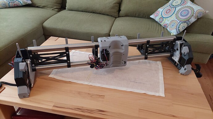

Uploading: 20241219_110159 LR4 Peter.jpg…
Hello Orob,
this will be my LR4, if I have questions about the software, may I contact you?
Thank you and greetings from Austria :slight_smile:
@digitalus / Peter, welcome!! I would be happy to help out. Just tag me with @ and my user name when you want to ask me a specific question in your thread. It is polite to start your own new thread to discuss it. There are others who are more experienced who might join in as well with helpful input and those who are in a similar learning position that would like to observe and learn or contribute.
This is Hibo’s thread about his LR4 and your photo didn’t finish uploading, so I’ve made a new thread for your discussion here.
