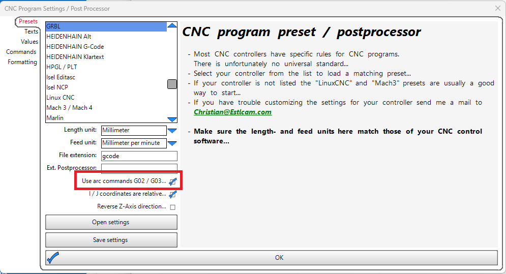

  7. What happens if you try this file without arcs (G2/G3)? In Estlcam, go to Setup → CNC programs / “post processor”. Uncheck “Use arc commands” and regenerate your gcode.

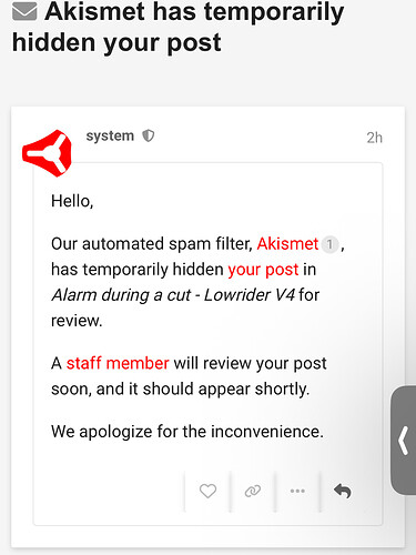

@vicious1 There was a post here today that disappeared. I saw it earlier then it was gone. Where did it go?
That post was mine. It had a google drive link in it, so I think it was removed by a spam bot maybe?
Yup, just found this message.
Drive Link

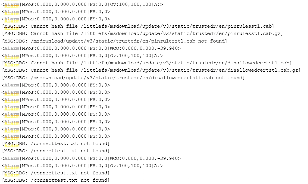

I booted up my machine this morning and it didn’t have an alarm. But once I tried to home it, it made it part of the way through the process before alarming out. The included link has the terminal output with Debug messages.
Hopefully this post doesn’t get removed!

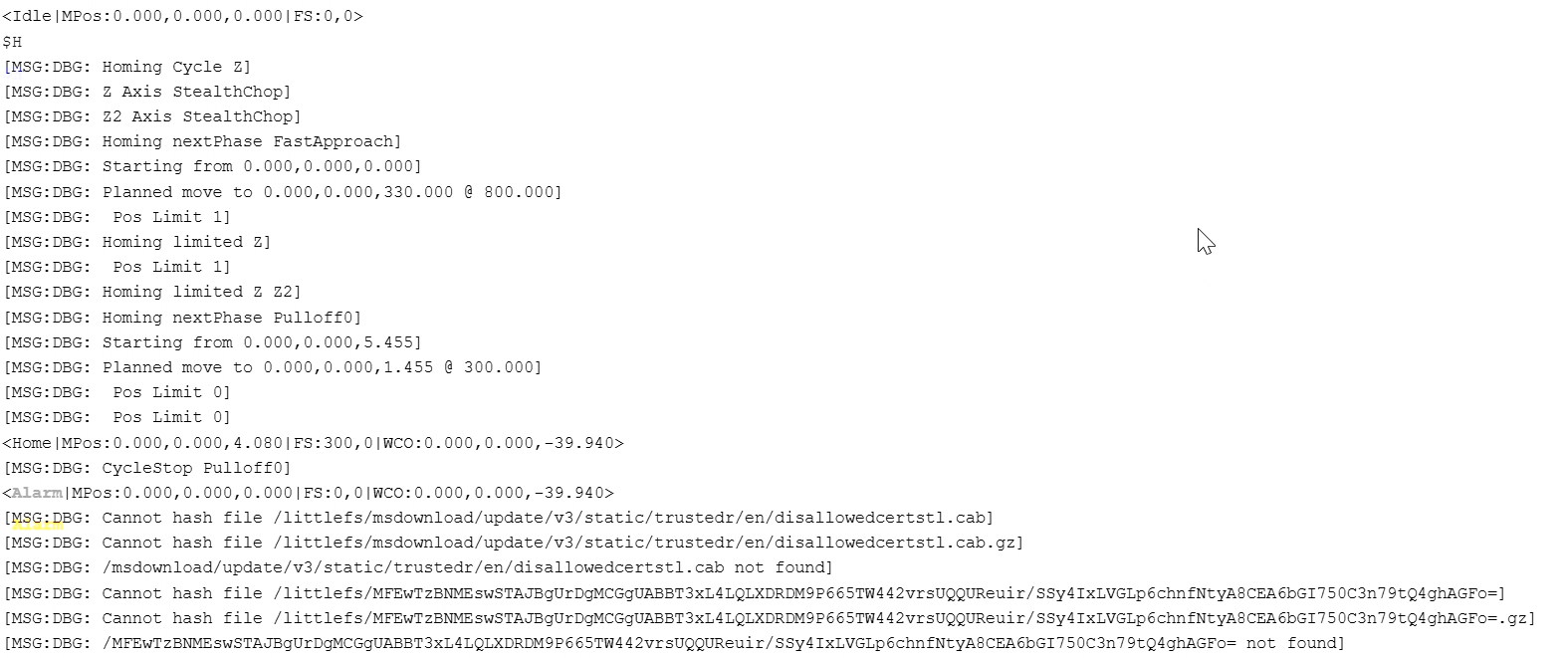

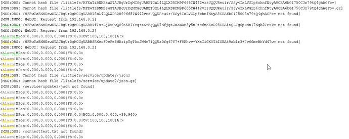

Here are some screenshots of the relevant terminal messages in the meantime. This is what happened during homing, shortly after turning my machine on.
What the heck is all that??? None of that is normal.
Let’s see if Jason agrees but I think you need a full erase and reflash. That is bizarre that it is looking for files like that.
