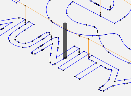

This is the line that is triggering the soft limit:
G02 Y92.5976 I-939.3639 J0.1212 F1800
G2/G3 are arcs. That’s a huge “I” value which is the X offset. I can at least rationalize how that might trigger the X soft limit.
I loaded the gcode in a viewer, and I think there are issues with the source file you are generating the gcode from, unless Estlcam did something weird. Where that line is should just be basically a straight line. It’s in the straight part of a letter N. I think that G02 line is telling it to draw a tiny arc for a massive circle.
This is probably technically a FluidNC bug, but I think if you clean up the source image, it will work. I’m not entirely sure I’d call this a bug since it’s asking it to do something kind of crazy.

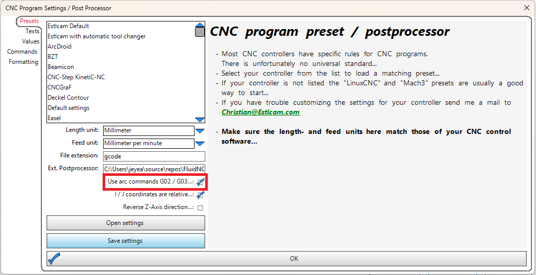

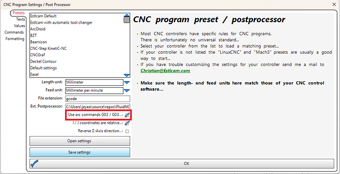

As a workaround, you could also disable G02/G03 commands in Estlcam so it renders arcs as tiny lines.
