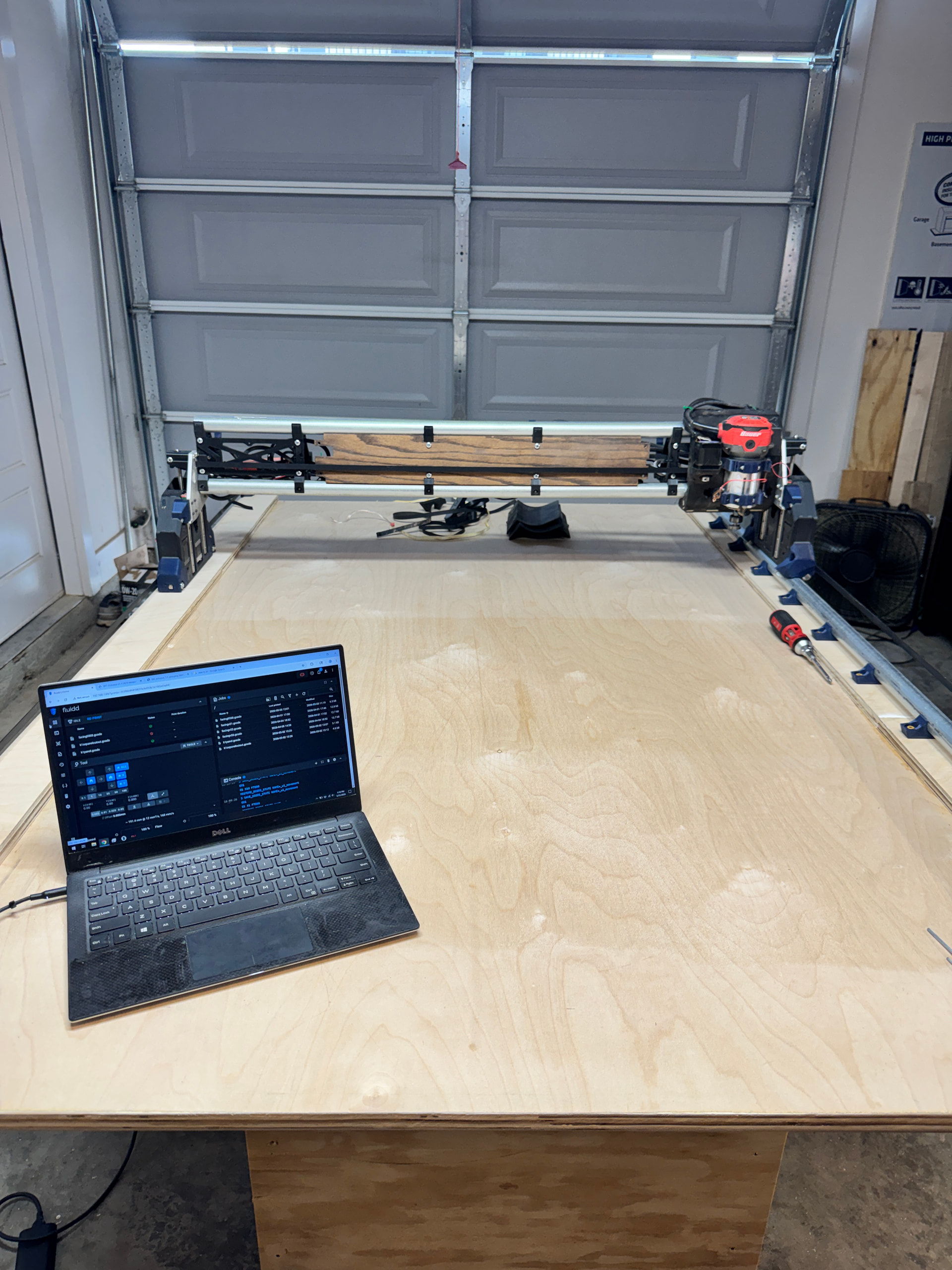

Previously, I had my LR4 in an enclosure with a working area of around 18in x 28in. Which was fine, but I am now going to be doing a lot of bigger plywood projects where a larger build area would be beneficial. So this time I opted to build my LR4 on a 4x8 sheet of plywood. I cut it down from 96in to 72in so that it would fit between my garage shelving units nicely when stored away. This gives a build area of around 36in x 60in which should be much nicer than before.

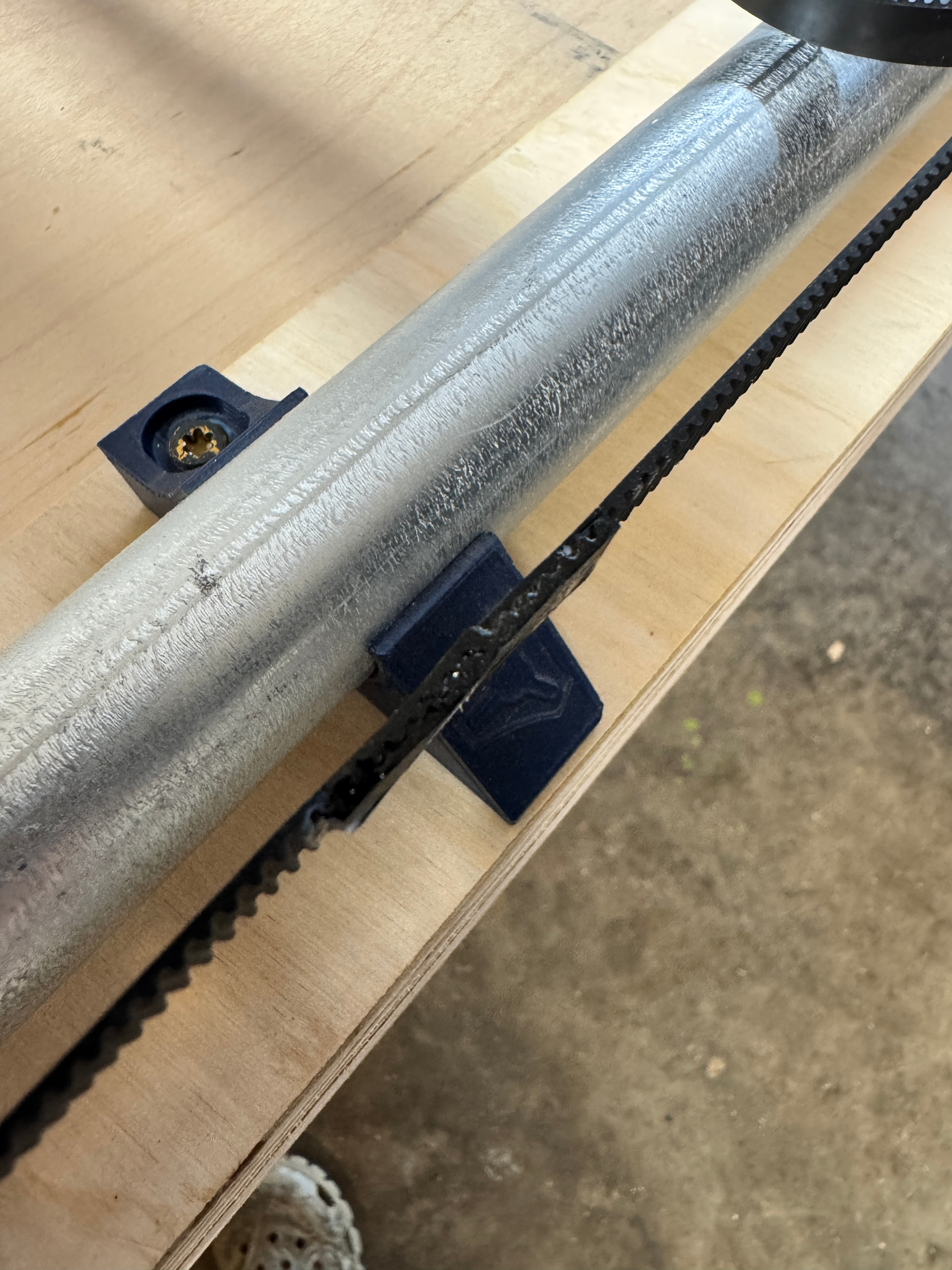

I purchased some “nicer” plywood for this, rather than the normal big box store stuff, and let me say it is much better to work with, and much better quality, than anything else I have used. I reused my old strut plates in the middle simply because I had them, but mainly to act as a holder for the controller board and power supply on the backside. I also did not have long enough belts for the y axis on both side, so I had to glue two belts together using an offcut.
I do not plan to actually perform any cuts with the belts like this, but really only did it so that I could at least get the machine up and running. It is surprisingly strong, but obviously it would not fit through the pulleys, so my build area is greatly diminished.
